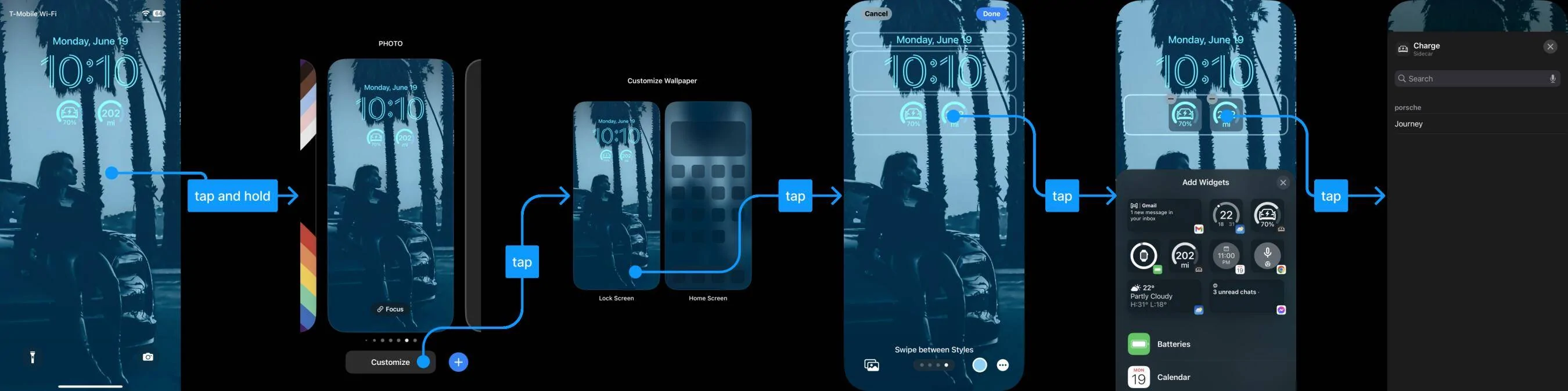

v1.2 is now available on TestFlight with a fixed authentication flow! The app's also been rewritten from the ground up to make more efficient use of network calls and improve app latency.
Let me know if you see any rough edges! It might force you to log in again on both the watch and phone, but ideally it should auto-migrate you to the new flow.
If you have multiple Porsches, the "default vehicle" feature hasn't been reimplemented yet so in the meantime you'll have to use Apple's flow for customizing widgets. As far as I know you can only do this on iOS though; for your watch it will resort to selecting a semi-random vehicle from your garage (though it should remember your previous setting if you'd made one). I'm planning on fixing this in the next build.
