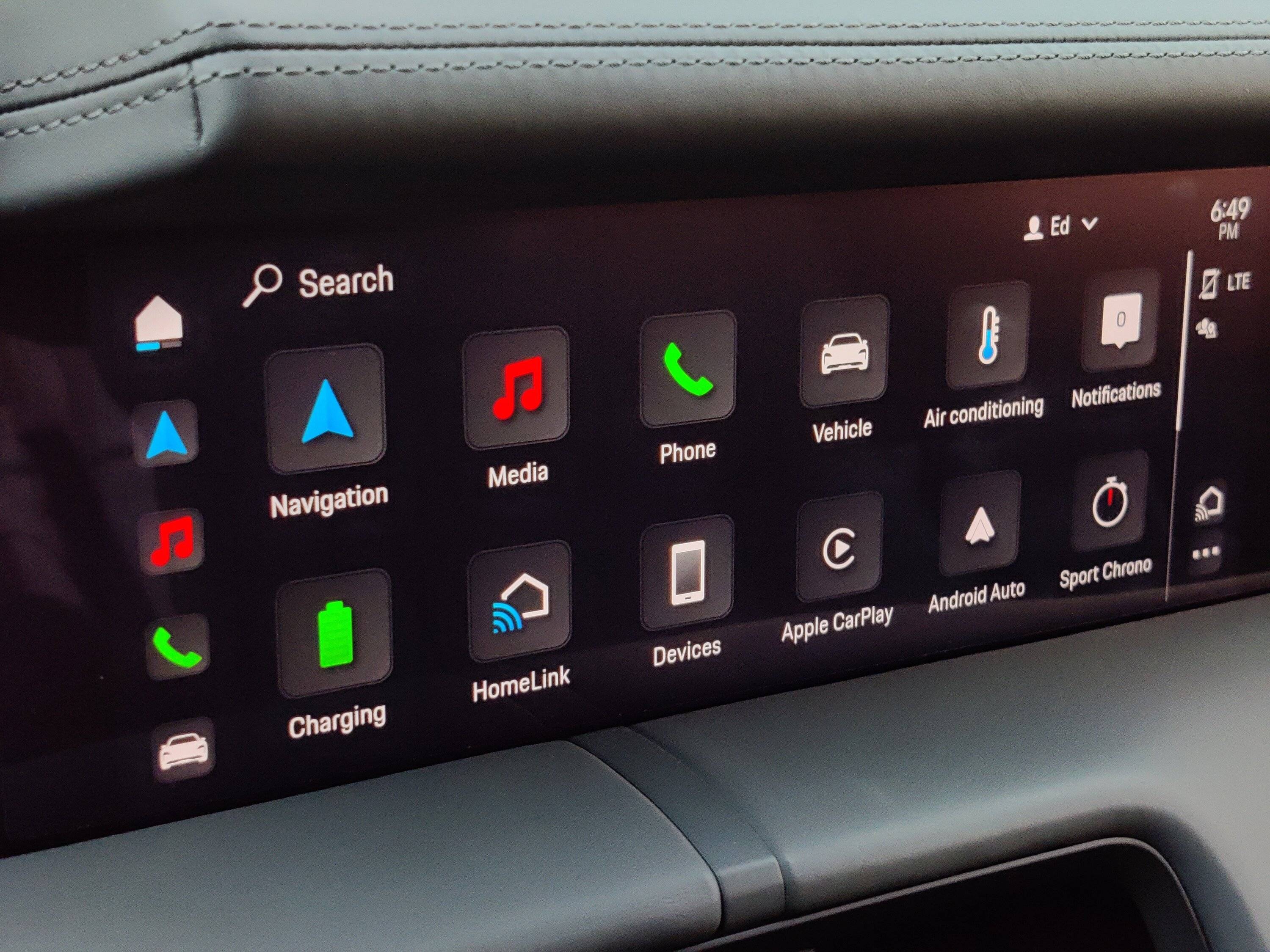

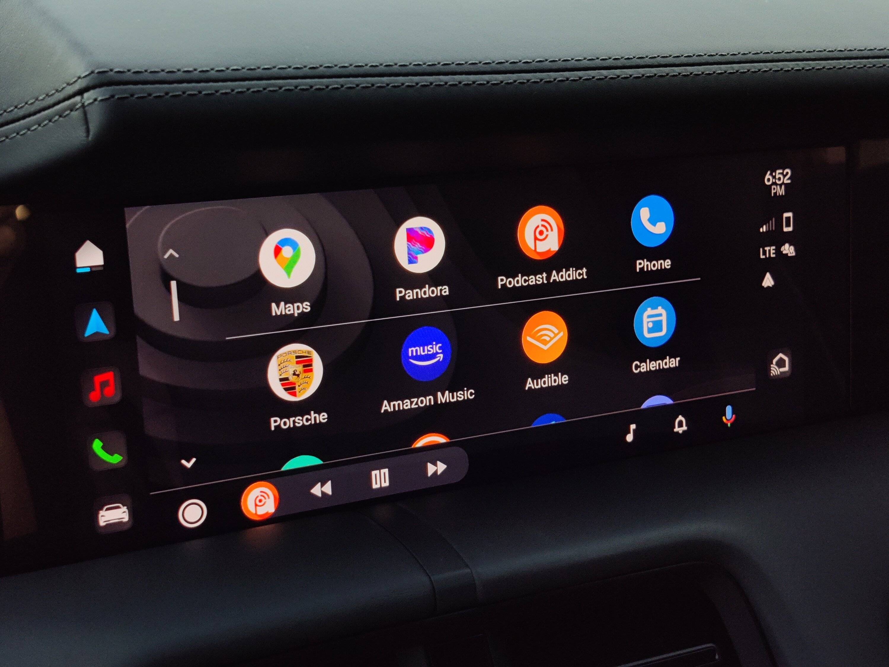

Got my car back from the ANA6 update on Thurs, so far so good. Aside from re-pairing my phone to enable wireless Android Auto, none of my settings appear to have lost and my car arrived to me normal, not in Privacy Mode
