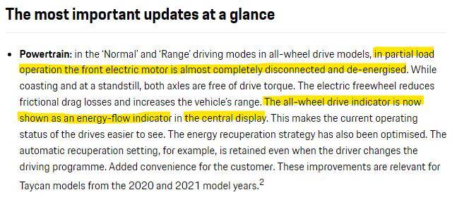

My latest observations of uPdate now include the completely different behaviour of Range Drive mode (4S, PB+).
It now appears that the rear motor is used predominantly rather than the front motor (historically been this way for the past 2 years). Logic previously was that the front motor was smaller and therefore used less energy.
Briefly notice front and rear motor engaging when on the level before reverting to rear motor.
With cruise active and when descending a gradient the rear motor would engage to brake / maintain speed and then revert to predominantly front motor for inclines - this doesn't appear to be the case now (will review again on Monday when I'm heading back north in case I missed it).
Anyone else observed this?
Both motors are physically shutdown when coasting - previously the AWD display showed energy flows to both motors - I was expecting this as it was stated in the release notes.

It was announced quite a while ago that the new efficiency developments for '22 models had resulted in range mode using the rear motor most rather than the front.
I was surprised at the time but there are complex interactions at play.
Yep I guess but it is frustrating given the elapsed time and 'learning' during that period of how this feature worked to now abandon that knowledge and re-learn.
There ought to have been more details published and shared at the point of customers receiving the uPdates IMHO along with a QA exercise to provide assurance that all features (new and updated) were actually working (I've uncovered 3 issues now which worked just fine since day 1 and now broken).

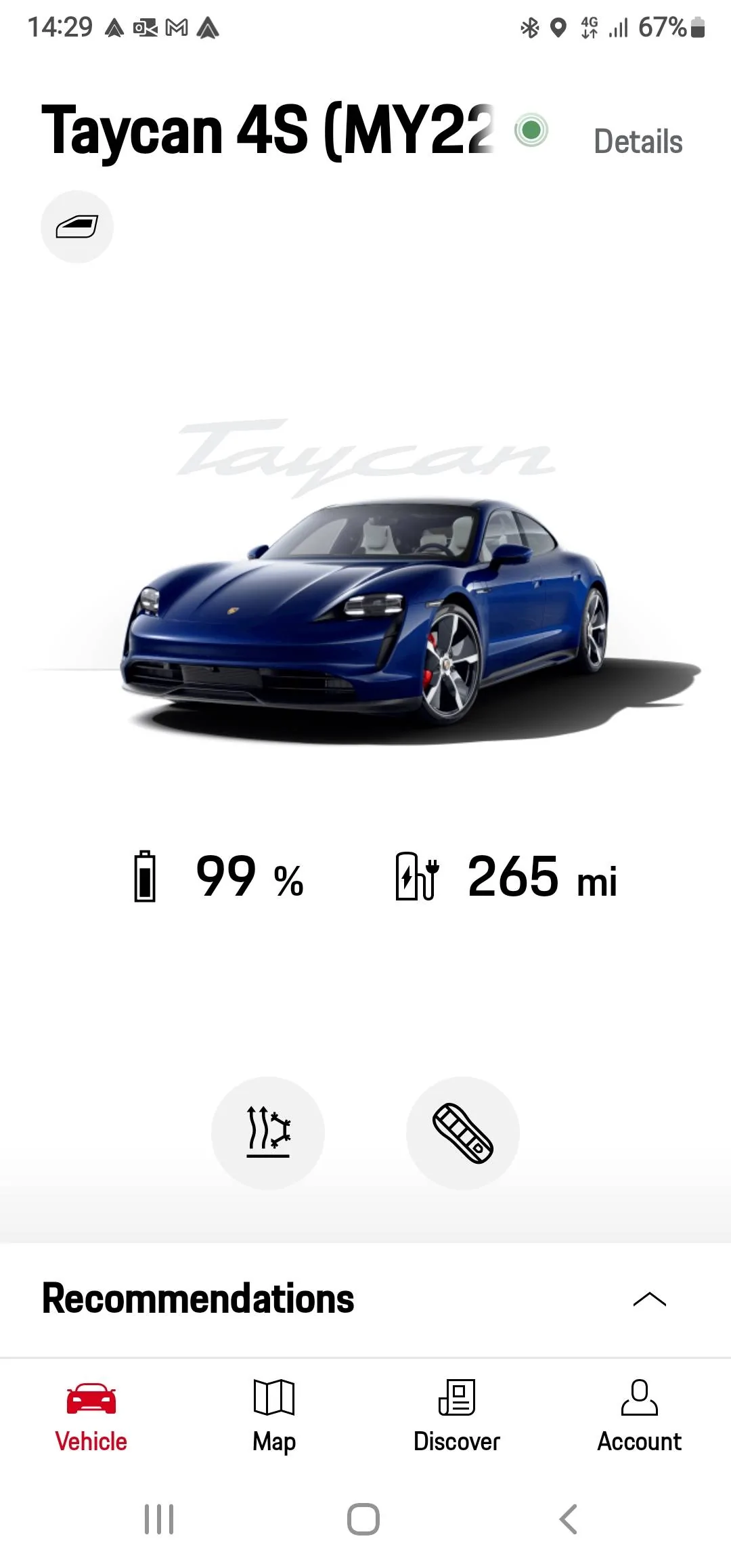

Interesting...me previous MY21 RWD only ever max of about 240-250 miles. Last charge just before going back end of July. Currently my 4S showing good amd much better range...however maybe due to longer, gentle touring, trips taken since delivery and predicted range based on that?
Porsche Taycan Latest Taycan Software Update Findings and Reviews Thread Screenshot_20220916-142915_My Porsch
11,049
6,835
I don't think there would be a correlation and remember the estimate here is simply that, an 'estimate'.
Longer trips help with consumption as per an ICE vehicle.
Of more relevance is your average consumption. I'm still at 3.3 miles / kWh which my current reduced range contradicts (would indicate increased consumption).
If you have an MY22 car with the latest updates then that could account for the estimated range increase. That said, check your consumption data to see what you typically get for each mi/kWh.

Hi. Showing as attached
Porsche Taycan Latest Taycan Software Update Findings and Reviews Thread Screenshot_20220918-152205_My Porsch
