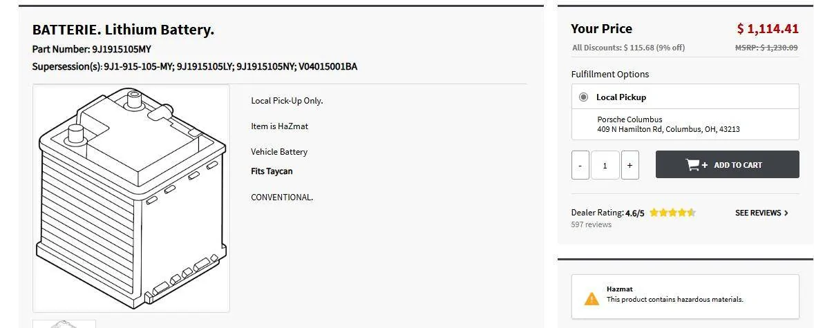

Base on what I am reading on forums, Porsche has a 4 year warranty on the 12V if the vehicle is under 50,000 miles. However, they also will try to void the warranty if you do not drive a specific amount of miles (base on Reddit posts), so beware. The poster on Reddit stared the labor and part numbers as follows:
Job # A Labor Total: $ 1,245.00
Cause:
Correction (s):
EL10 REPLACE BATTERY $1,245.00
Tech Number: 856 Labor Type: CP
Part Number Part Description Qty List
Parts Total: $ 1,952.52
9J1-915-105-NY LITHIUM
BATTERY
1 $ 1,952.52 $ 1,952.52
12176 REPLACED 12V BATTERY 500
REPLACED 12V BATTERY, CODED AND PROGRAMMED TO GATEWAY. CLEARED FAULTS. NO
ISSUES NOW.
Misc Total: No Charge
Job # A Total $ 3,197.52

Damn ! The problem is LiFePO battery is $1200! I just changed the battery in my 997 over the weekend. $180 including tax for a AGM, no programming. Good grief!
3,904
3,549
1245 dollars for changing a 12 volt battery is just crazy. The Lithium battery is including the normal Porsche tax but the labour cost is ridiculous. In a BMW M5 you also need some ”coding” to link a new battery, but that is done at no charge.
