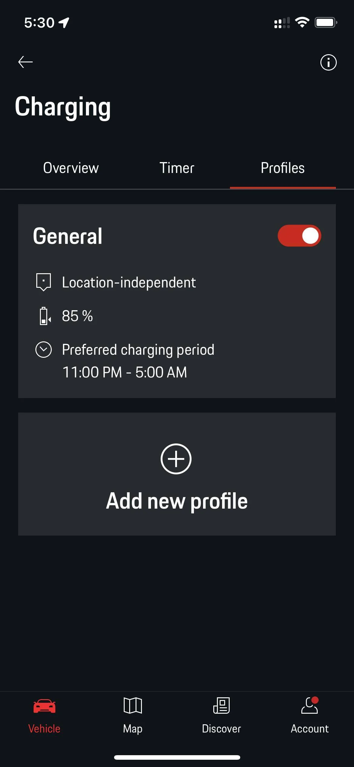

I appreciate you taking the time to attempt to help. Unfortunately, it did not work. I tried the following with no timer...
And because of the 85% minimum charge, it started charging right away, at 5:30pm.

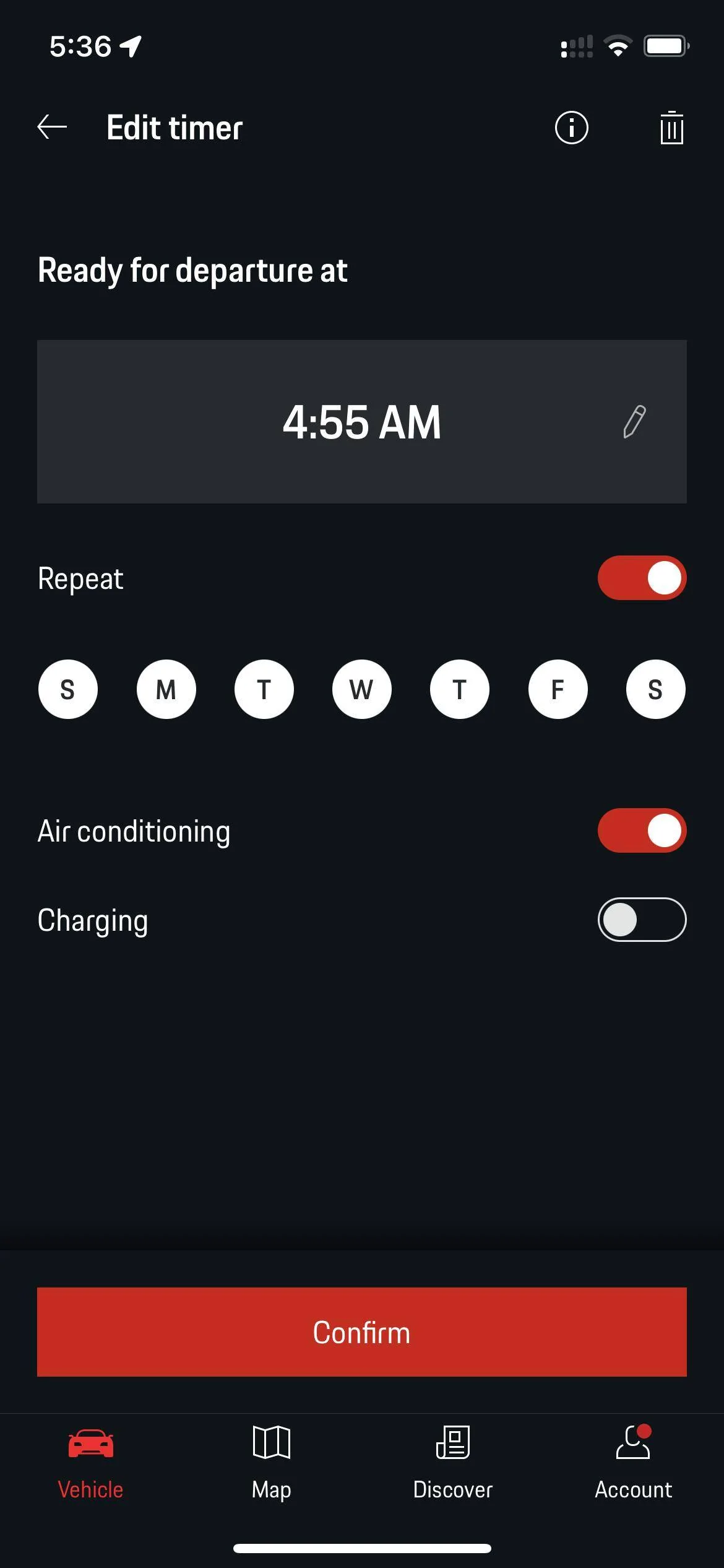

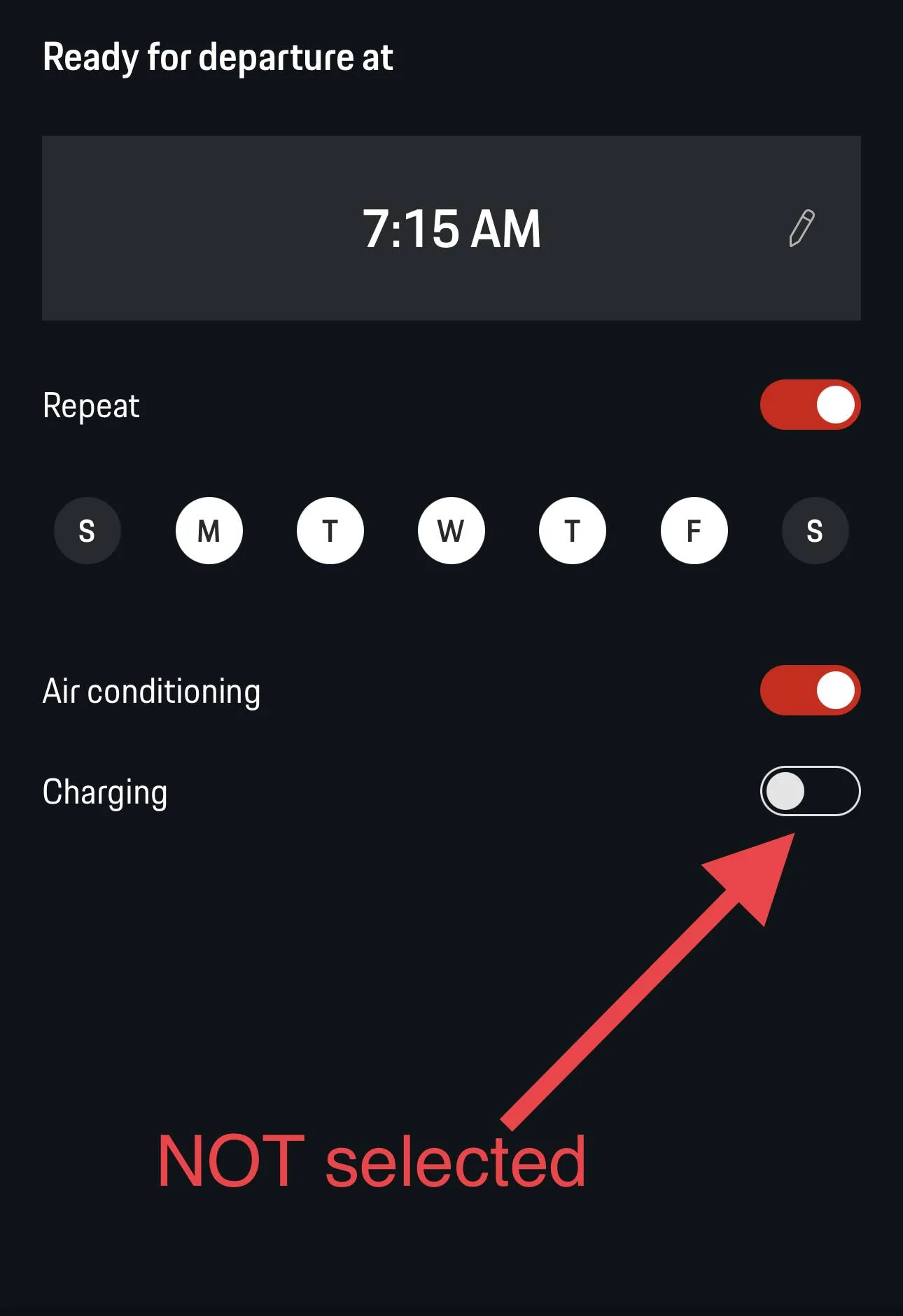

So I tried again but this time added a timer WITHOUT charging selected as you suggested just to see if that changed the behavior. I set the timer to 4:55am because it sometimes takes a couple of extra minutes to finish in my experience.
Again, the car started charging right away. The only difference this time is that it planned to have my A/C ready at 4:55.
I'm telling you, there is no possible way to get the car to start charging immediately at 11pm and stop at a specific percentage. The only way I found was by using a smart plug that made it impossible for the car to start charging until I provided power to the EVSE.

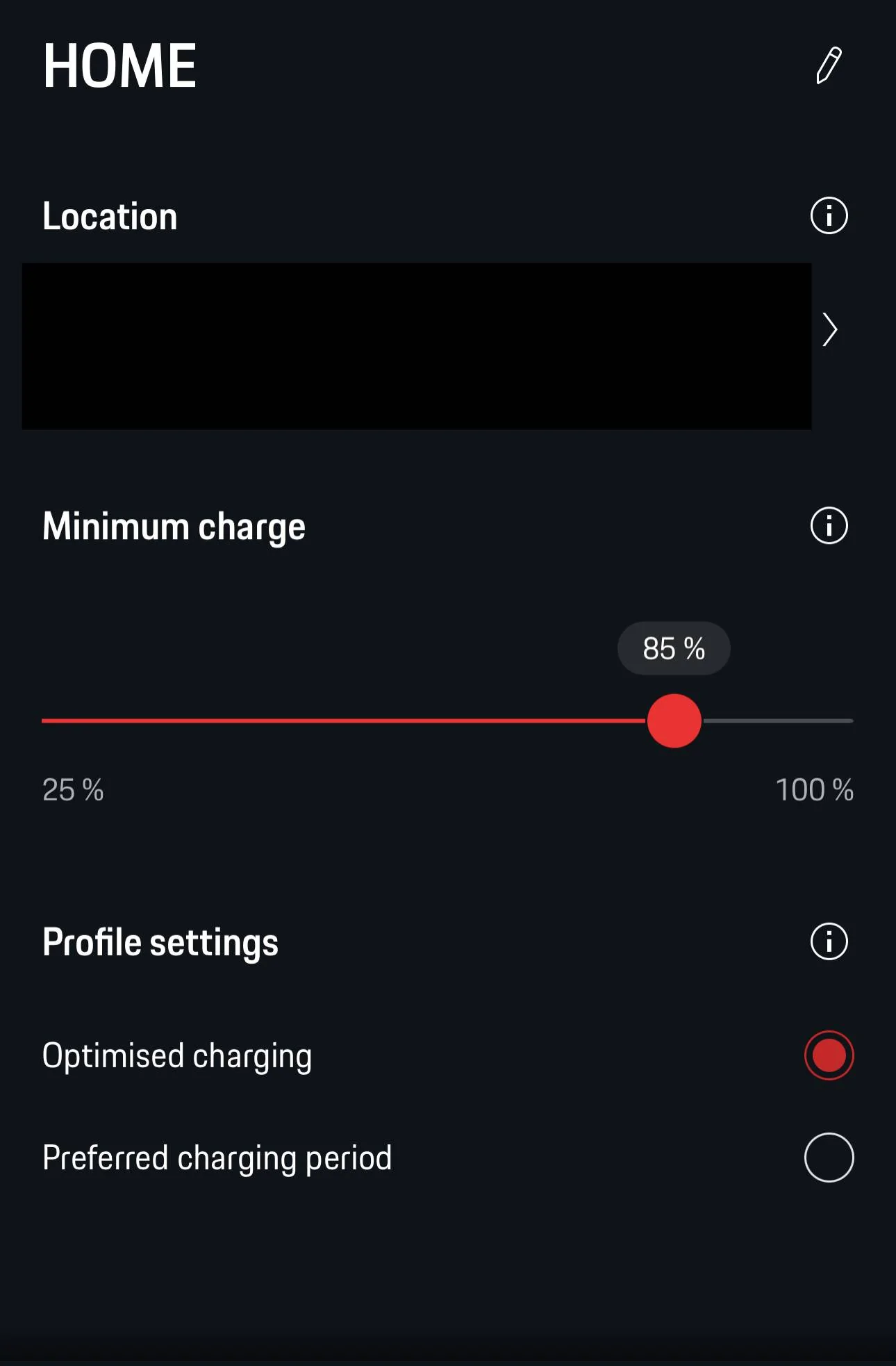

Did you have optimized charging selected in the profile? I believe that is a requirement to get the behavior you’re looking for.

The car will start charging ASAP to achieve the minimum level (85% in your case) and ignore everything else in the timer.
Porsche’s view is that ‘Preferred Charging period’ kicks in only after you have reached the minimum.
The only way (at the moment) to achieve what you want (i.e start charging at 11pm, regardless of charge and charge to 85% or until 5am, whichever is first) is NOT possible with Porsche timers.
The only way to achieve this is via an external timer at the EVSE or a smart plug or something.
I have done development work both Octopus and OVO (energy suppliers in UK who offer advanced multi-rate pricing in the UK, not just limited to low rates in the night, but rates changing every 30 minutes)…. and Porsche does not support the use case you are looking for.
Porsche’s definition of ‘Preferred Charging Period’ - is not what we think it is. It is still a lower priority than the minimum charge.

On my phone so excuse the poor formatting. Here are my settings. It’s all about the minimum charge on the Charge ProTo achieve what you’re desiring, I believe you can have the same settings except for:
On this page, you’ll want to select Preferred Charging Period (11pm start & 5am end for you).
On the timer page, you SHOULDN’T need any changes but can select additional charging timers if needed. I simply have it set to run my AC and have the car pre cooled by the specified time.
If you have these set already and it’s still not doing what you want, then maybe I’ve glitched mine out by toying with it enough that it just gave up and happens to work as expected now. ?
The way I charged BEFORE getting our Rivian (thus adding a second EV) is exactly as described above, and so I’d plug it in and it would sit without charging until 10pm, and end at 6am (super low rate).
Now, with two EVs, I took off the time requirement so if I need to charge, I just plug it in. We changed to fix cost to avoid having to really baby it. I plug it in, starts charging for however long it takes to get to 85%.
The use case is not supported by the application.
Porsche definition of 'Preferred Charging Period' is still lower priority than the 'Minimum SOC' in the profile.
So, the car will start charging to the minimum SOC - "as soon as you plug it in"... and ignores the 'Preferred Charging Period'.
I am not saying this is right or wrong - but this is what Porsche choose to implement - and almost every Smart EVSE charger has struggled to cope with this implementation.
Both Octopus/ OVO energy in the UK have integrated their EVSE charging apps with Porsche (using Porsche APIs) and the experience has been painful and the end result is sub-optimal.
The only way to achieve the OP use case (which is actually not that common or special !) is to use an external timer of the EVSE or smart plug etc..
Porsche does need to consider simplifying the charging profile/timer concept..
Optimized charging requires other external hardware and software... which I believe is Home Energy Manager and/or an integration with your utility. Otherwise, it has no effect on charging behavior. If you read the manual it says it works "in conjunction with suitable charging equipment" it can "enable the vehicle to be networked with the local charging infrastructure, e.g. automatic use of individual electricity rates or charging with solar power."
I have tried "optimized charging" but it doesn't provide for the input of any information about your rates or peak hours, so it has no means to know what "optimized" means without the added hardware. I think Home Energy Manager is required, but I'm not sure. It's possible there are other ways to utilize the feature, perhaps if your utility's API supports it? In any case, this also isn't an option for people like me. And I'm still unsure how it would behave if I had HEM. Would there be a way to limit the charge to 85%? I don't see any settings for that when "optimized charging" is selected.
What's crazy is that Porsche recommends limiting the charge to 85% for daily use, yet they offer no means (possibly even including the use of HEM?) to limit the charging hours to a preferred time AND limit the charge to 85%.
Edit: You are right, my brain was malfunctioning.
That's what the manual says. Based on reading this forum for 2 years it has an impact when you flick that switch. Try it.

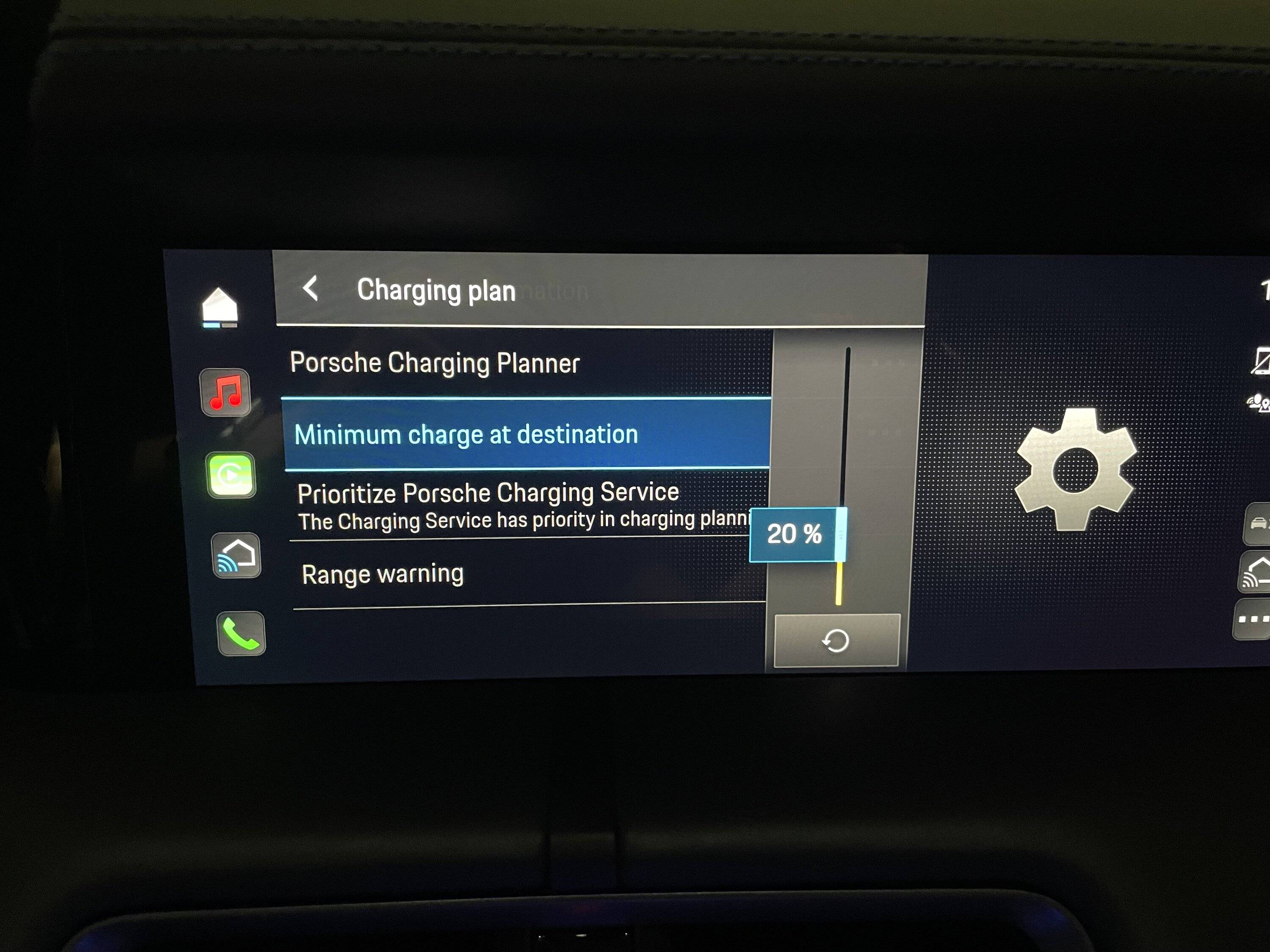

Indeed, I would like to add that a Minimum Charge at Destination for Navigation would also be a useful feature.
I have good news for you... it's in navigation settings under charging plan.

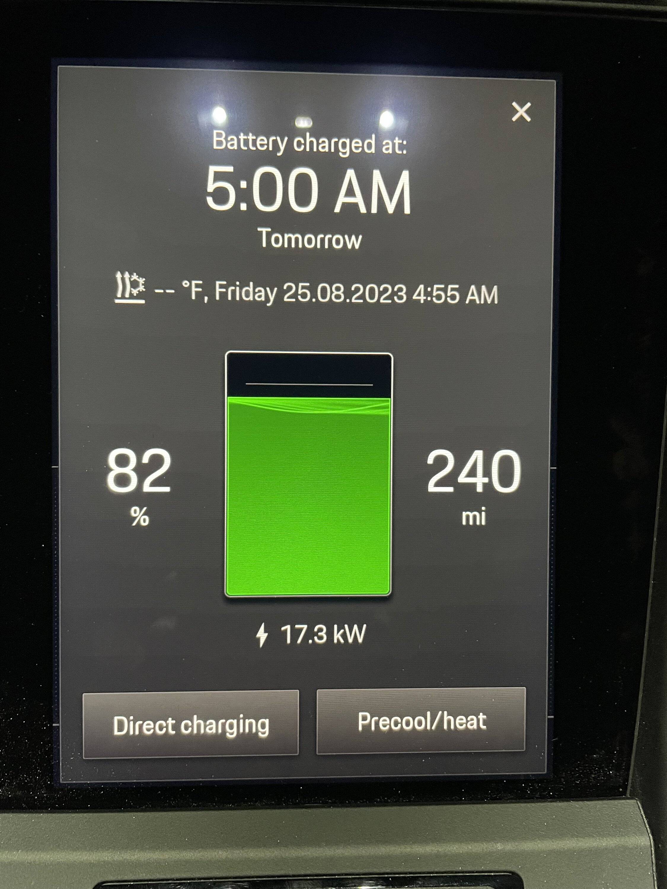

Porsche Taycan New 4S, Low Range… IMG_0560
Rock
Ralph
Jul 27, 2021
Odessa, FL
2021 Porsche Taycan 4S

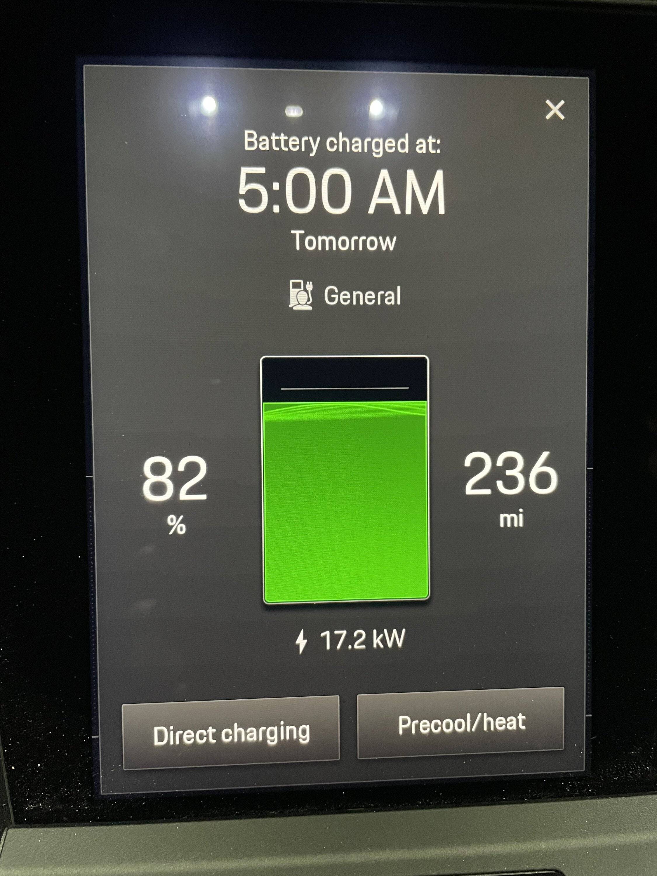

My car is 2 years old and it is showing 270 miles on 100% charge. It has a little over 12,000 miles on it and seems to have increased the range over time.
