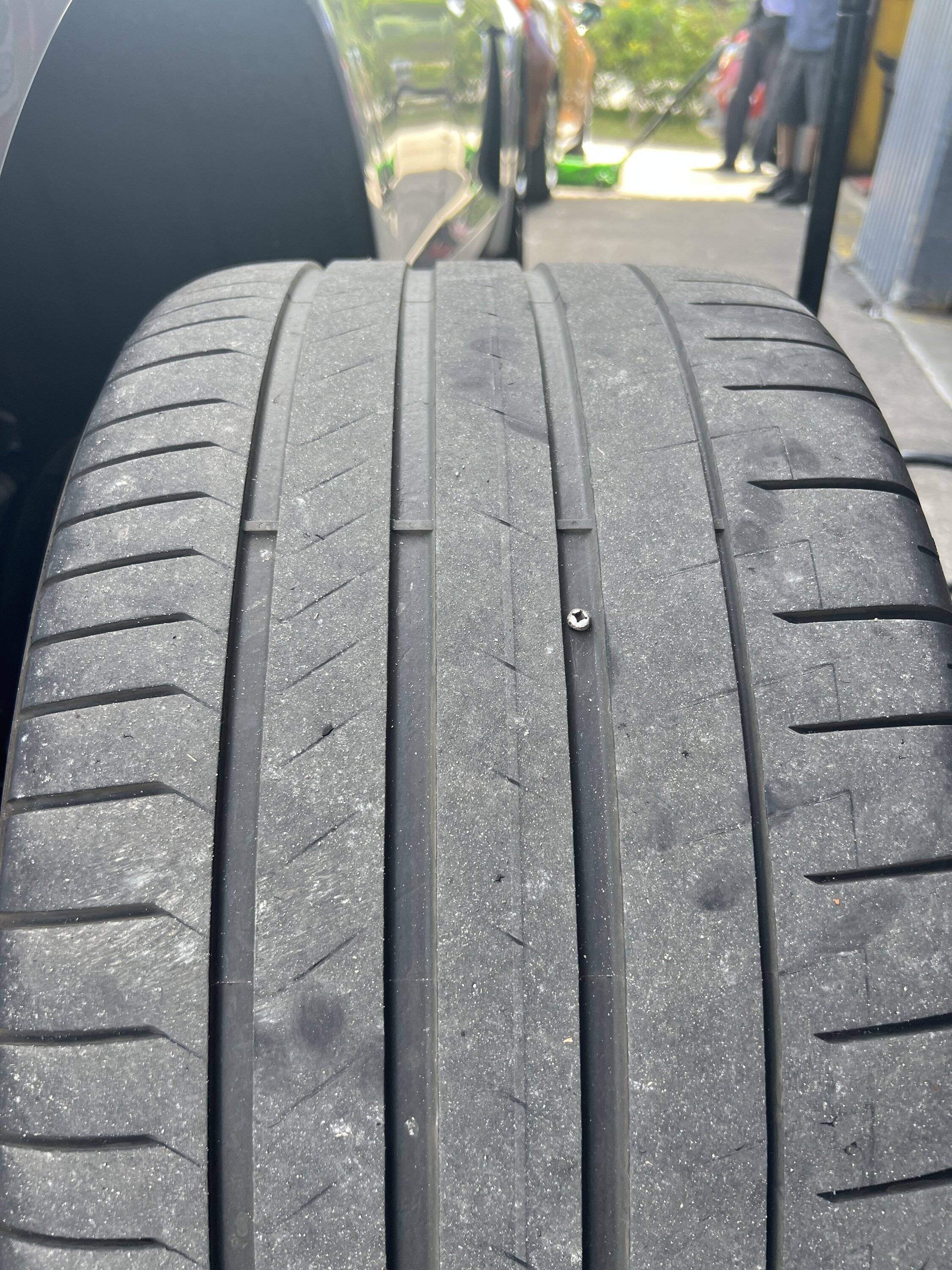

Does this look like a tire that needs replacement?
Service departments are crazy lately.
Both tires repaired and zero issues.

Yeah, it’s screwed. (Sorry, had to.)
Honestly that tire does look to me to be nearly done. You have a bit of tread left to the wear bars, but the siping is worn out. (Might have been overinflated, as the wear seems to be accentuated in the center section.)

A bit of tread left to the wear bars? Have you looked at these tires brand new? They don’t have much more tread depth than that picture. And the siping that really matters on a sport tire is along the outer edge, which looks fine. Those tires are wearing very evenly and have plenty of life left.

Have to agree with you, there is plenty of life left in that tyre! There is a fair bit of rubber left to the wear bars.
As someone pointed out perhaps a bit overinflated, but I am no expert. The issue for the service department was that they do not recommend any repair when there is a puncture like that. If a reliable tyre shop are fine to do a proper repair than fine.
