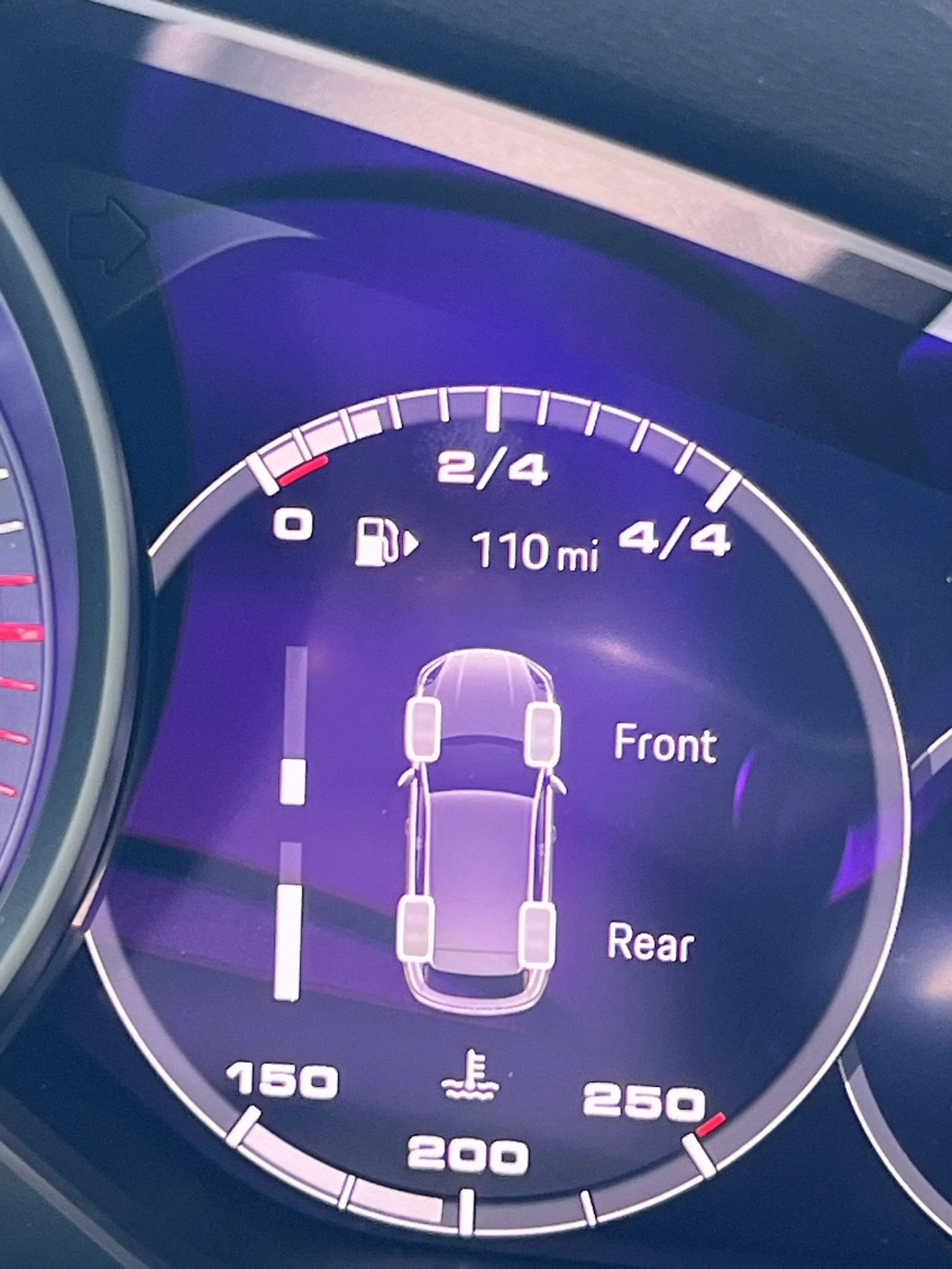

I wasn't planning to weigh in on this until I saw this image. FWIW I did have to replace one tire due to a nail but the others have 14K miles on them and look like I can get at least 3K more out of them. I have the Michelins.
Now, can you share how you obtained this image on your dash??
This is from the loaner ( cayenne )

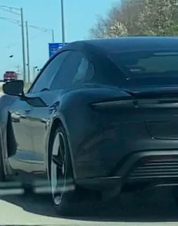

Here is one more theory that explain the premature tire wear. With air suspension we have the ability to drive around in "stud" mode with the car sitting very low. Below is a pic that my wife took as I zipped by her on the highway.
Porsche Taycan New tires at 4657 miles? Screen Shot 2022-11-14 at 7.27.24 PM
Note the serious negative camber on the rear wheels. According to everything I read, driving in the lowest suspension setting results in the best aerodynamics (and makes the car look uber cool). When I swapped out the summer for the winter rubber, the tire guys pointed out some extreme wear on the tires which they attributed to the 2+ degrees of negative camber. The tires were not shot after 6K miles but they were getting close. An engineer friend later explained to me that decreasing camber when lowering the suspension is normal, not a defective condition. (Not being an automotive engineer I thought this was pretty f'd up.) With your next set of tires, maybe try leaving the suspension in "normal" vs "stud" mode and see if the tires last a bit longer.

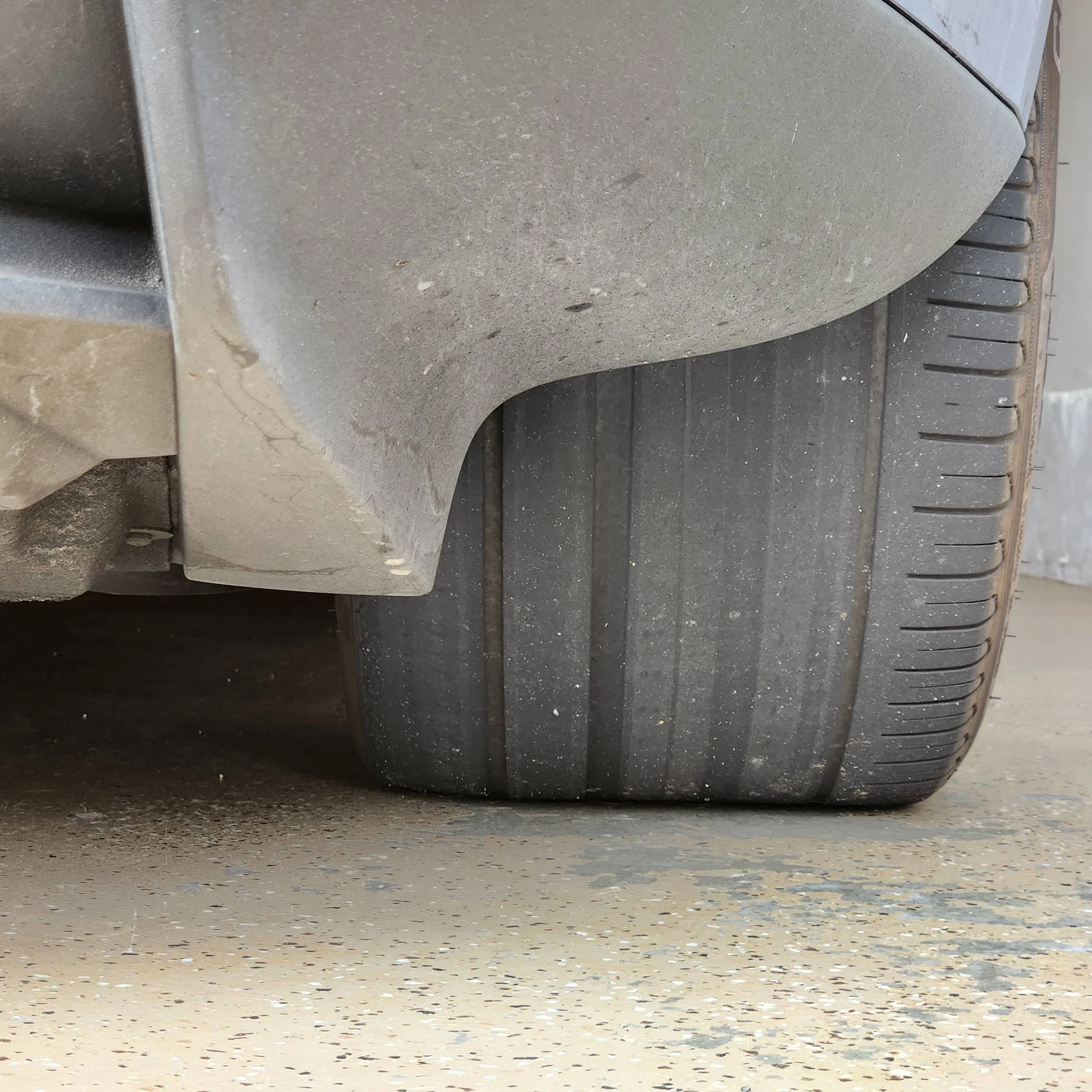

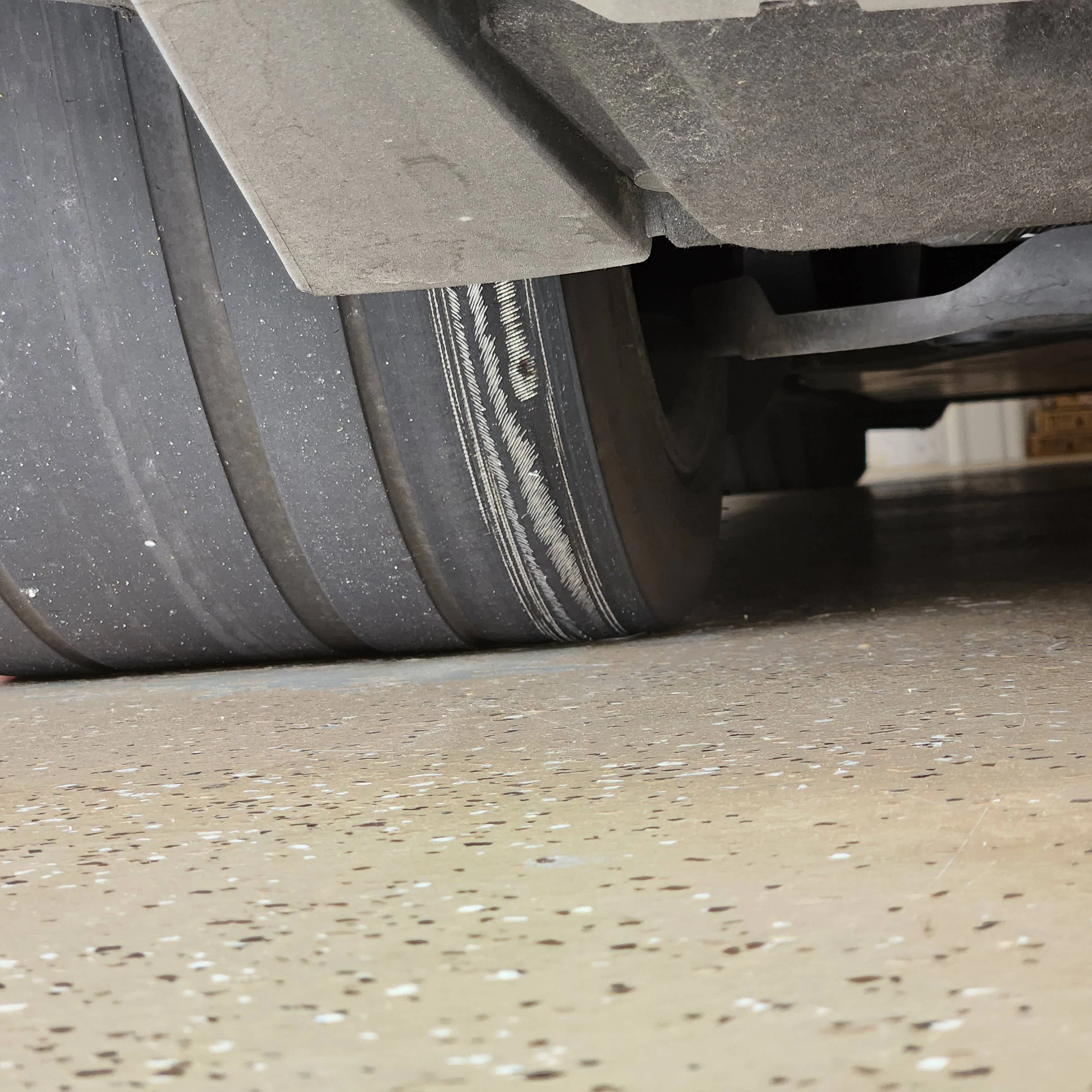

Interesting, this makes sense now if you look at pictures of my prior rear tires (at about 14 000 miles - 2nd rear set, on 3rd set now). Pirelli Cinturato p7's. I always drive on 'stud' mode and in fact did think of driving in normal to see if it makes a difference but just cannot make my self do it! lol.
Apart from the tires being slicks more wear on the insides, which I presume is due to the possible negative camber.
The AWD display used to be available in AWD Taycans since launch (this one is clearly non Taycan) but 'disappeared" after the major software update of last year. There is now an animated power graphic within the PCM under Trip.
Looks like you took a pic of my tires! I do agree that it is really hard to ride in Normal mode. The worst is having to use auto lift when parking at work everyday (a necessity to keep from smashing the lower bumper into the curb) and have the car sitting in the lot, looking like it is on stilts. It detracts from the otherwise "Bad MF'r" vibe that the car exudes!
