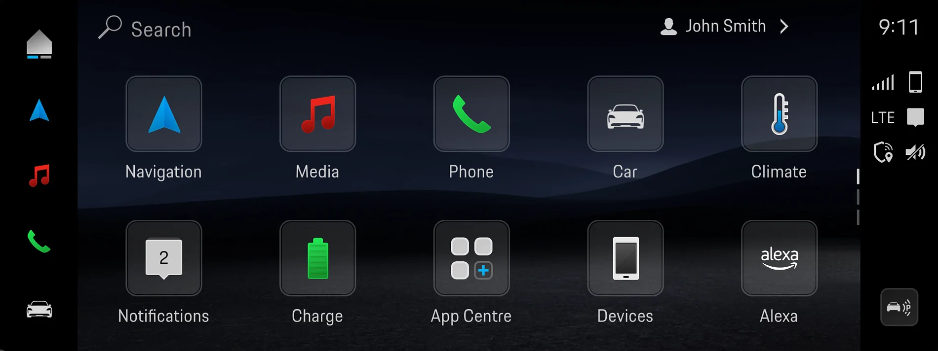

Note that these screenshots are from current gen Taycan J1.2 (so no App Centre or Alexa etc). Tap Car:

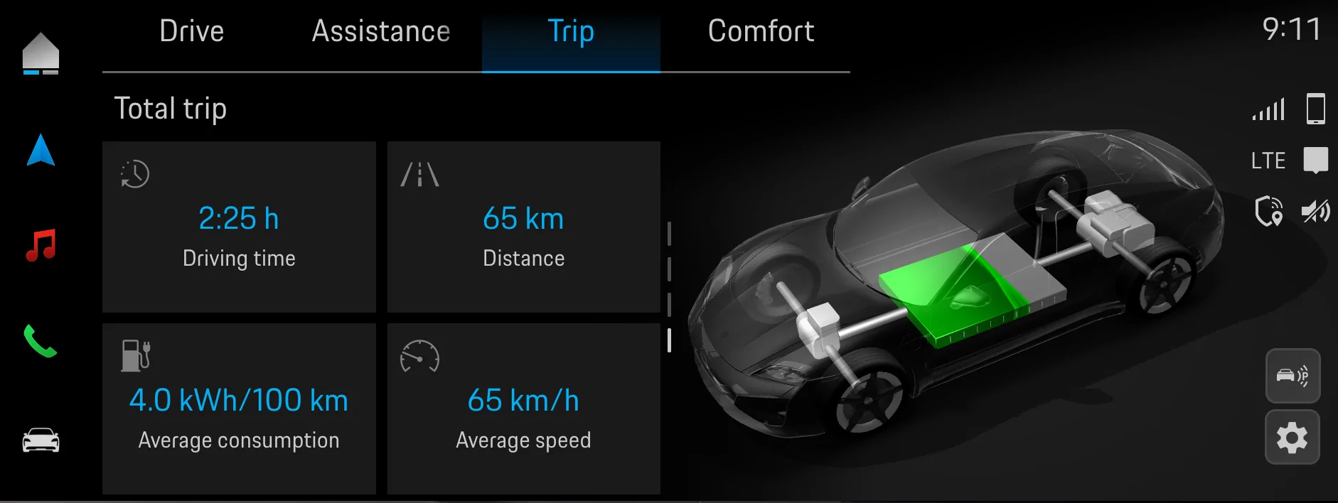

Then tap Trip. Graphic is animated when you move and should be on J1.1 Taycans. I had 2 J1.1s - first one (MY21 4S)went through the uPdate and the 2nd (MY23 GTS ST) already had this:

On your image the data doesn't look right 65km/h average for 65km driven should be 1h, not 2h25, and only 4kwh/100km seems completely crazy ?
I get 40kw/100km with battery temp 3°c (not raising much, unless I DC charge obviously), small distances per trip (usually less than 20km) since 2 weeks, car sleeping outside for now (-4 to +4°c these last 2 weeks), using pretty often smartlift, cabin conditioning in "eco" mode, wheel & my seat heating, driving usually in normal & sport, with a few accelerations here and there for fun (cautiously due to weather), but I haven't been driving 2h on the highway at 150km typically :)

Screenshots are from the Porsche simulator (I don't have my Taycan anymore) so don't take the numbers seriously.

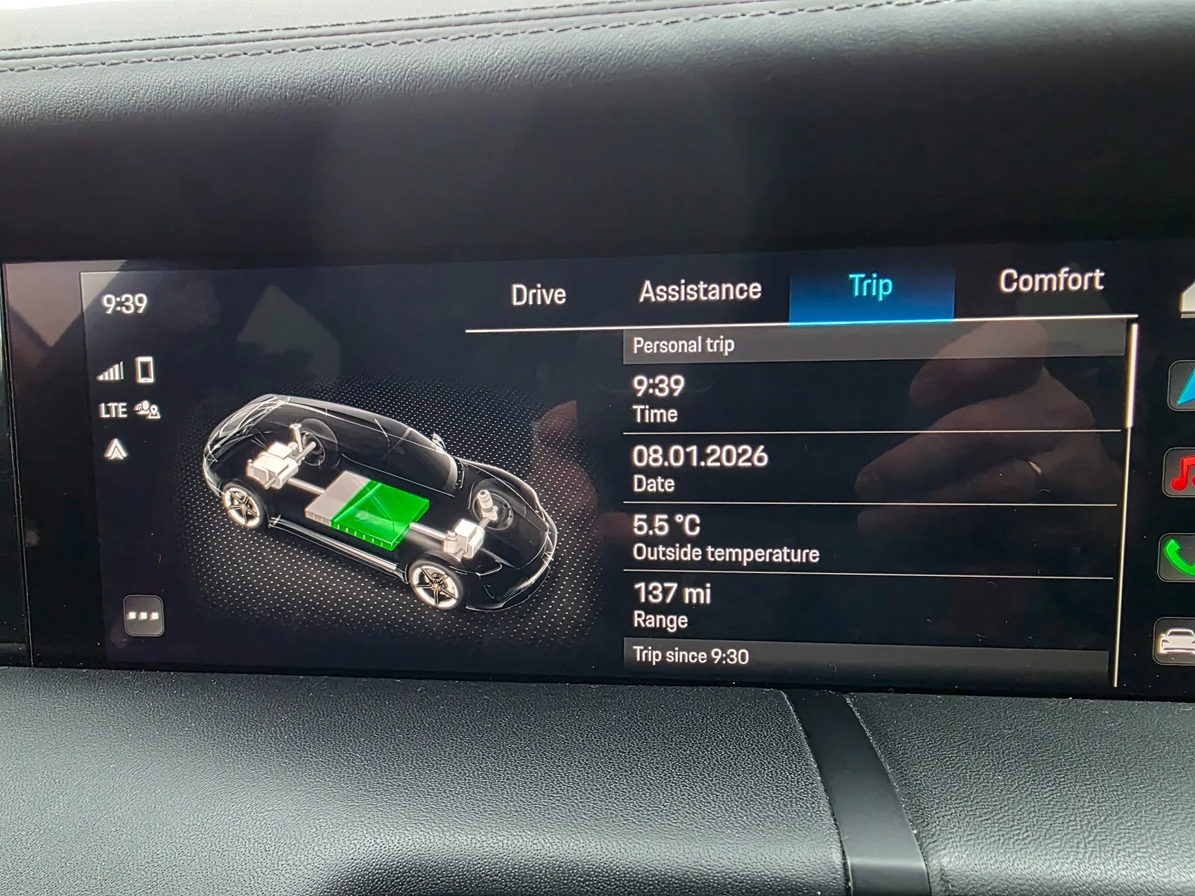

Thanks Adrian, I'm pretty sure I have text instead of this graphic but I'll check again & take picture.
It's definitely there on a 2023 J1.1 - though it looks different:
