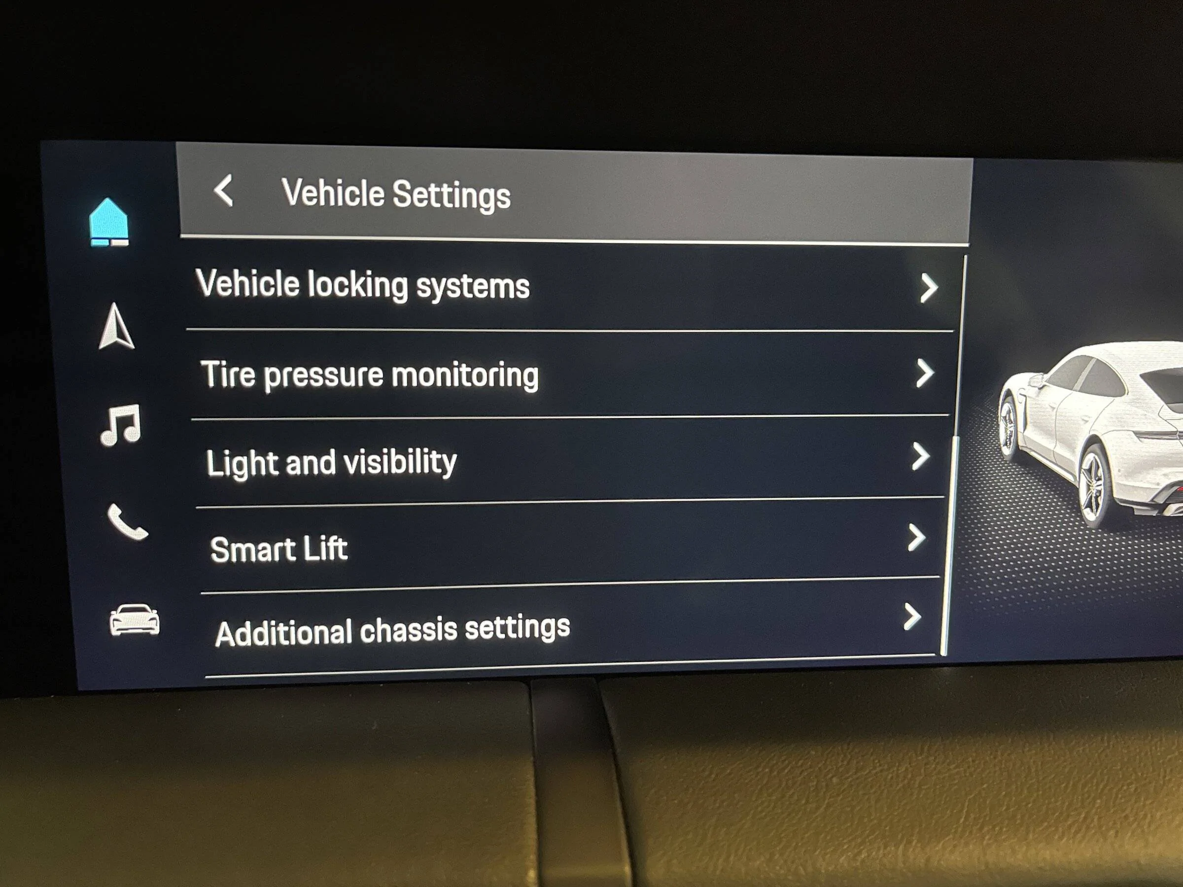

The weirdest thing happened. I have never had Smart Lift in my PCM menu, but the function has always worked. Tried locking the car, rebooting the PCM, etc. After 6 weeks of having the car, the car notified me that a Maps update was done, and for the very first time, I now see "Smart Lift" in the menu. WEIRD!
