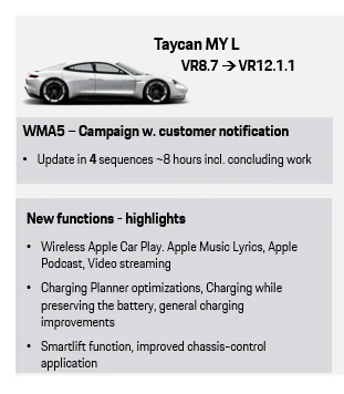

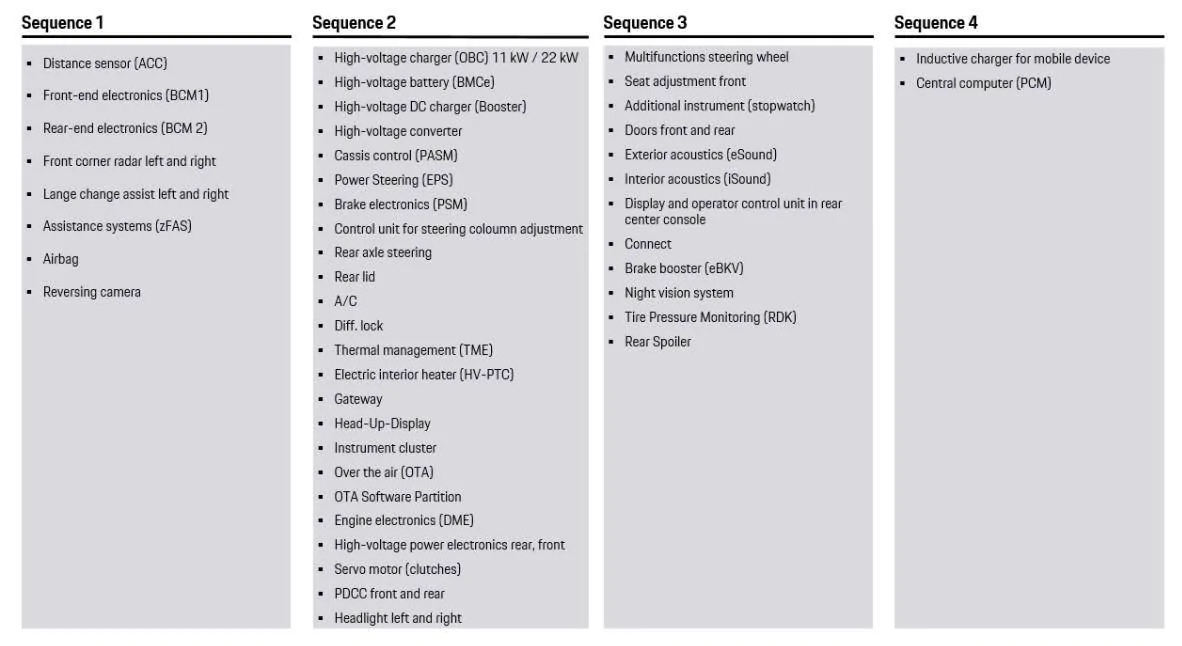

There was an update for the inverters last year.
Now there's a big update for all cars.
MY20: WMA5 for update to MY21 spec (takes at least 8 hours).
MY21: WMA6 (takes 4-5 hours).
You'll be informed by email, letter or dealer.
Thank you for this! I just called the dealer back and talked to a different service consultant. He knew about this update and said my car won't be eligible until I receive the e-mail or letter. Not sure why the slow roll out, it's kind of disappointing they won't just install it for me, but will definitely look forward to this update.
