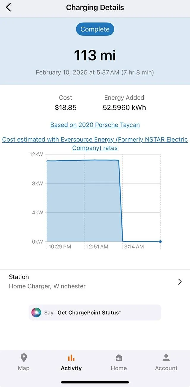

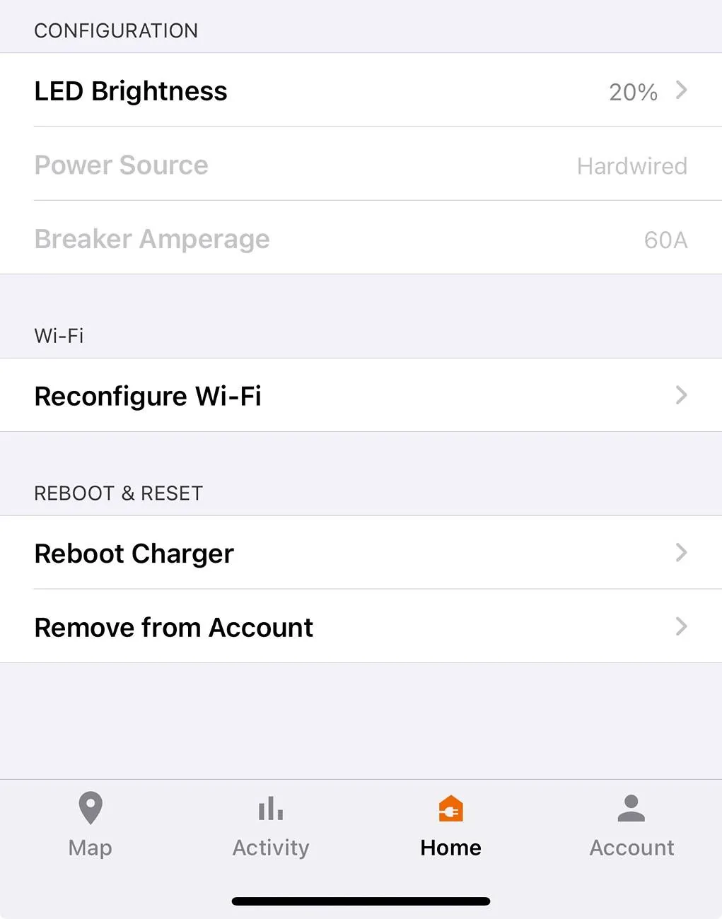

Taycan4S
I think I have all the software updates, including the battery check. I have a 2020 4s and ChargePoint home flex (since March 2024) and have not seen a change. It is hardwired for 60A and I’m getting 11kw. My home 240 is more like 210-220. The car is reporting a little over 10.
Porsche Taycan OBC charge rate question - 11.5 kw vs. 9.6 kw? IMG_6040
Porsche Taycan OBC charge rate question - 11.5 kw vs. 9.6 kw? IMG_6039
