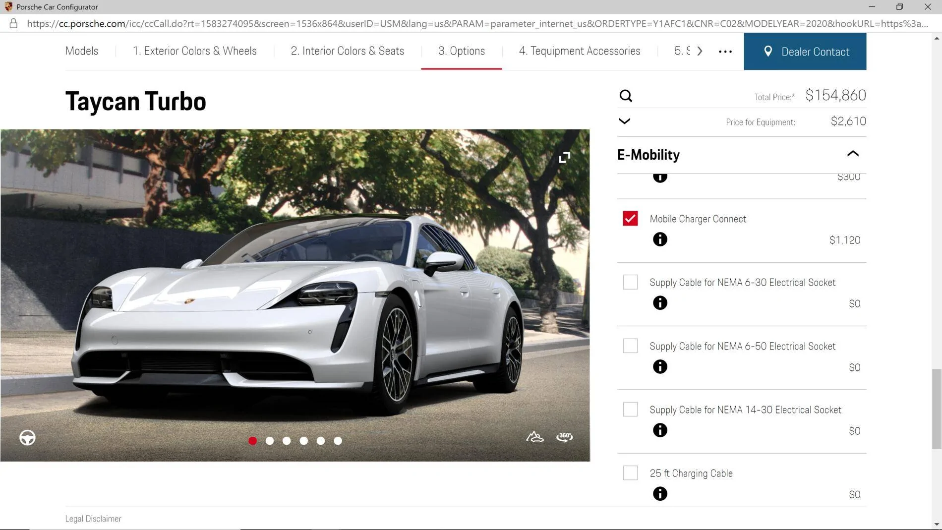

Well, could be that a 14-50 plug is standard. I actually know nothing about this topic (never had an EV before), except what Porsche configurator offers and what dealer said I should order.

It's confusing - the Mobile Connect charger comes with a Nema 14-50 pigtail. The $0 options you see above allow you to replace the 14-50 pigtail with a different configuration. It's a mutually exclusive choice. 14-50 is by far the most common, at least here in the US and including at public locales like RV parks, so it's the correct option to be the default. Unless you know you have a different connector at home and know why you need to swap out the 14-50 you should not select any of the Supply Cable options.

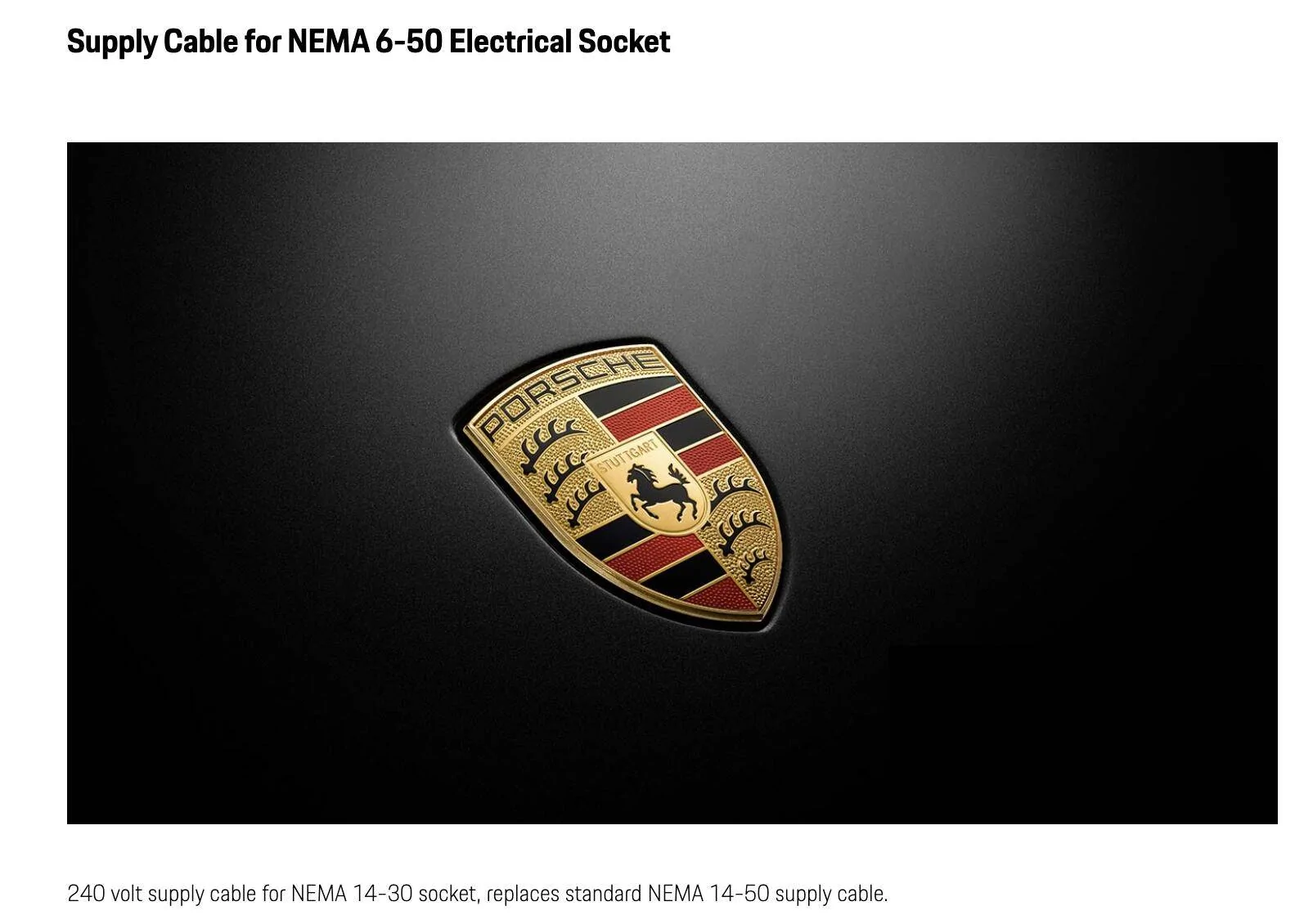

Hmmm. Configurator only offers the following plugs for the EVSE: NEMA 6-30; NEMA 6-50; and NEMA 14-30????
The answer is DO NOTHING!!!! At least for USA customers.
See the selection of alternate plugs clearly states:
Supply Cable for NEMA 6-50 Electrical Socket
240 volt supply cable for NEMA 14-30 socket, replaces standard NEMA 14-50 supply cable.
Simply do not select an alternate plug and you will get the NEMA 14-50. Don't Worry Be Happy... :cool:

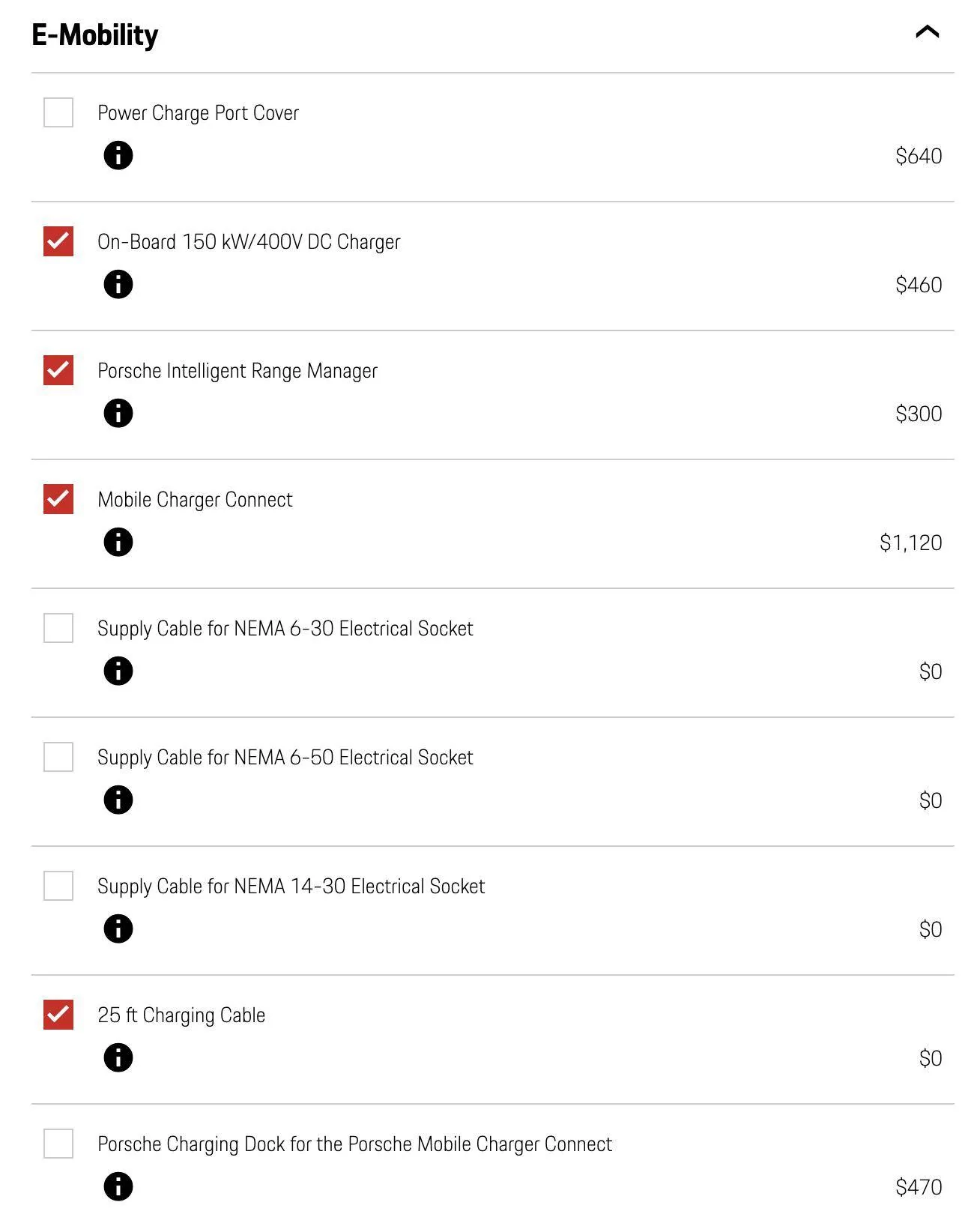

My config selections are:
Porsche Taycan Maximum AC charing rate: 9.6 kW or 11 kW? 1583282061247

In the US, look at the standard options as Porsche provides 14-50 standard in all builds unless you change it. Go for the free 25 foot cable as I hear if you order it later it is $755.
