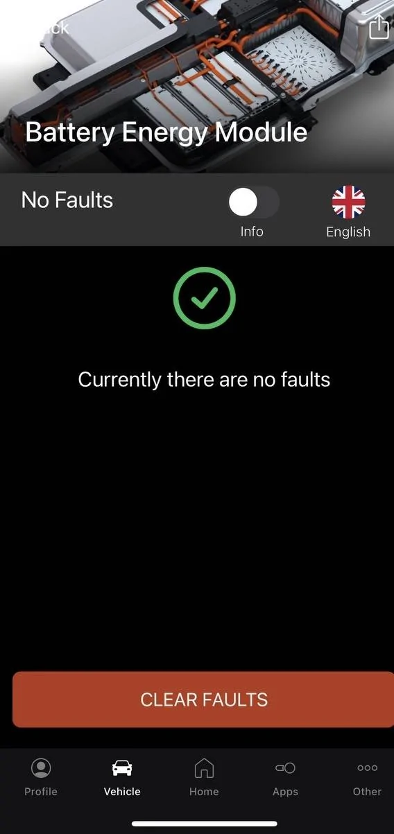

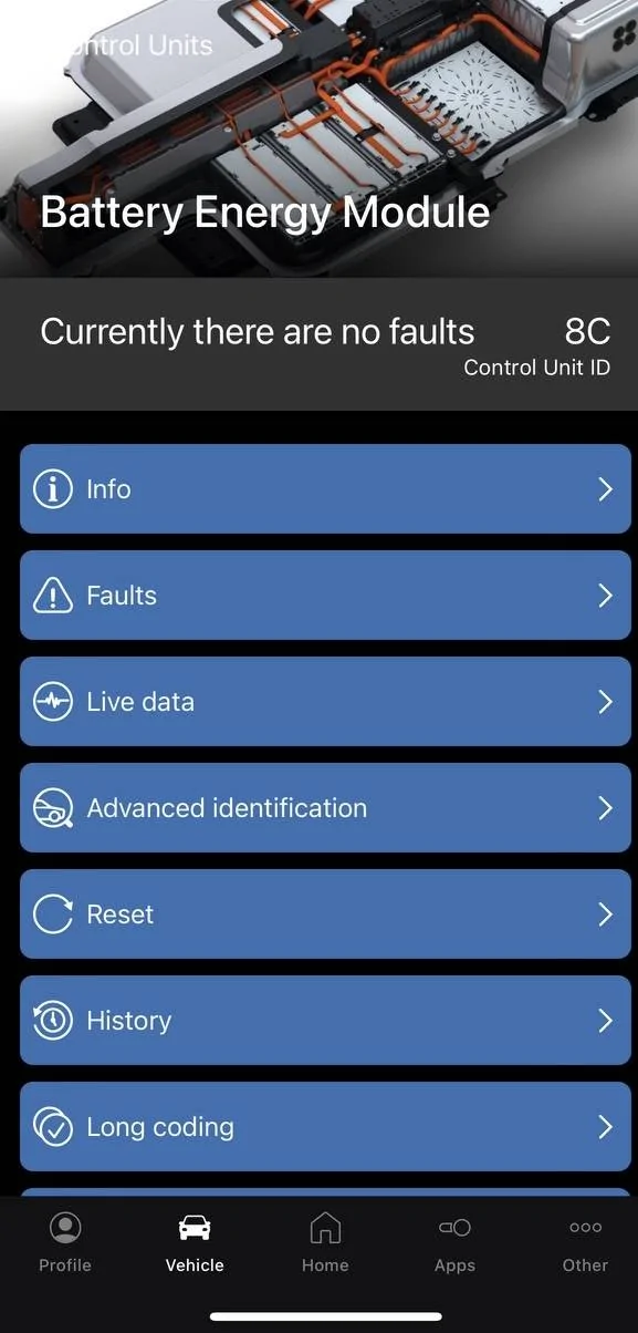

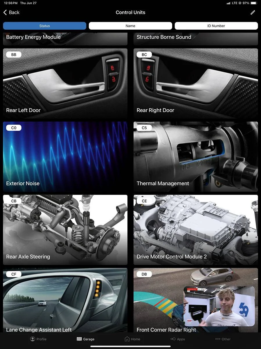

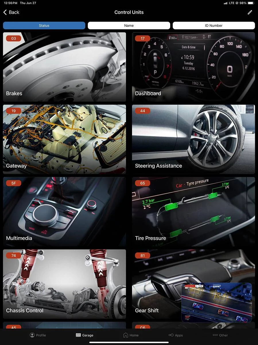

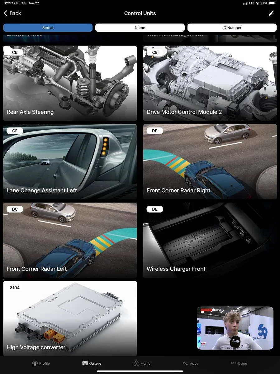

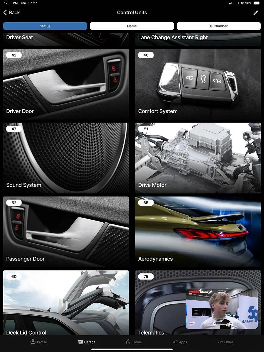

Made some quick attempts. Nothing for coding/adaptations. Really think this is limited on the Porsche end. I doubt VCDS will do any different. The later Audis are also limiting changes.
Porsche Taycan OBDEleven supports Taycan IMG_7074
