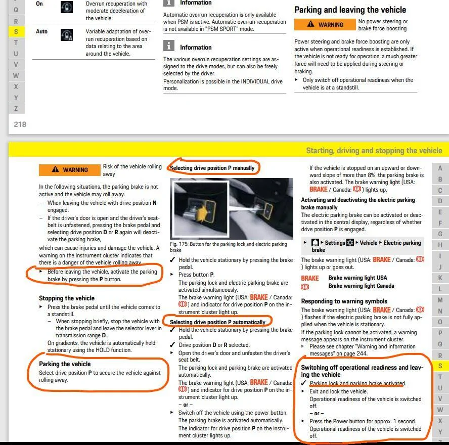

I see where you are coming from. In my e-tron, I push the power button and don't put it in park (and the power button doesn't need to be held down).
If I put it in park and then turn the car off, the parking brake is not automatically initiated so it rolls a bit which I do not like. If I push the power button from Drive, the parking brake is initiated, car is put in park, and the vehicle turns off.
It's not a problem for me when going from either vehicle as I just remember, but it's weird how they aren't the same given they're both VAG.
Still wish that both of these cars had walk away door lock like so many cars do, but I'm used to it now.
Ah, yet another "perk" of Audi. Btw, it will auto-set the parking brake when parked on a hill. Also, apparently other Audi's have auto-parking-brake setting available to program via OBDeleven, but when I tried it on the Q8 etron, the coding step failed :(IIRC the only thing I was able to code was Scandinavian DRL's.
