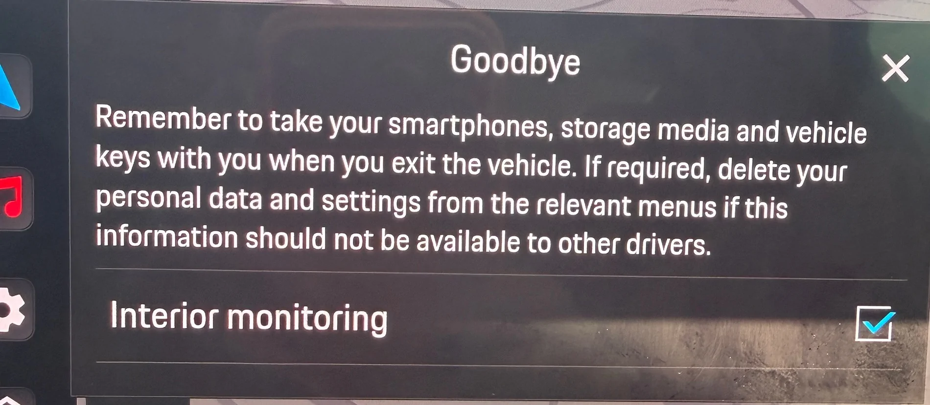

When my Comfort Access got disabled after an update, my car no longer powered off when I locked it.

I may have found the reason why it isn't working for me and maybe for you. I request a check of the interior alarm each time I turn off the car as I have a dog who is almost always present and remains many times in the car while we run an errand. This check allows us to turn off or keep on the interior car alarm once the car just got turned off. Consequently, it is making sense that the car refuses to turn off once outside using the door handle button or the key if the car hasn't been turned off first. It is possible to remove this "check alarm" in the configuration in the PCM. Personnally, I need it so I am not going to try but maybe for you, that was triggered at the update. It is something for you to check. IF when you turn off the car it asks you to keep or remove the interior alarm, it is clearly set like my car. Remove this step at turn off and I bet you could get the car shutting down in pressing the handle button once outside.

I have something similar, I think. Is it this? Mine is automatic.
Porsche Taycan Power on/off button.. Long press time? IMG_0073
