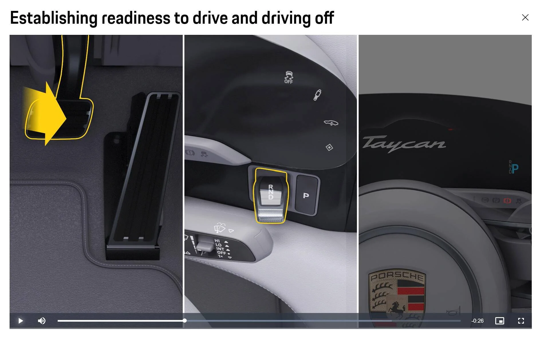

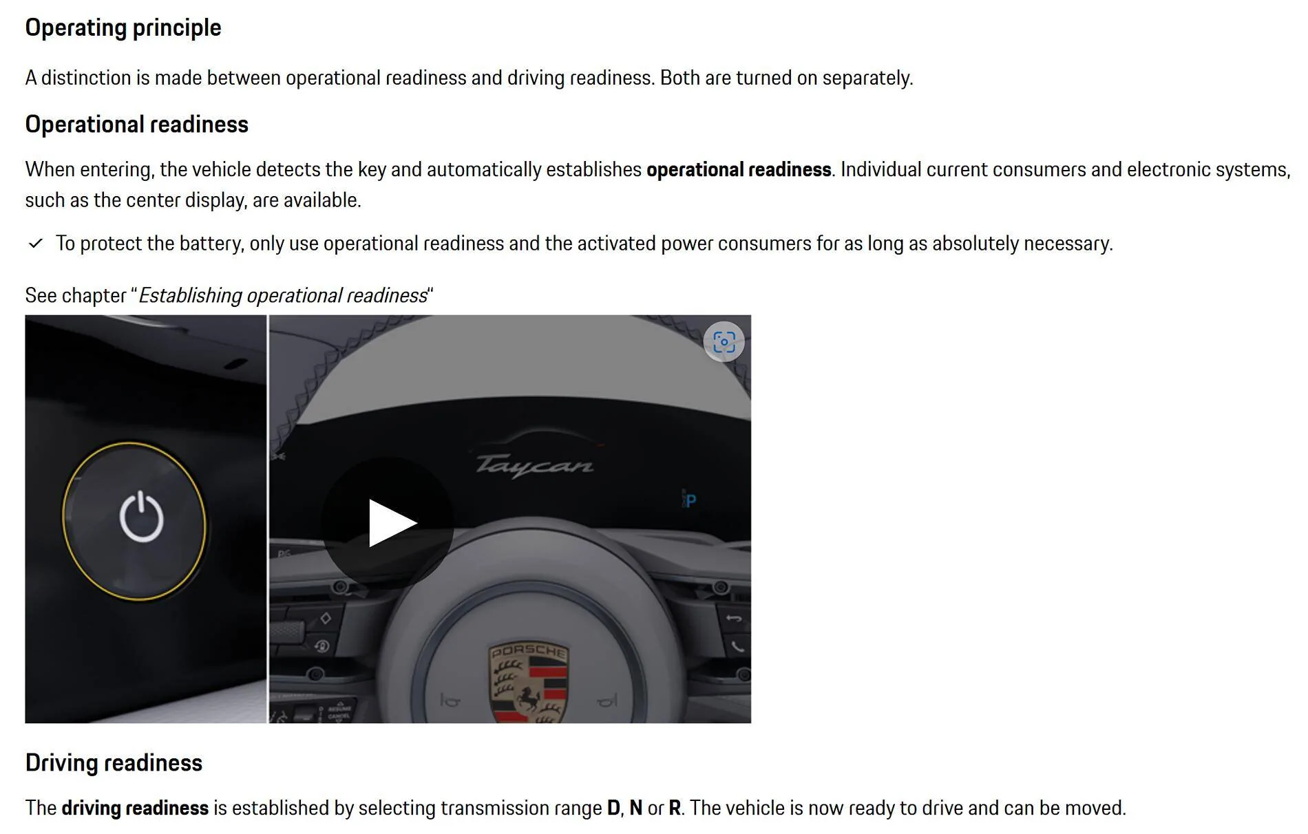

There is a difference between Operational Readiness (electronics on mode) and Driving Readiness (brake must be pressed down before gear shifting is possible).
The only way I can see to make it more difficult is to read Comfort Access section and dial it to the mode that you think would prevent kids from getting into the car by turning off certain features or disabling the ability for the key to be detected on approach.
Porsche Taycan Power Off & On 1733270531630-qg
Porsche Taycan Power Off & On 1733270587900-kf
