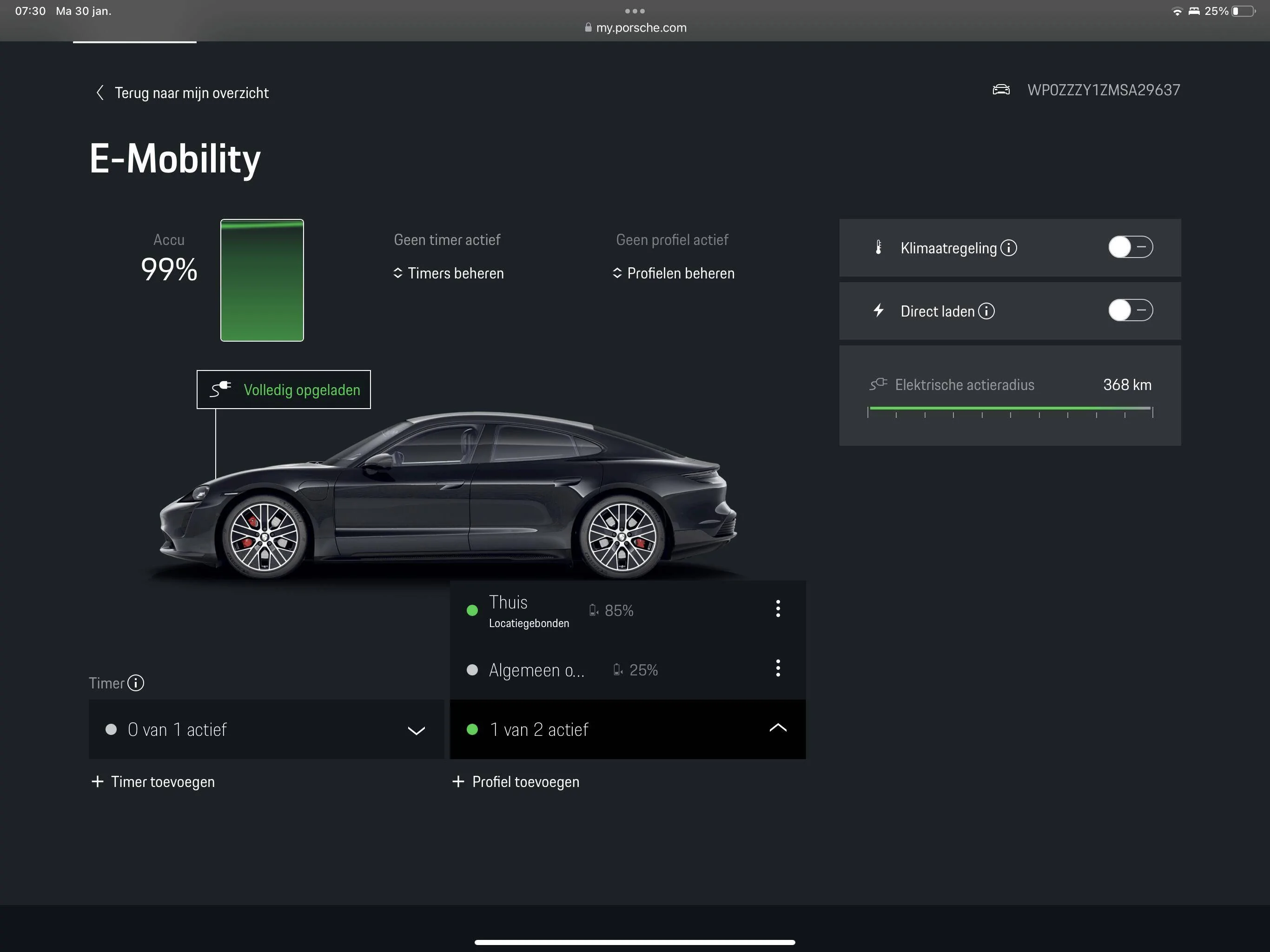

It seems the % only works as a cap in the default profile?
all additional profiles it’s a minimum?
The only visible difference between the two is the geolocation feature to auto select (it works reliably) but the other settings appear on the surface to be the same and should function the same.
That’s logic talking, but reality seems to be different, according to the screenshot?

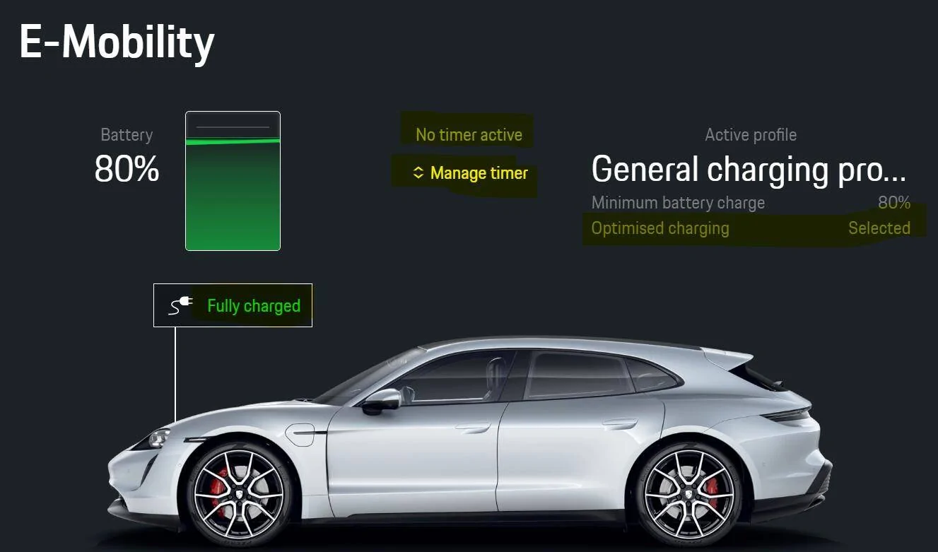

That is (sadly) interesting - is your profile of type General or Location based (not that it's entirely relevant)?
Which EVSE are you using?
I have a suspicion that something may have been tweaked in the 2 years+ since launch that has slipped under the radar and as a consequence fuelling the confusion and therefore advice being given.
I feel the need to revert to a profile only charge and see what happens..I gave up on it in the early days as charging would never stop within the window given and so always charge to 100%.
Yes using the general profile with no location. My EVSE is quite old, a basic chargemaster with no internal options so just using the car to set configuration. I followed a youtube video to get to this as had problems before getting what I wanted when using timers for home charging. I'll try it with a another profile and see if it is the same.

It's interesting reading all the different ways to charge and keep it at a set SoC. I have mine just on a profile with an 80% minimum, optimized charging and NO timer. The car charges to 80% and then just stops and states it as fully charged (i leave it plugged in). No need for a timer at all!
But do you know why it stops at 80%?

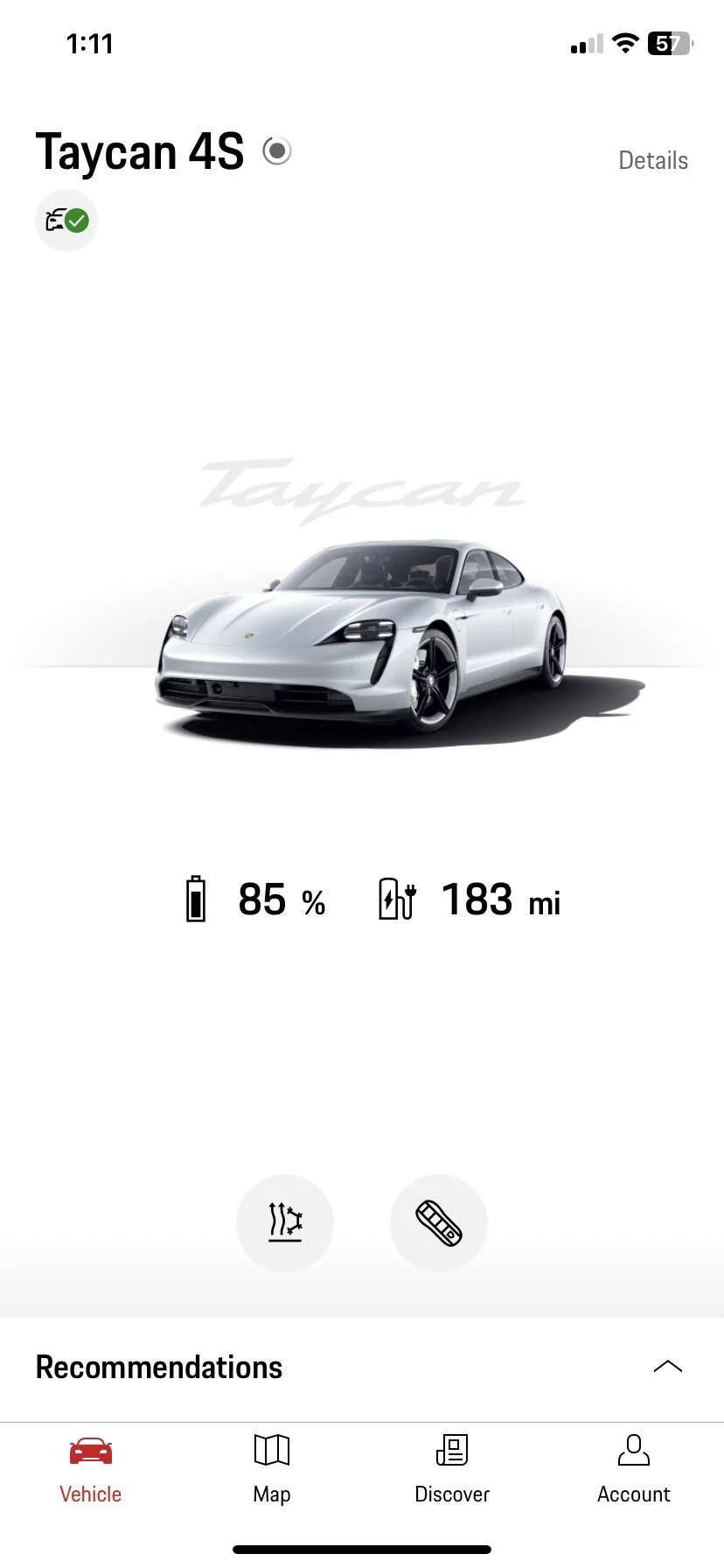

So, tonight my car is still on 98% and my wife will be charging her car.
tomorrow i’ll drive a 150km and will have the opportunity to top up at night.
At the risk of keeping going round in circles, it‘s still unclear to me and I see conflicting responses:
will charging stop (and remain stopped) at 85% when NOT using timers and only use the default program by just setting it’s MINIMUM CHARGE to 85% and ACTIVATING that profile?
Go into the app, select charging under the details/functions tab. Add a home profile, set it to 85%, select optimized charging. Make that your active profile. It will charge to 85 percent and then stop.
I’d you ever want 100 percent, just switch to direct charging.
This is what I had last night and it charged 100% regardless,
Porsche Taycan One more time: 85% Charging 2C2D38FA-DA47-4925-A793-DB92E85E2A1B
WasserGKuehlt
Sep 7, 2022
2,066
2,456
WA
4CT, 996C2, MacanS
This is strange. I'd check the status of "direct charging" in the car - it's possible that the app and the vehicle are out of sync. As others have said, based on the above the car should have stopped charging at 85%.
