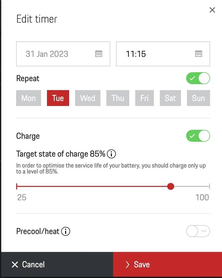

I see 85% and nothing else as a recommendation.
I have an iPhone and am looking at the latest version of the MyPorsche App.
The quotes came from the online Taycan manual which I accessed through MyPorsche app. (I can provide exact navigation details ... it was under "Charging". However, I'd never looked at the "Edit Timer" screen (unless maybe the first week I had the car). So, yes, I see what you see (now). Thanks Bognar67.
I know. The manual is not upgraded as fast as the app.
Manuals always keeping things that have been exceeded by the time.
All together I referred not to the manual but to the app that handles the car incl. charging setup.

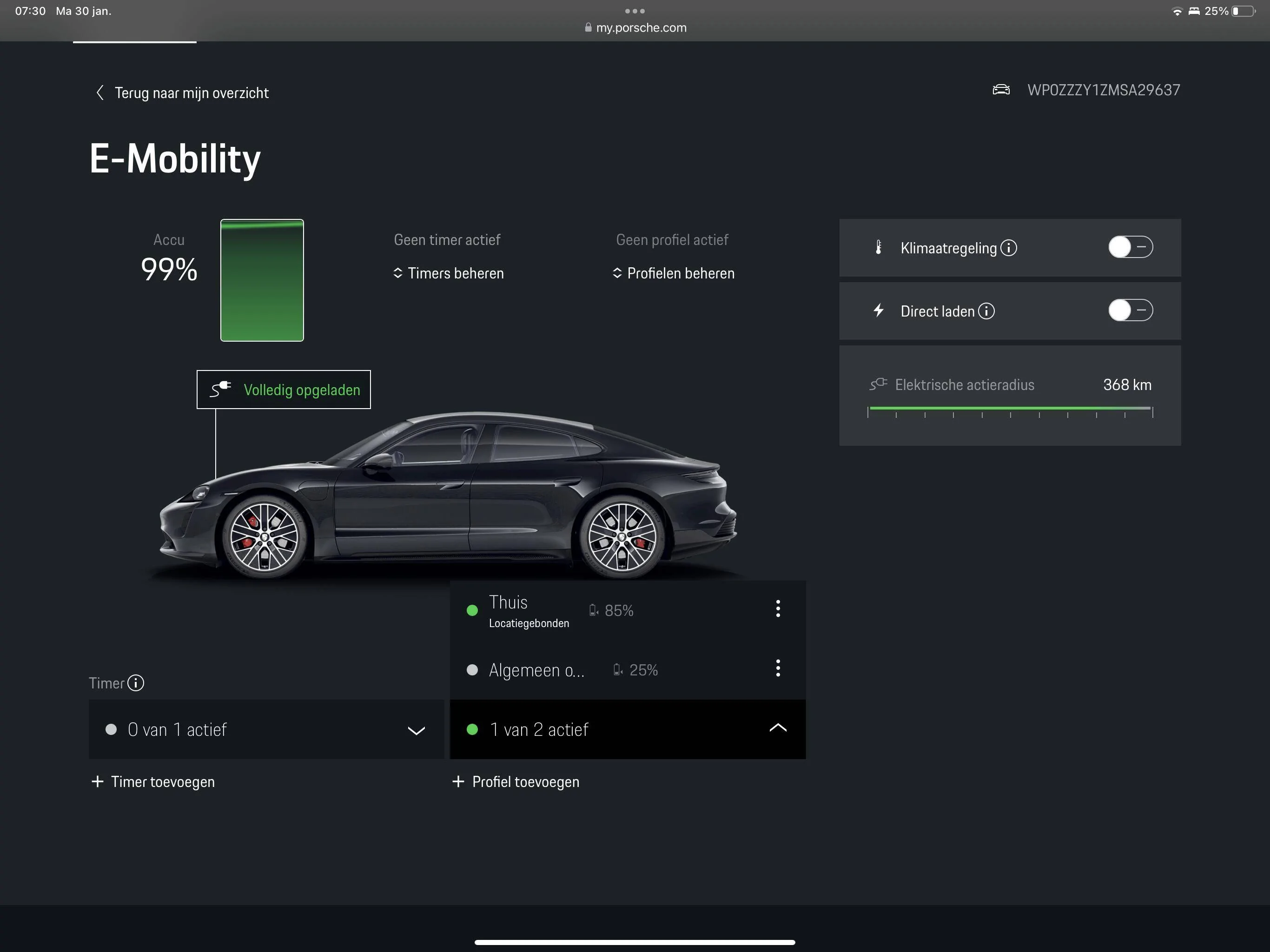

So i had setup a home profile active with minimum charge 85% (which I understood is Porsche’s way of meaning maximum charge) and this morning it was still charged 100% ?!? What am I doing wrong? Car was fully charged for 4€ though :p

So Sabine talks a long time and it’s still not 100% clear
charging profile > location bound, sets immediate minimum charging level and optional smart (cost effective charging) for the remainder. This does NOT set the maximum charging level.
for the Taycan to always stop charging at 85% you also need to set a Timer Profile, with a departure time (i.e. 08:00) on repeat for every day of the week.
only when both are active you will smart charge up to 85%
Last night I hadn’t set the timer, only the profile, so that’s probably why it didn’t stop @ 85%?
Is my understanding correct?
A profile alone can't be used to control charging. To ensure a charging session ends then you will need to include a departure timer and make it a repeating one.
When left to a profile and you don't disconnect the EVSE the charging session will pause for around 30 mins when your minimum charge has been reached and then continue to charge.
Better to have a sensible minimum charge of around 25% and a repeating timer with a target charge of 85%.
Yes
