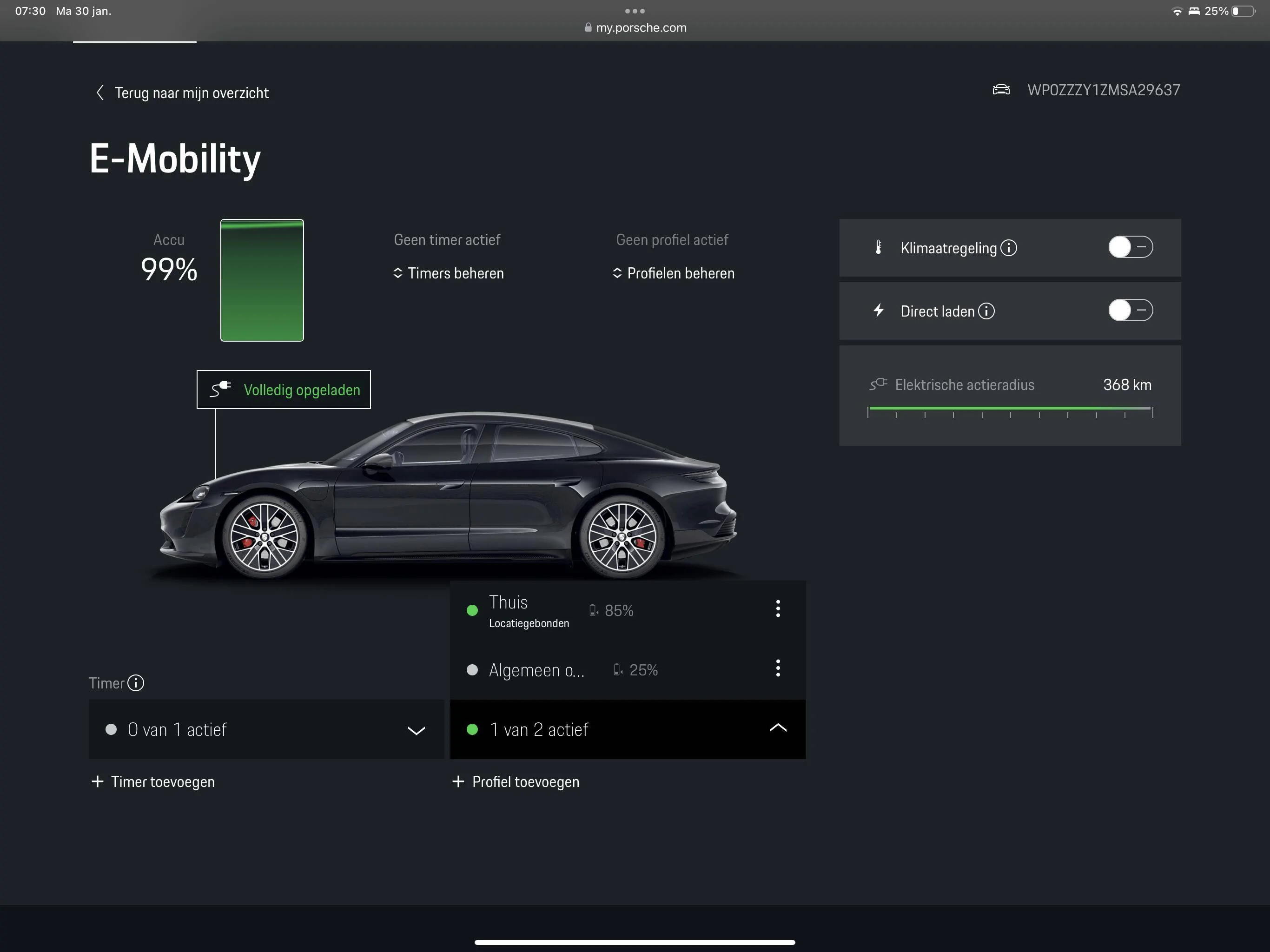

I do have an energy manager, see the screenshots on page 1,
the energy manager talks to the cars, the cars start charging when tariff is lowest, don’t need to do anything other than desired departure time (if any) and minimum soc. (if desired) the energy manager does the rest.

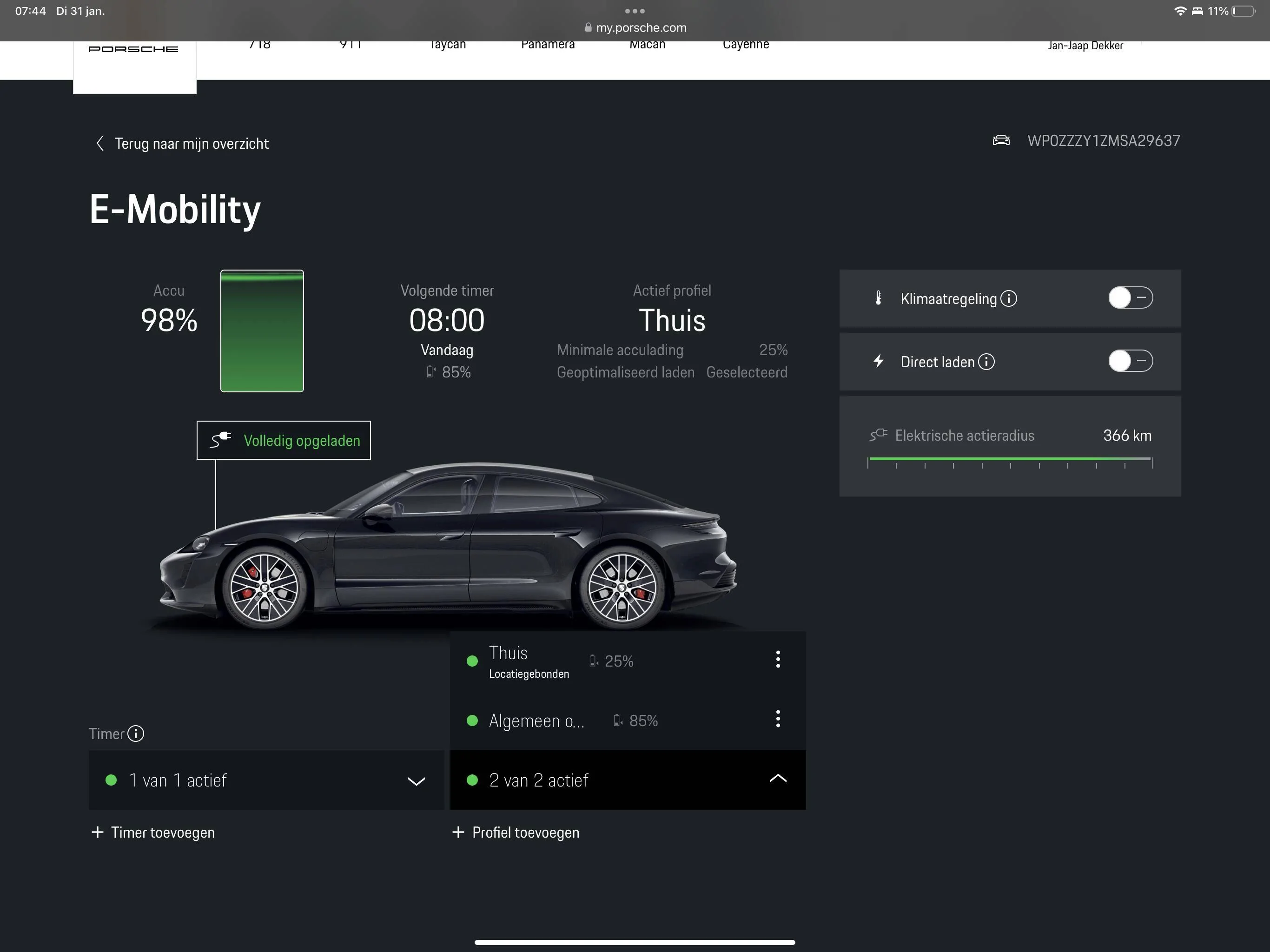

But it seems the app and car both have a different meaning of the word “active”
in my screenshot you see the lower part 2 profiles being “active“ (green) while on the top part it said one. After going in the car and checking the boxes it now shows correctly.
spot the differences:
so in order for it to be “really” active it should show both below the car and above the car.

The app mirrored the portal status, both were in sync. As far as I can see it now, it’s a sync glitch between car and API that you just have to make sure the profile is green, but also activated above the car, if not dissable/enable again. I think that’s were I went wrong before.
