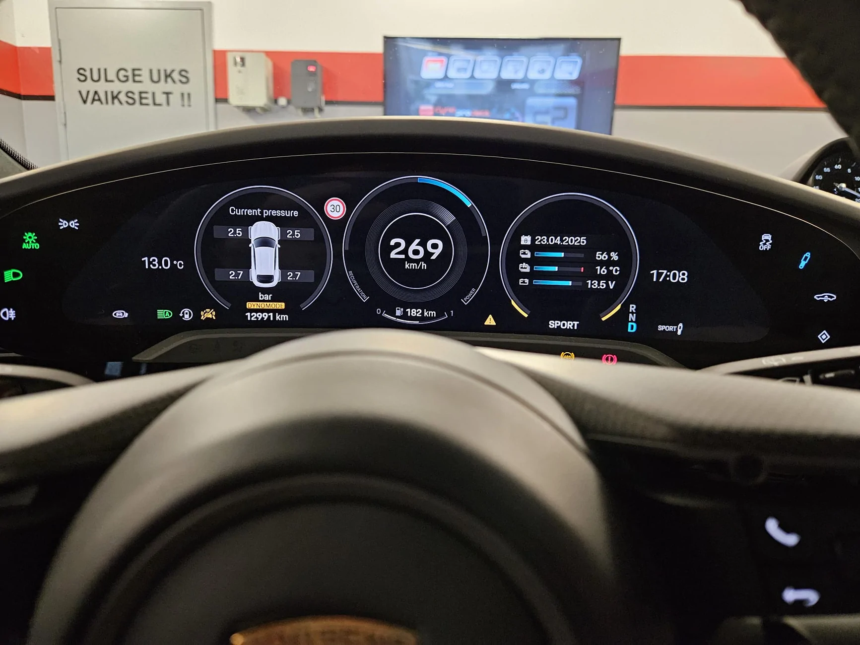

I can do it, but there is no point. The front and rear motors run at different RPM, so the only thing you can do is get a power graph by speed. No torque or anything else. This is only true for J1.1 though, J1.2 has SFD2, so forget about that one.
Also, strapping down the car properly means removing the rear bumper with all the grief that comes with it. You also need a dyno that runs with front and rear rollers hard locked otherwise they will run at different rpm.
I tested the VMAX limits on my dyno, but I did not put any significant load on it, and used the rear towhook attachment to strap it at the rear. I would not use that for full throttle acceleration.
