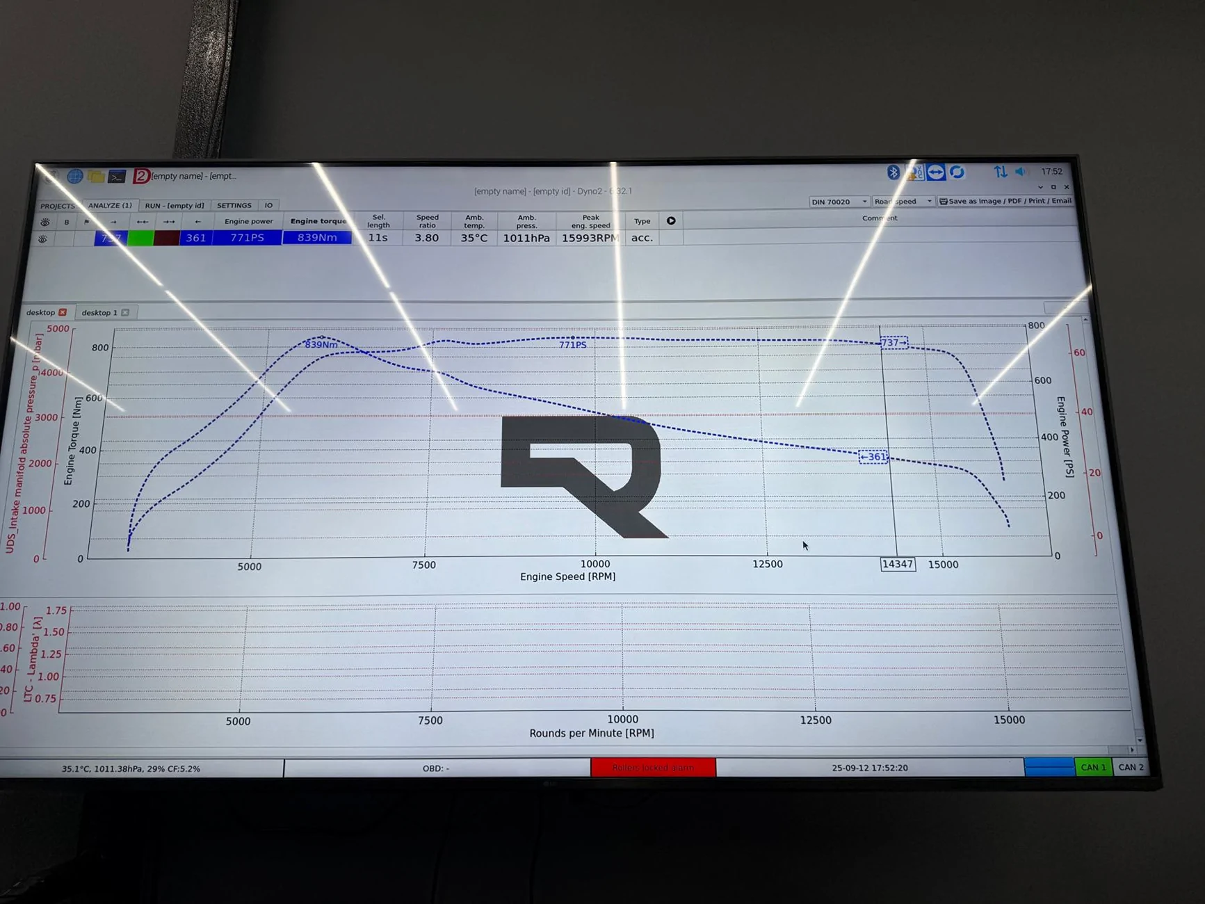

Quick question: Is the figure 800 PS for the J1.1 GTS the actual output from the combined engines, or is it the output measured at the wheels (like the J1.2 4S above; hopefully this :–)? If the latter, what is the actual engines output; if the former, what is the estimated output at the wheels?
It's the actual output. The motors know exactly how much power and torque they are producing at any given point, and I got the real world curves for the motors by testing the cars at full acceleration on the street.

Ok, that's still pretty low compared to AWD ICE transmission losses :–). You wrote above that the output from the engines on the J1.2 4S is 940 PS, and as it was measured to be 900 PS at the wheels on the dyno, the transmission loss is only ~4.3%. Do you know of any technical reasons for it to be slightly more on the J1.1 GTS, or would it likely be in the same range (4-5%)?
prj
prj
Jan 14, 2025
1,789
2,382
Estonia
www.mapev.net
Taycan CT 4 - 2026
I would take the dyno measurement with a grain of salt. Dynojet likes to read high as well. Would not make any conclusions from that about the losses.
The only thing I can be sure about is what the motors put out, because an electric motor controller knows exactly without a single bit of doubt how much torque the motor is putting out at any given operating point.
The dyno measurement is flawed, it is mostly useful to compare before and after results. It would have been good to measure that Taycan with a stock ASG and then with the tuned one, and note the difference.
The dyno plots are just there to confirm that I am not full of shit and making numbers up, like is common in the industry :p
