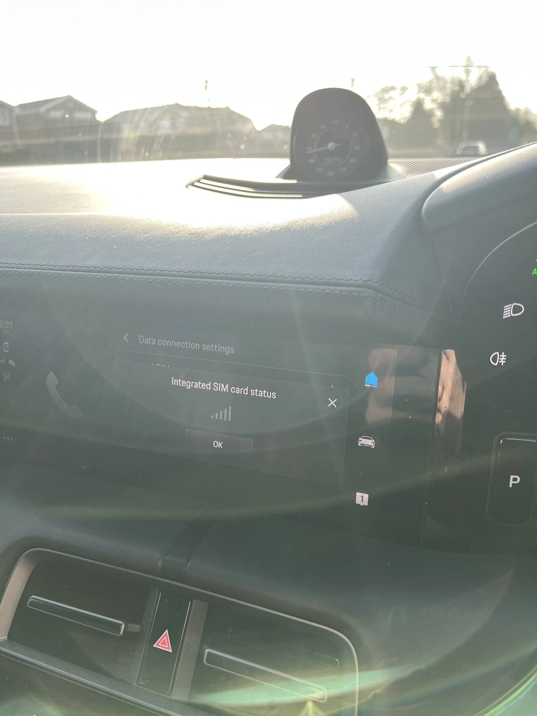

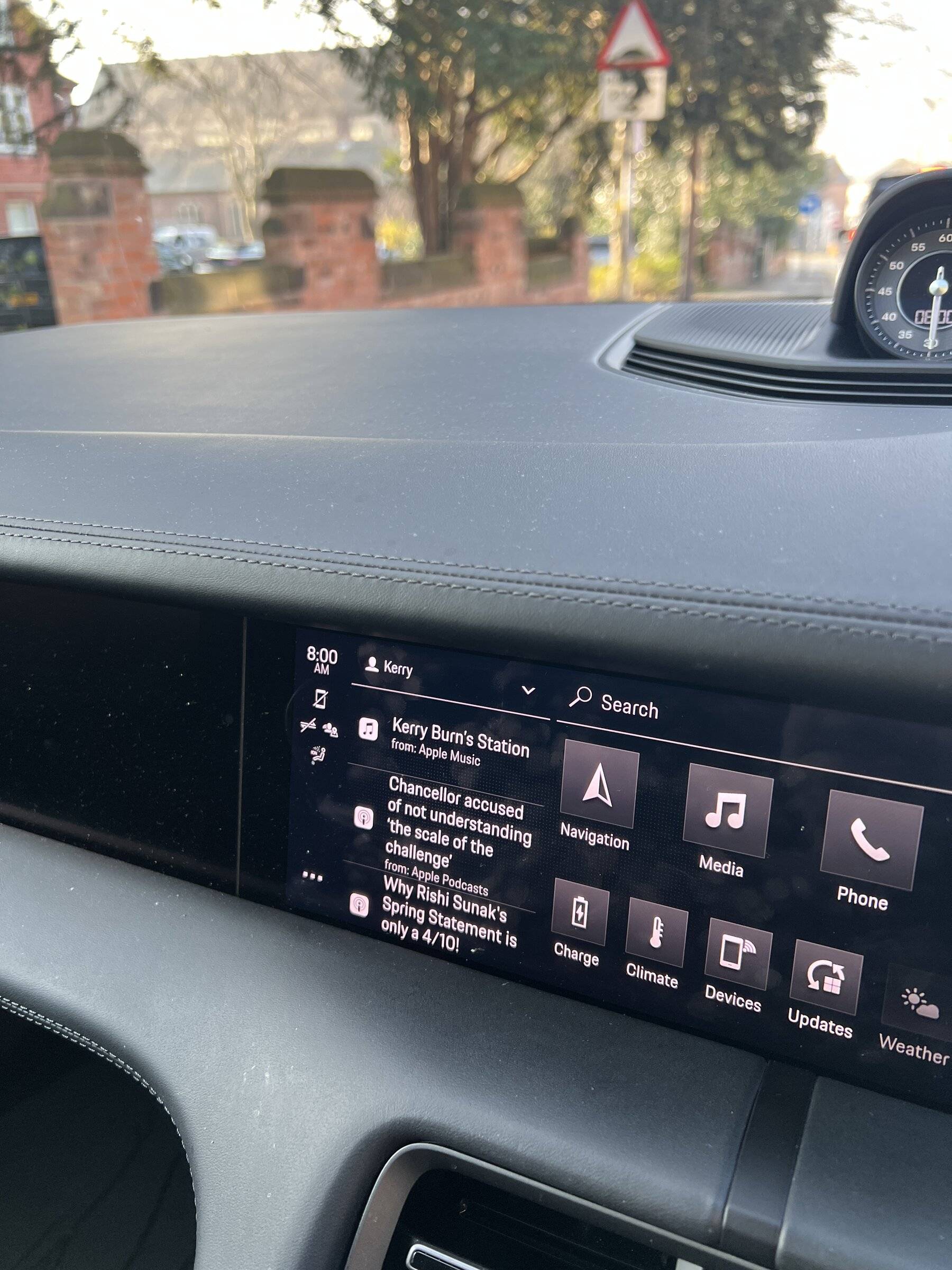

Hi guys
I thought I would post to glean a consensus from other drivers around an issues with my Taycan PCM
The issue is simple, on a regular basis (approx 2 to 3 times per week) I will get into the car and the on board SIM will not connect. This has the effect of preventing any connection to my IPhone rendering the bluetooth, car play, and any phone related function unavailable.
Related to this is the equally shite on board apple apps that constantly log out, do not sync properly, are generally slow and un responsive meaning that I have given up using them at all.
I run an IT company so I have a decent knowledge of software and despite the car being in the dealership twice, nothing has fixed it and the latest 'plan' is to replace the entire PCM system, something I am not keen on doing for any number of reasons.
Things I have already done :-
  1. Two finger reset on a regular basis, no effect
  2. Delete all connections on the phone and re pair, no effect
  3. Leave the car outside at night! on the basis that the signal (vodafone I believe) is constant, no effect
The problem resolves itself if I leave the car, let it shut down (approx 15 mins) and then go back, but it is utterly impractical and I am absolutely fed up of having to drive with AirPods on a regular basis, never mind the more recent laws that will ensure I catch a fine at some time.
Its utter shite, totally unacceptable on a car costing £160,000 and I wondered if I am alone with these issues.

It looks like your comms module / OTA module has an issue - this can be replaced. Without a reliable connection your Porsche Connect services won’t function reliably.
Connecting your phone to the PCM is not dependent on the internal SIM (this is reserved for Porsche Connect etc).
If you have paid extra (I hope not) for the monthly data package to use the internal WiFi Hotspot then connectivity for this could be impaired also.
I can see from the icons on the first photo that you had no cell connection which explains why some of your services aren’t working - weather icon is greyed out for example.
Either you have a pending hardware failure with the above module or something else is up with the PCM.
