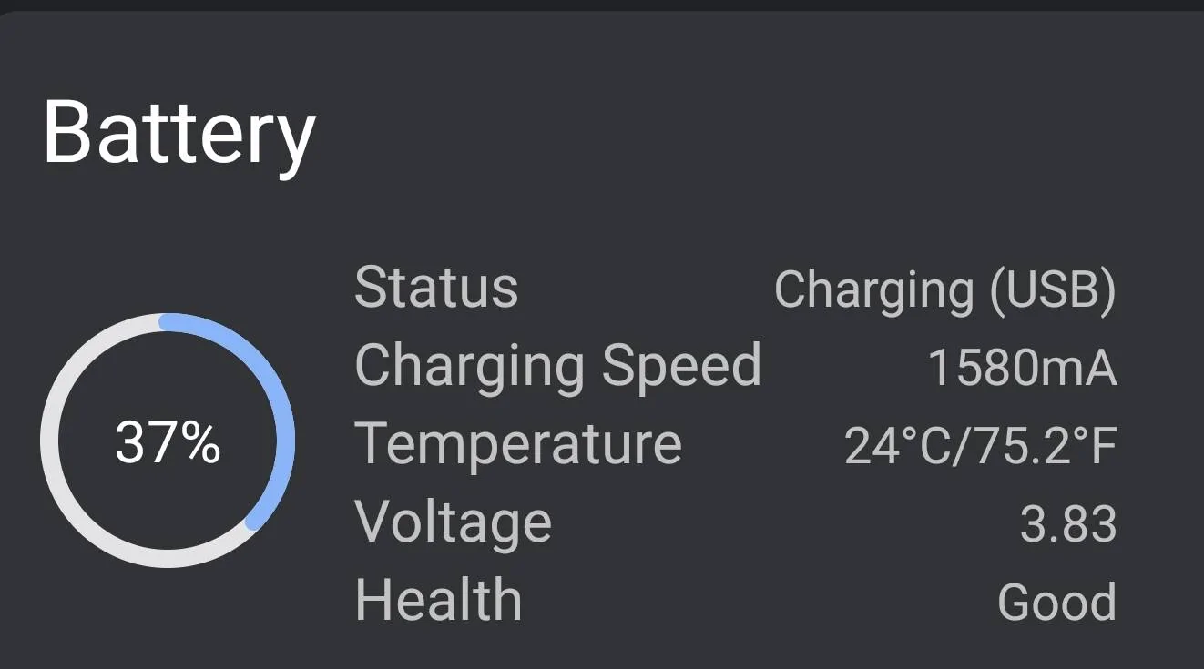

Ok definitely something not ok.
With my qc 12v cig charger (while wireless ly connected with AA, Spotify, waze, etc

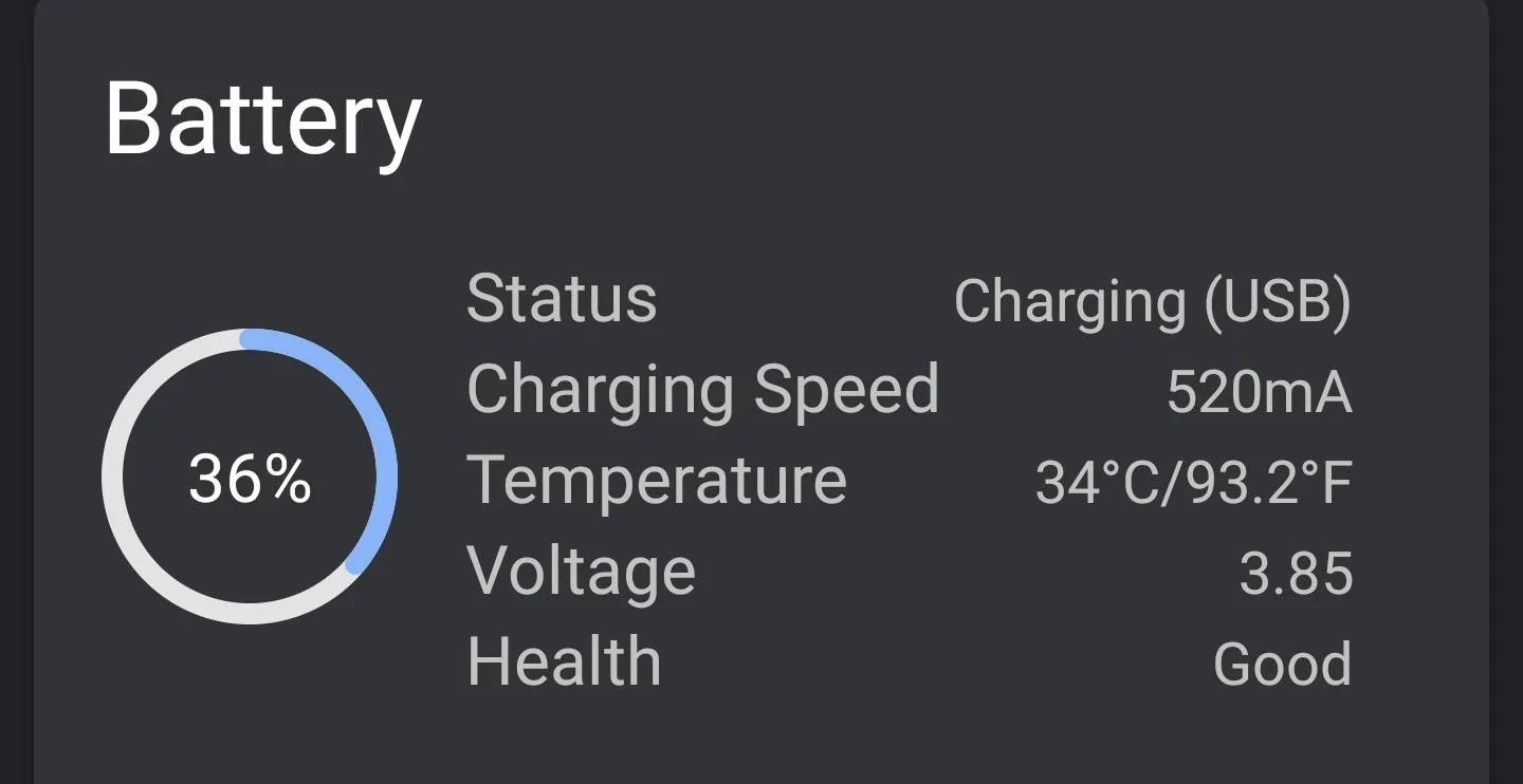

Then I switched the cable to the usbc ports in front
Porsche Taycan Phone charging inside the Taycan Screenshot_2023-05-24-12-17-26-87_9e44329adecb79d6f3bd5aadb98a4182
So basically negative gain with the usbc
Couldn't test "charging only" as the car keeps forcing going into media mode whenever I changed to charging only on phone.

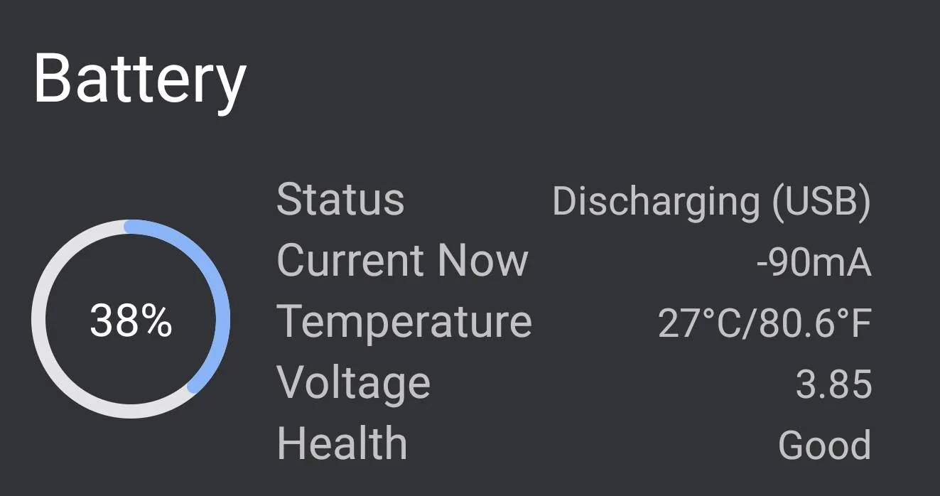

Finally, using the back usbc
Porsche Taycan Phone charging inside the Taycan Screenshot_2023-05-24-12-24-41-93_9e44329adecb79d6f3bd5aadb98a4182
Not great but okish
