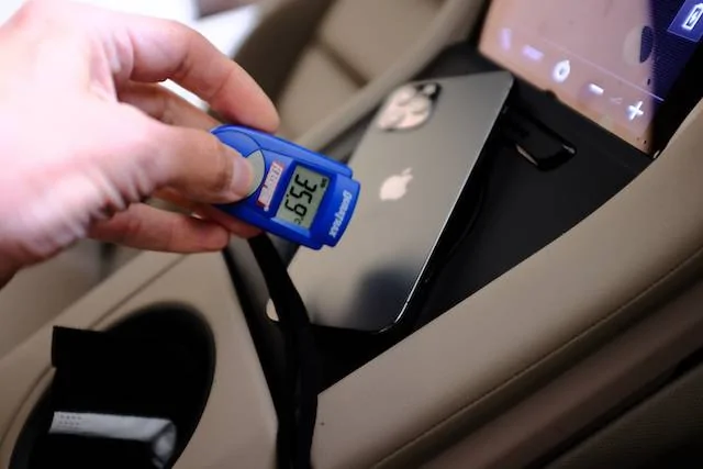

Got my 4S to charge my iPhone 12 again today -- thanks for the advice. You have to find the exact happy place for the phone. It's finicky but it works.
This is a bit strange though...
I think tomorrow I'll cook some chalupas. :)
(That's about +97F for my American friends)
