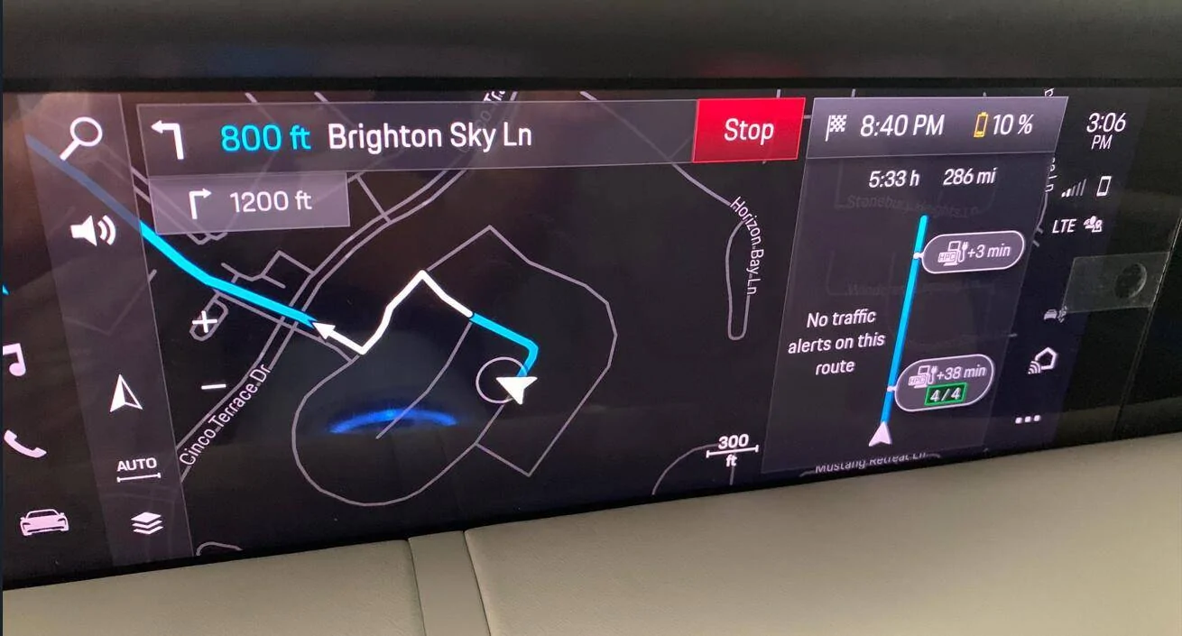

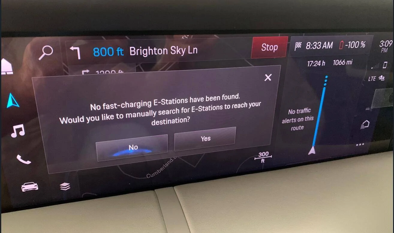

You got me curious, so I had to out to the garage to give it a try. Previously, I tried a location, where there's a nearby EA station, so it finds it right away, and added it. On a different destination, it initially set the SOC to a negative percentage as you said, BUT if you give it a minute or so, it will find (more below), and add it to your route. On a third destination, I waited, and then I got this. In short, you just need to give it some time, and it'll find and add the charging stations for you if it can find them.
Porsche Taycan POLL: Is your Taycan missing the Charging Planner 1650399360648
In this instance, it was able to find a couple.

i waited for a good 3 minutes but my PCM nav still won’t add any charging stops and still shows negative battery%.

I wonder if it's related to your LTE signal. If so, maybe the signal is either weak or non-existent. You should try it when your car is at a location with a good signal.

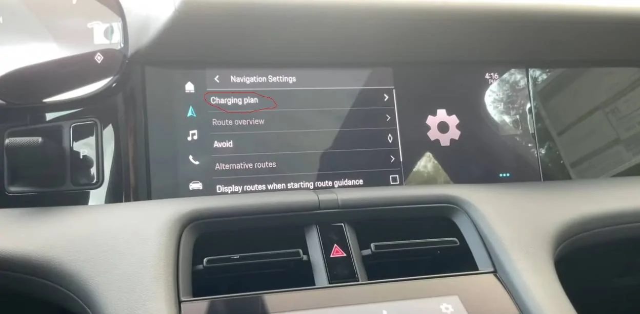

Porsche Taycan POLL: Is your Taycan missing the Charging Planner charging plan
I just want to make sure everyone is on the same page. After clicking the 3 dots at the down right corner in the PCM nav screen, everyone's taycan is supposed to see either "charging plan" as shown in the above picture or "route option". Mine and several others are missing the "charging plan" and "route option"

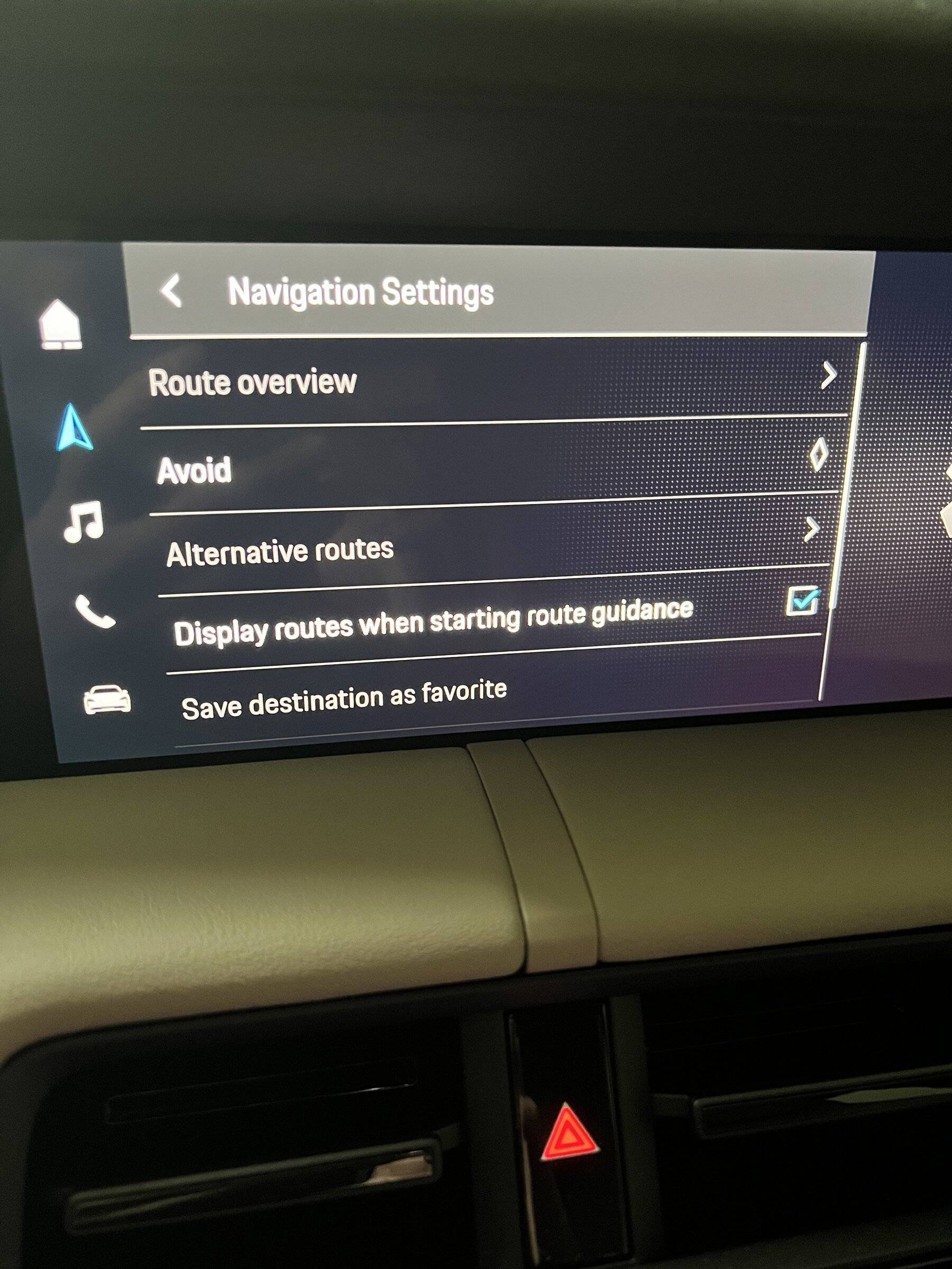

Porsche Taycan POLL: Is your Taycan missing the Charging Planner 01E04DFB-618E-4C50-AB74-098090C8D465
Above is what mine looks like, missing charge planner and route options.
