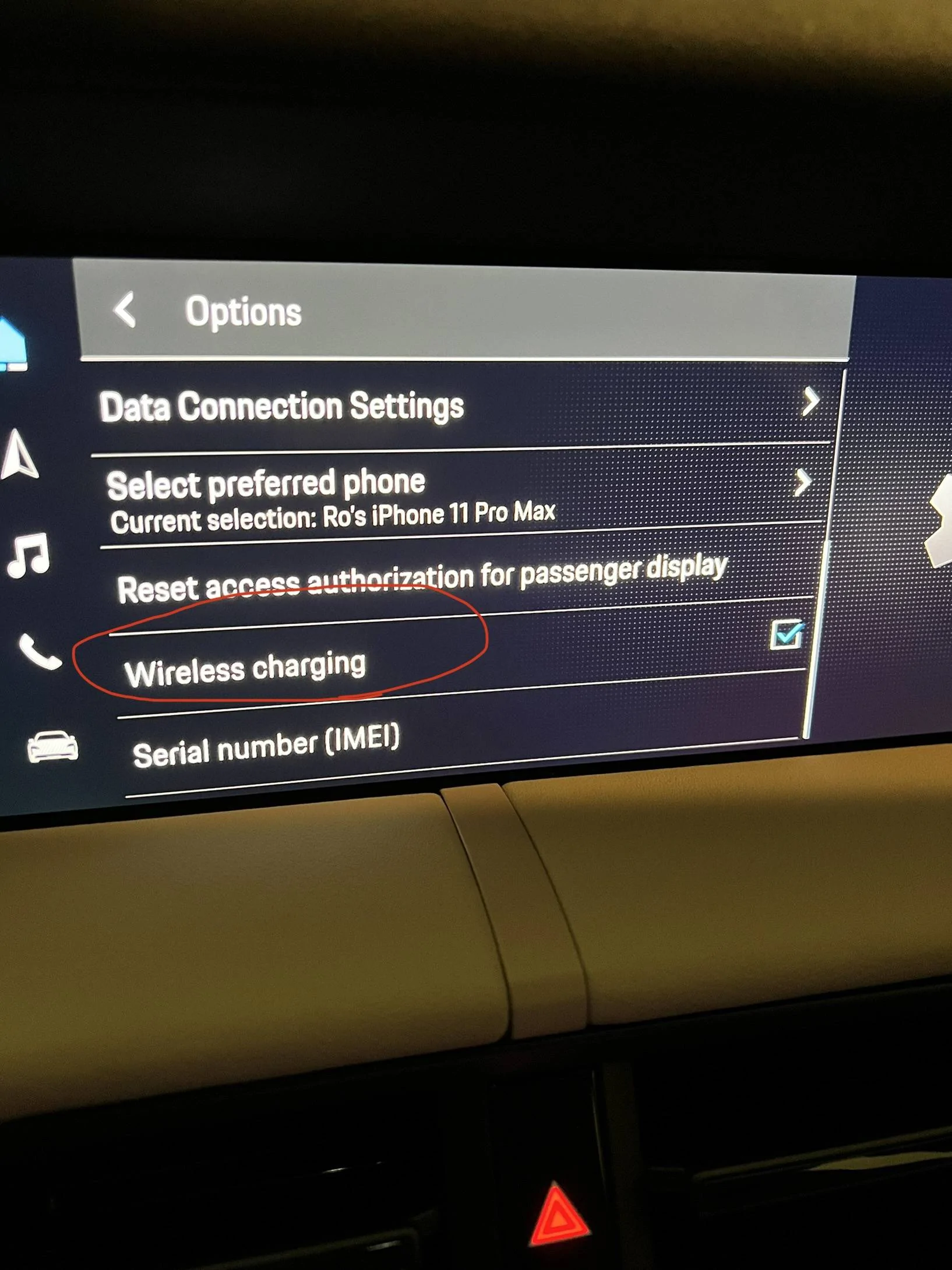

Speaking of charging, do people have the wireless charging working on their recently delivered cars? I don't have the option to "turn it on" and placing a phone in there doesn't seem to work.
Mine works. There’s no option to turn it on. Make your case is not blocking it. Make sure the back of your phone is facing the side of the center console.
Go to settings -> Phone -> check "Wireless charging"
It usually takes about 3 seconds for my phone to start charging.
Porsche Taycan POLL: Is your Taycan missing the Charging Planner F83E8938-7376-46ED-A52B-A875870FF79F
