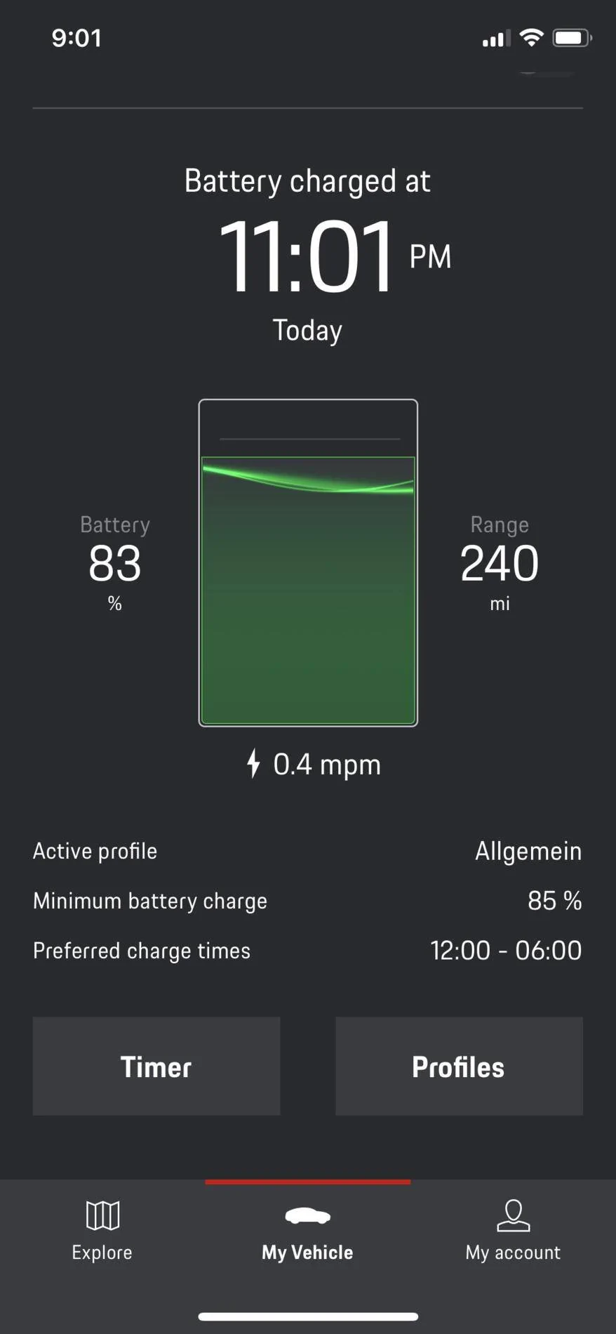

The Porsche Connect App is really terrible. Outside of the app, being woefully slow, there are 2 glaring issues wrong in the image.
1. According to the charging profile, charging shouldn't start until midnight but my car is currently charging.
2. The charging profile name is in German and I am unable change the name.

Your profile is set to "minimum charge 85%". Therefore regardless of preferred charging time settings, it will bring the charge up to 85%. Then wait until Preferred Time to further charge.
Seems to be "behaving as designed" in that respect.
Slow? Yup. It definitely is.
Profile name in German. Seems like a bug.

Interesting. How do you prevent it from charging higher than a certain percentage?

Stupid question @EVOG ...
are you sure it’s not because the time you entered is 12pm to 6am rather than 12am to 6am.
I don’t have the app but is 12:00 on the above just 12pm?
should he app not be set to 00;00 to 06:00 to force overnight?

That's 12:00AM - 6:00AM.
