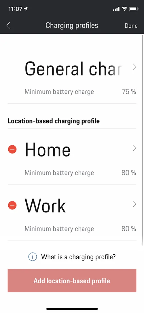

Sure, this is my home profile. At one time I even found the car charged to 100% at home.....
The default profile on the top of the screen? can you post it also.. I can see to top on the picture also..

perfect this should make the car charge to 80% in home and work and 70% elsewhere.. do you have any time profiles as well?
Nope, no other profiles. But as I said timers are not working at all, while the should charge up-to 80% works... somewhat. One time it did not work for sure.

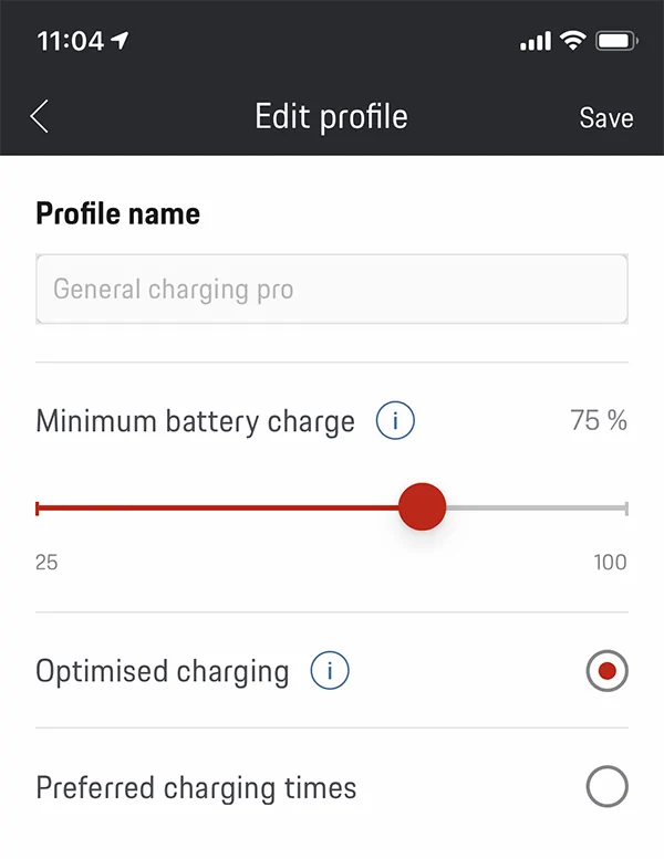

Correct me if I am wrong, but I don't think there's a way to limit the charging from inside the car at all. The only way I have found out so far, besides getting the plug out obviously, is to create a location based profile and limit it there. In the app the limit is described as "minimum charge level" but I do believe Porsche means top level to which you'd like to charge.
Tesla's way of doing this is so much simpler to be honest....
