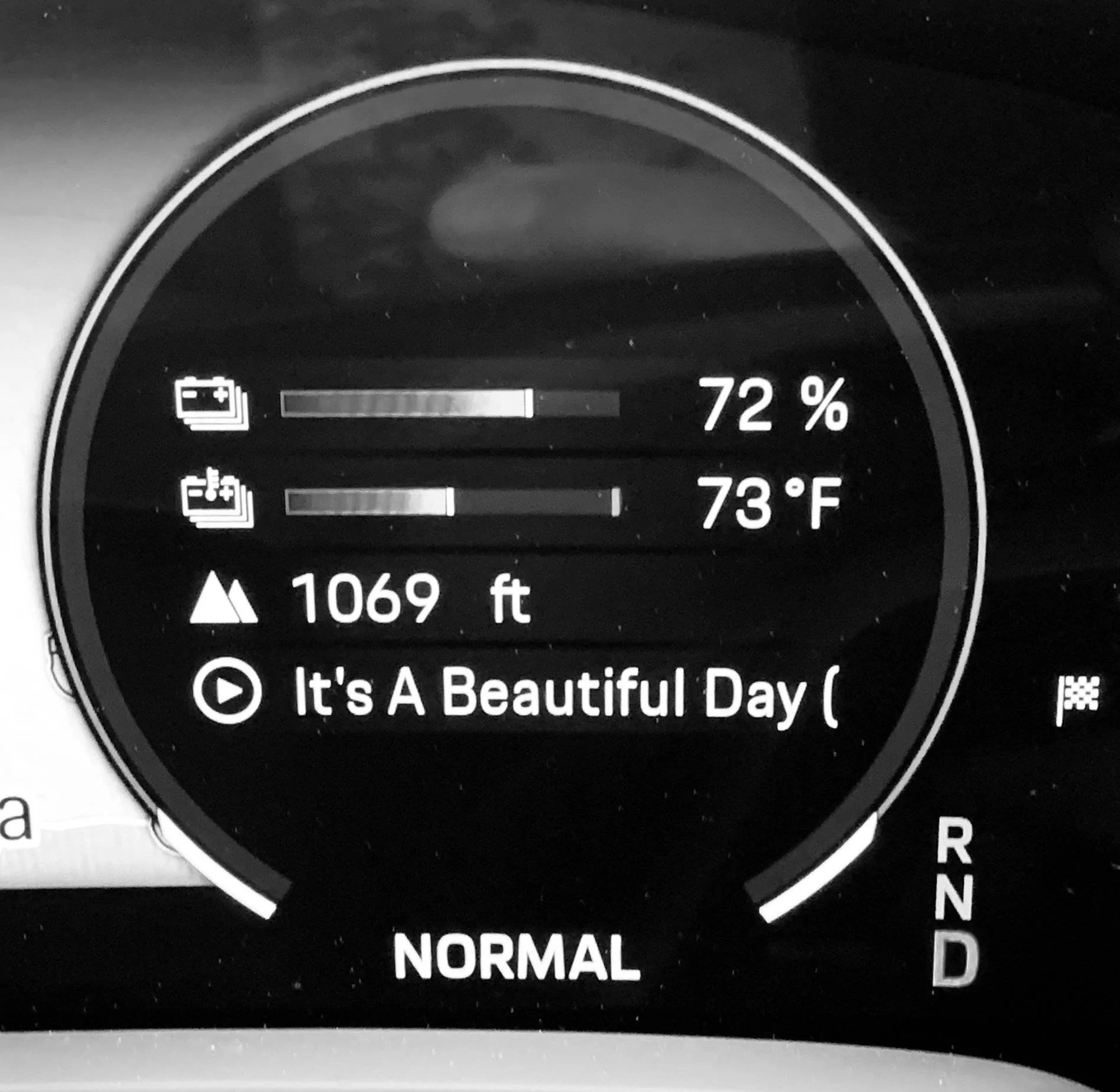

just in case, where can you see the battery temperature, please?
Tx!

Hello,
Tx!
It’s a configuration option for the right hand dashboard Info display.
In this photo it is at 73°F.

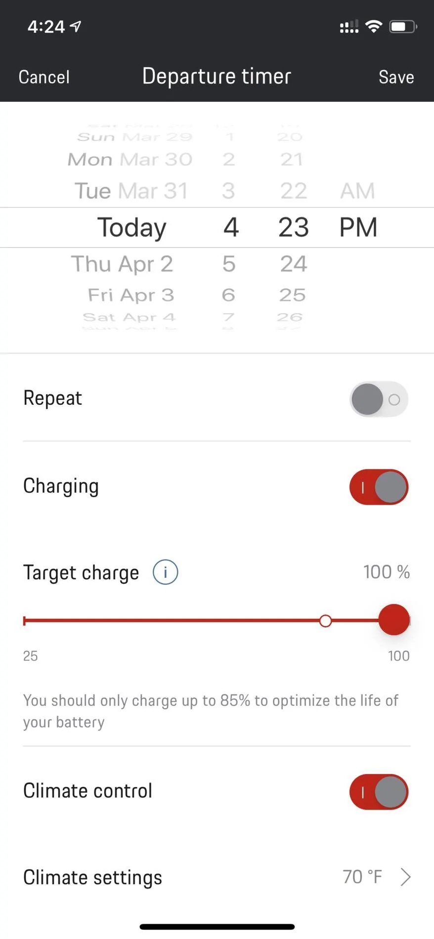

I knew I had seen a maximum charge SOMEWHERE... but I forgot where. I don’t yet have a home charger so all my charging so far has been at public chargers.
ok... here’s where you set maximum charge: In the TIMER. (Not at all obvious)
Set up a Departure Timer. In there you specify the target maximum charge.
