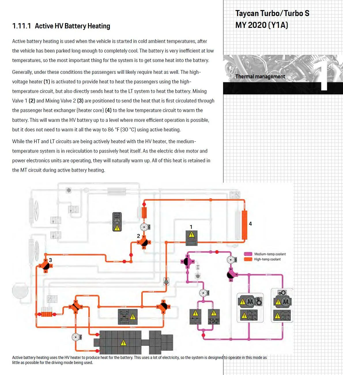

I hadn't driven my car for 4 days and it has been cold here and it was covered in ice.
The battery temperature was 3C and charge 77%
I plugged the car in and set the 1 hour preheat though I was actually leaving after 30 minutes.
My dispenser was delivering 7.2 kW, after 30 minutes the battery had been heated to 14C but the charge level had dropped to 75%.
The Webasto heater is rated at 10kW iirc so it looks like it was running flat out heating mainly the battery using more than the mains was dispensing so using a bit of the main battery as well.
My J1 CT 4S did this, it preheated the battery to +13c exactly and every time in winter, from various cold temps -7 to +5c, whenever a departure timer and preheat was set -plugged in or not plugged in. When not plugged in (most of the time) it would use 2-4% of the SoC.

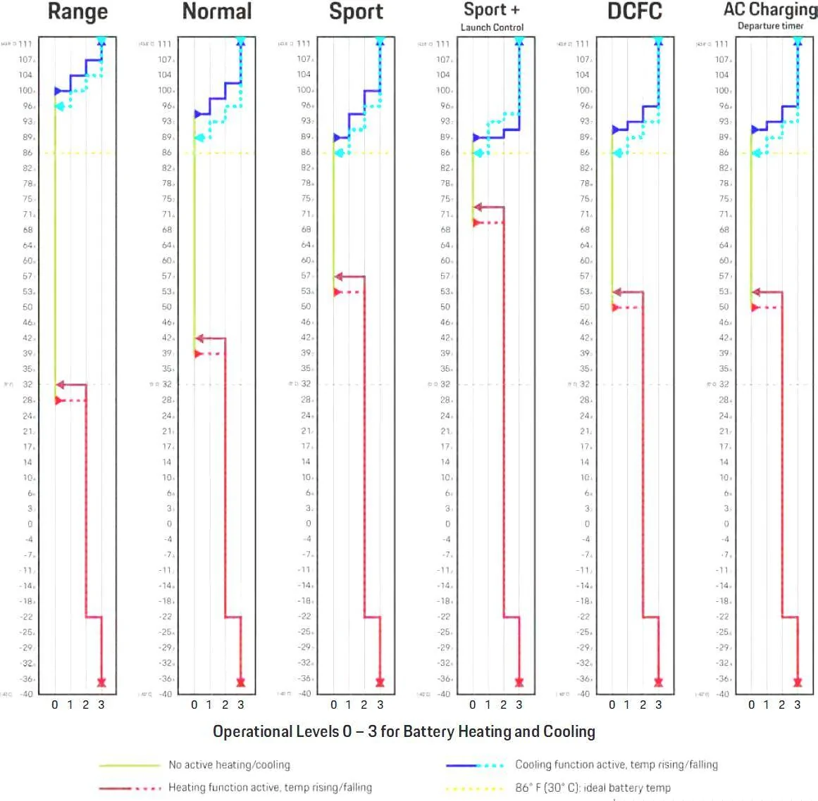

I tested that last winter: range mode vs sport plus.
The heater didn't start in both cases, although batt. temp. was low.
https://www.taycanforum.com/forum/threads/high-consumption-after-first-start.19015/post-293604

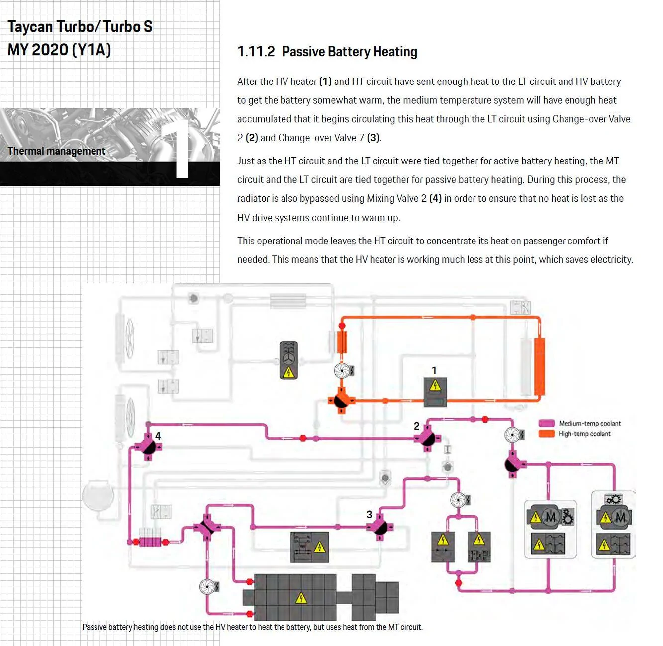

It's possible that above 9C battery temp that you reported, the car switches to passive heating. Note that in Range and Normal, 9C (48F) would be within target range, so heating would not even be triggered. From my experience driving other EV (not just Taycan), the quickest way to warm the battery is to do some launches (or as close as you can get). I used to use it if I ever had to DC charge a car after parking in freezing temps, as DC charging a frozen battery can be real slow (though I usually try to avoid that, charge after the arriving at night and maybe top off in the morning before setting off for the next segment). High power acceleration generates more heat in cold battery and motors than the heater could provide, and car can use that heat.
