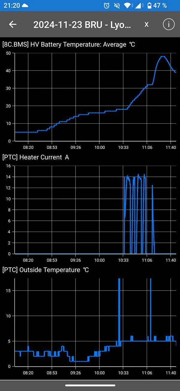

Did you ever get a chance to see how much power the heater used with CarScanner
last week trip.
outside temp between 2° and 5°, initial batt. temp. at 4°.
batt. temp. slowly warms up to 18° in about 2hrs drive (on highway), then heater kicks in about 30mn before charging stop to raise batt. temp to 32°. jump to 50° is due to DC charging.
in terms of %, heater roughly used 5% to 6%, so 12 to 15km range less.
ah yes, air co was off, so heater wouldn't start to warm the cabin. it was pretty cold inside ... I wanted clean measurements ?‍♂

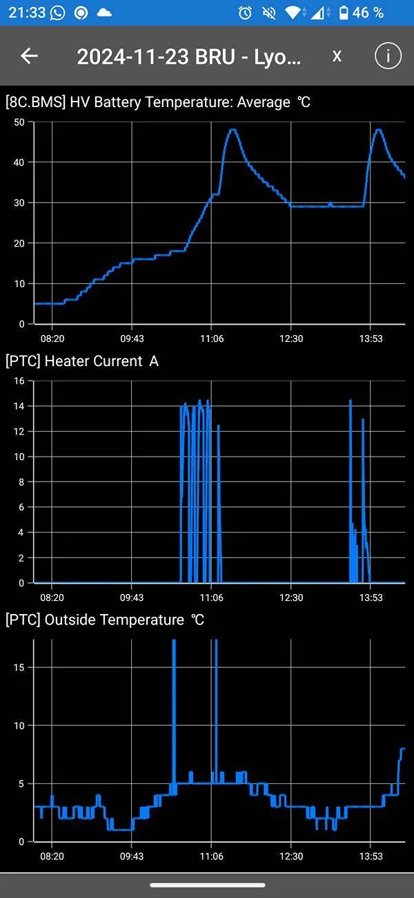

batt temp. then went slowly down to 29° (still cold outside), heater briefly starts before 2nd stop.
car was in Normal mode. I don't think Sport Plus would have triggered the heater earlier. I'll check that next time to be sure
