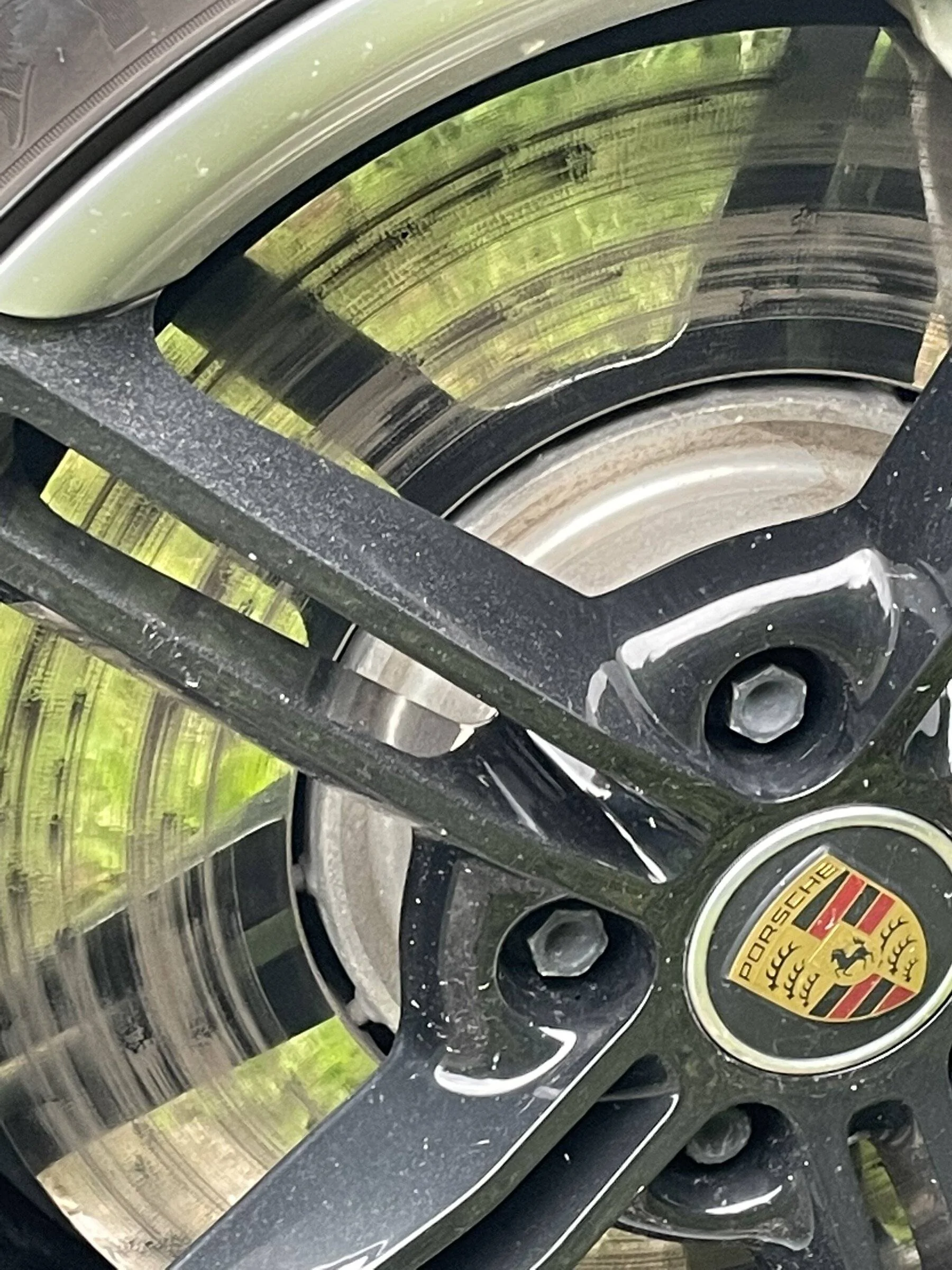

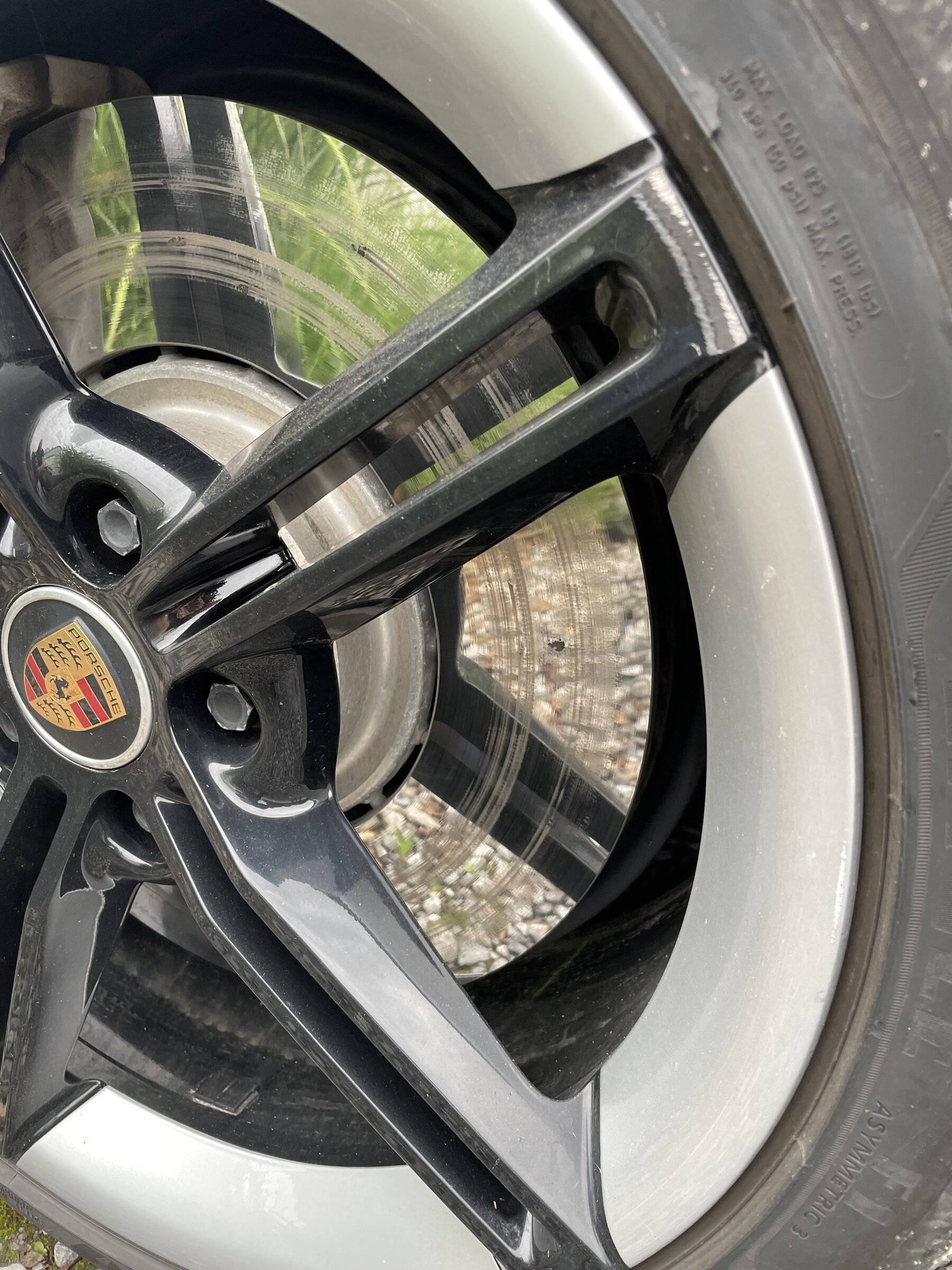

dmermans
Dirk
Jul 22, 2021
Taycan Turbo, Model X, Renault Master
This is how they look after almost 2 years and 53 k km
Porsche Taycan PSCB Brakes 74781959-1355-4002-BC60-93AA08D43E04
Porsche Taycan PSCB Brakes 5D127D3E-C014-41B0-8447-C462515F73AD
