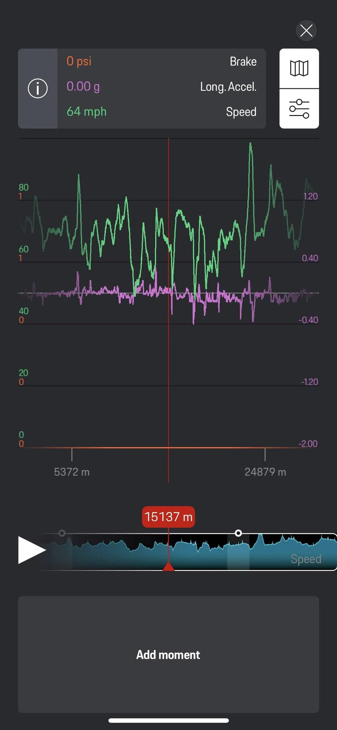

I guess what I was clarifying was like you said system hydraulic pressure, and not pedal pressure. You could have a fair amount of pedal force without mechanical intervention, but system pressure would obviously correlate with mechanical braking. Agree?
It shouldn’t need clarifying, tbh.
“Pedal pressure” would never be quoted in psi because it is actually a load and to call it a pressure is a mis-use of English. It would be Lbf or Newtons.
It is conventional in all braking data logging I have ever seen to quote the brake data as pressure in the hydraulic system in psi (in the old days) or bar (now).
The fact that the pressure in the hydraulics remains zero means definitively that the friction brakes are not being used at all on this data recording.

If it helps clarify further, here's a data trace from a longer driving event, about 17 mi over a mountain pass. @daveo4EV may appreciate this one as it's in his backyard - hwy 17 from Los Gatos to Santa Cruz. There's a few braking events around 0.3-0.4g but friction brakes not used once.
hmmm no friction brake usage at all
just like porsche says
