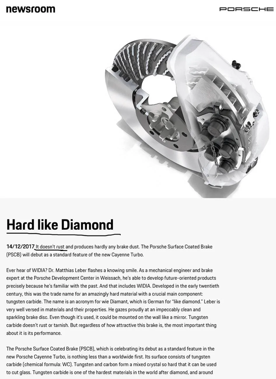

I’m currently in dispute regarding a PSCB fault.
While in for the UK ARB6 recall, one of the 8 disc surfaces was found to have corrosion - others all fine. The problem is on the inner left rear disc.
The problem wasn’t detected at the 4 year service and MOT safety test 6 months ago.
Since only one of the 8 surfaces is affected, I believe there must be a manufacturing defect in the application of the tungsten carbide coating. Porsche markets PSCB claiming ‘it does not rust’ and will extend durability by 30% - my car has done 29,000 miles.
The dealer refused to submit a warranty claim stating this would be refused by Porsche because they would regard the condition as normal wear and tear.
Illogically, since only one of the eight surfaces is affected, the dealer said the problem could be caused by not braking enough; braking too hard too often, or too much braking when the discs are cold. Astonishing!
I raised a warranty dispute with the importer, Porsche GB, two weeks ago. So far no response.
This is on top of the UK regulator advice which effectively means that there is no safe location available to charge the car. After relaying this advice in the ARB6 recall letter, Porsche then countermanded it saying I could charge in a garage or car park or near buildings if I did not charge above 80%. When I queried this contradiction with the UK regulator, DVSA, they advised I should ignore the relaxation notified by Porsche and their advice stands - “we would advise not to charge the vehicle under cover and/or to ensure the vehicle is not parked adjacent to or under buildings while charging”. Effectively that means that the car cannot be charged.
So the car cannot be charged and even if it could, the brakes have failed.
I’m waiting for a response from Porsche on the brakes, the ARB6 charging requirement and whether the car has been switched from ARB6 to ARB7. The car has been with the dealer since 9/4/25. The Taycan has been away from me for 4 of the 23 months I have owned it. Fortunately I kept my Cayenne. At 37,000 miles its standard brakes are fine.
“It doesn’t rust”
Its surface consists of tungsten carbide (chemical formula: WC). Tungsten and carbon form a mixed crystal so hard that it can be used to cut glass. Tungsten carbide is one of the hardest materials in the world after diamond, and around ten times harder than gray cast iron”
Porsche Taycan PSCB Service Life and Replacement Cost IMG_4084
“It doesn’t rust”
Hello! What came of your PSCB warranty claim/denial on them rusting?

@chun Good timing.
After 8 weeks of wrangling, and lining up the services of an automotive metallurgist expert witness, a compromise settlement has just been agreed. I should get the car back next week.
