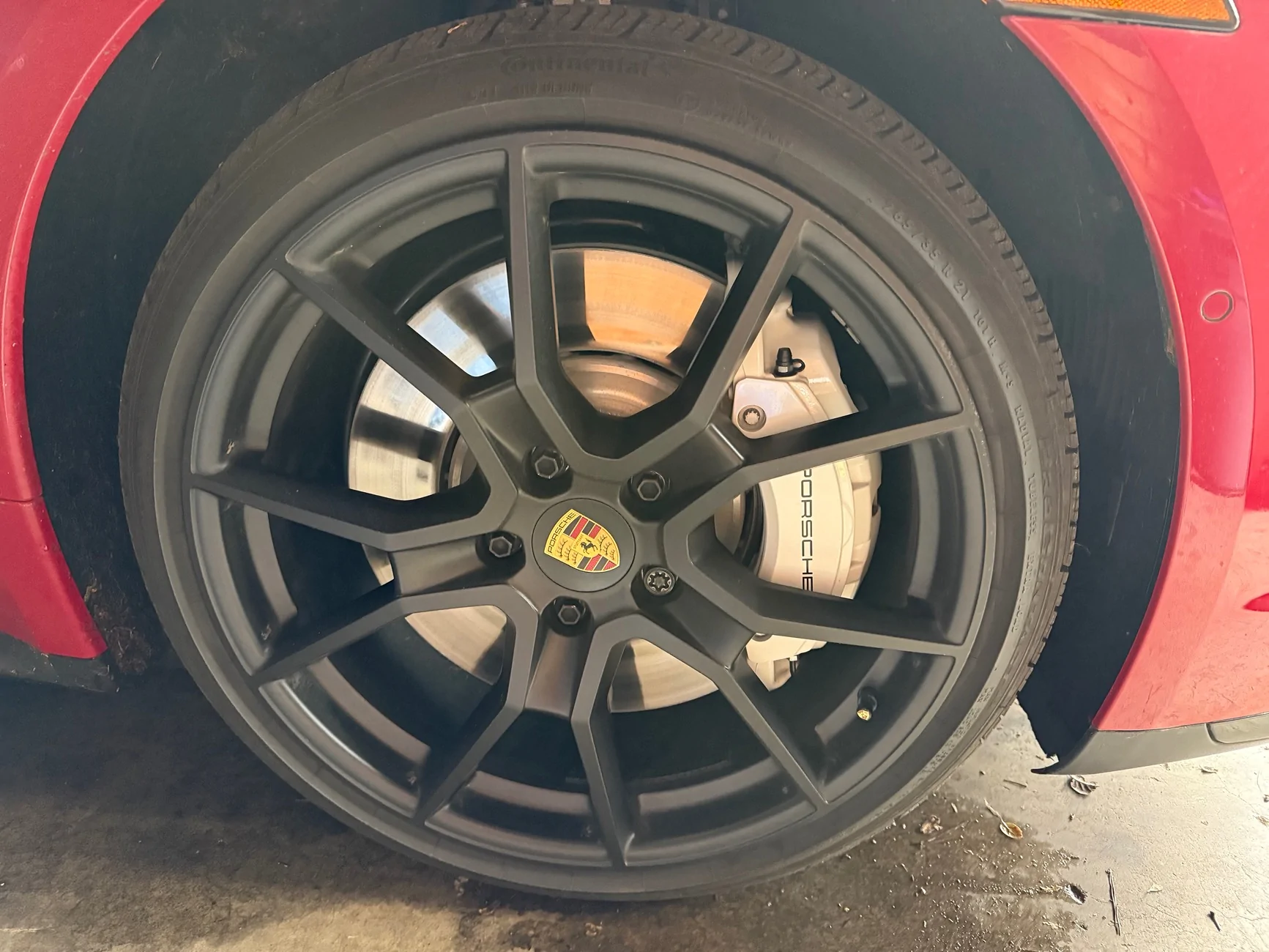

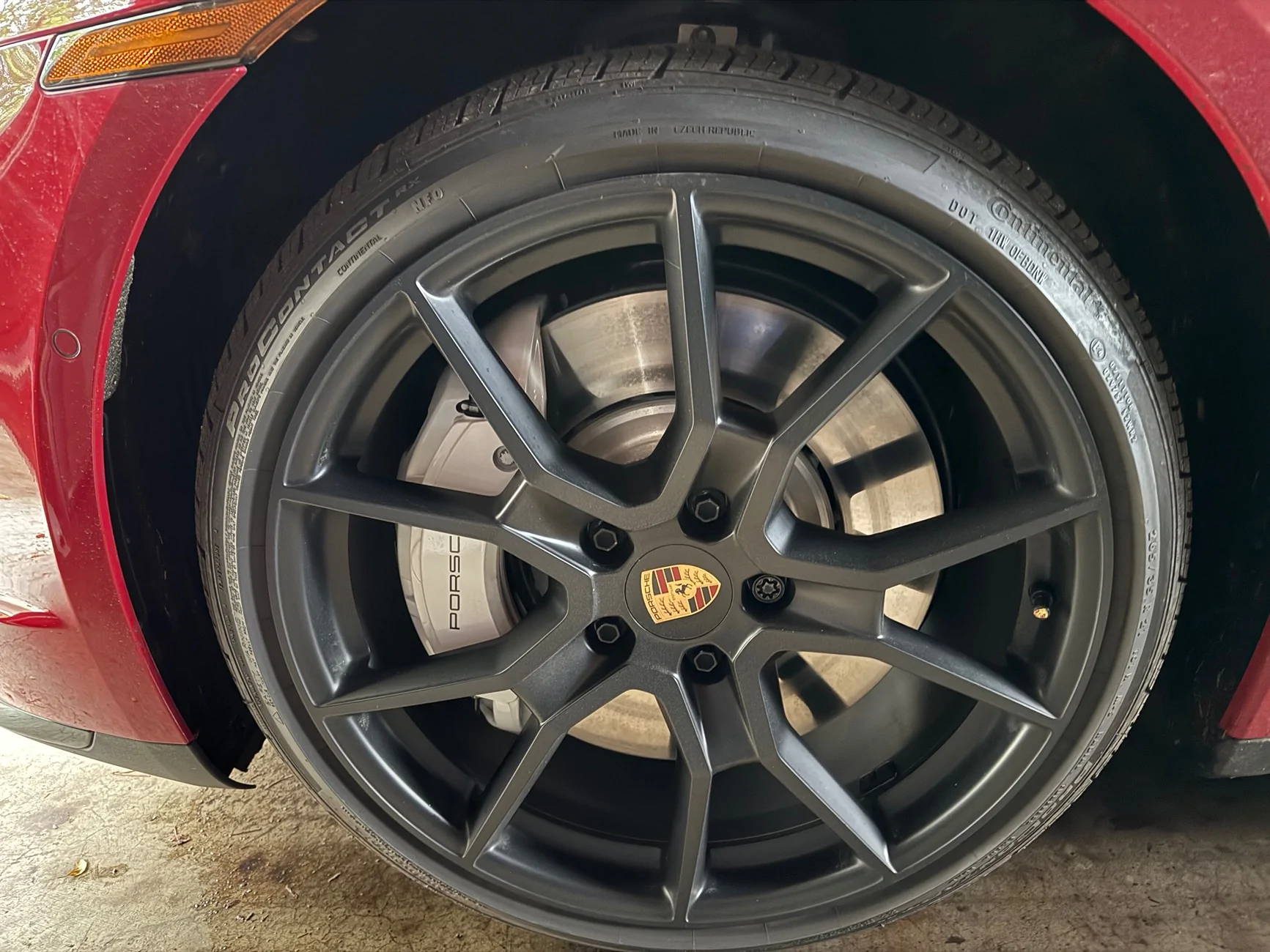

I’ve been driving the new ones very gently, no hard stops yet.
Around 1K miles so far.
Porsche Taycan PSCB: Slight scraping sound from front left wheel when in motion IMG_5952
Porsche Taycan PSCB: Slight scraping sound from front left wheel when in motion IMG_5951

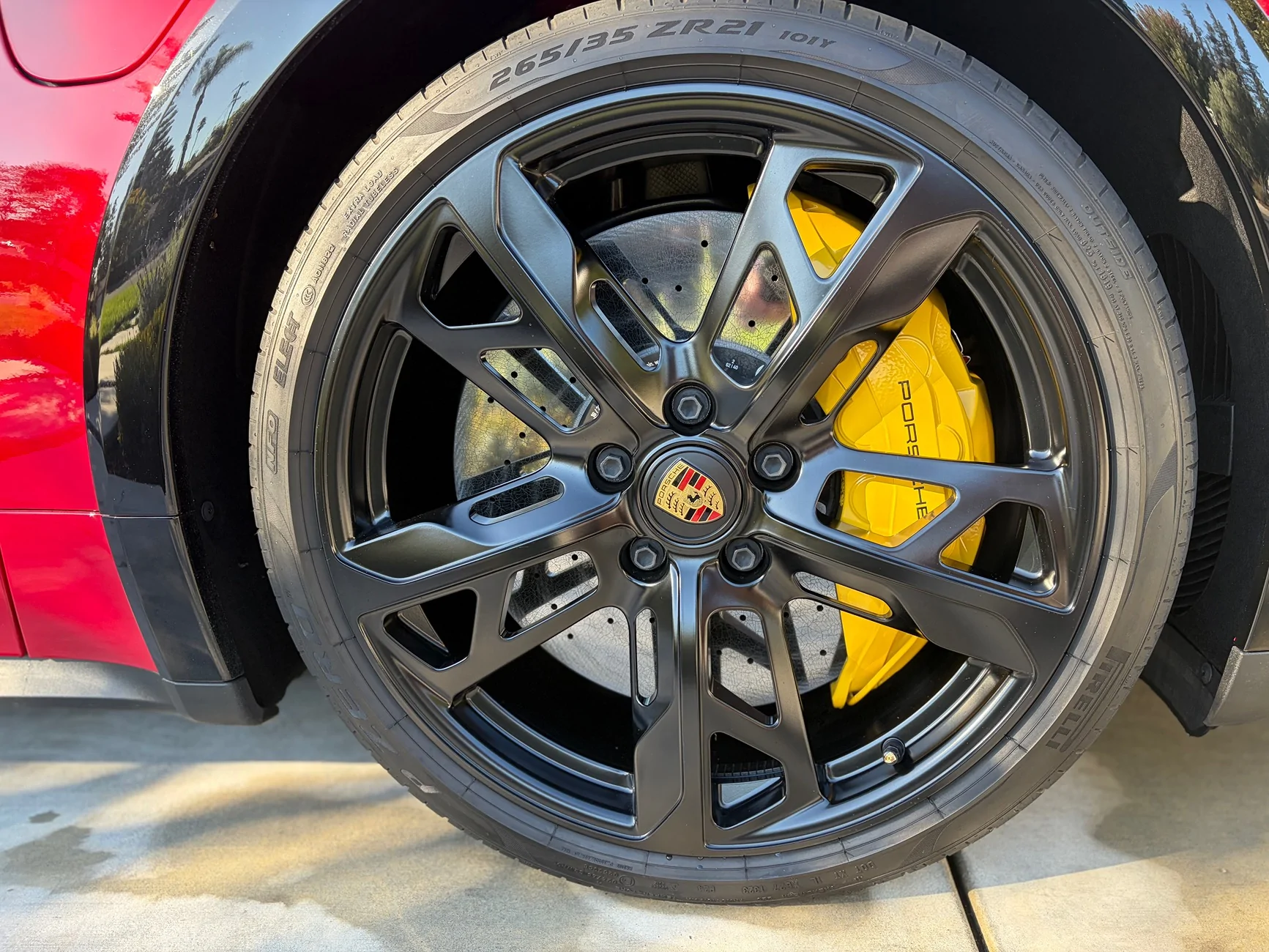

Are you sure”? Physically they don‘t look the same. I have looked at pictures above and my PCCB calipers are much bigger than what @DerekS posted
Porsche Taycan PSCB: Slight scraping sound from front left wheel when in motion IMG_0127
ct14garage
Cris T.
Apr 17, 2025
501
907
Thailand
ct14garage.com
Taycan Turbo S and 970 S Hybrid

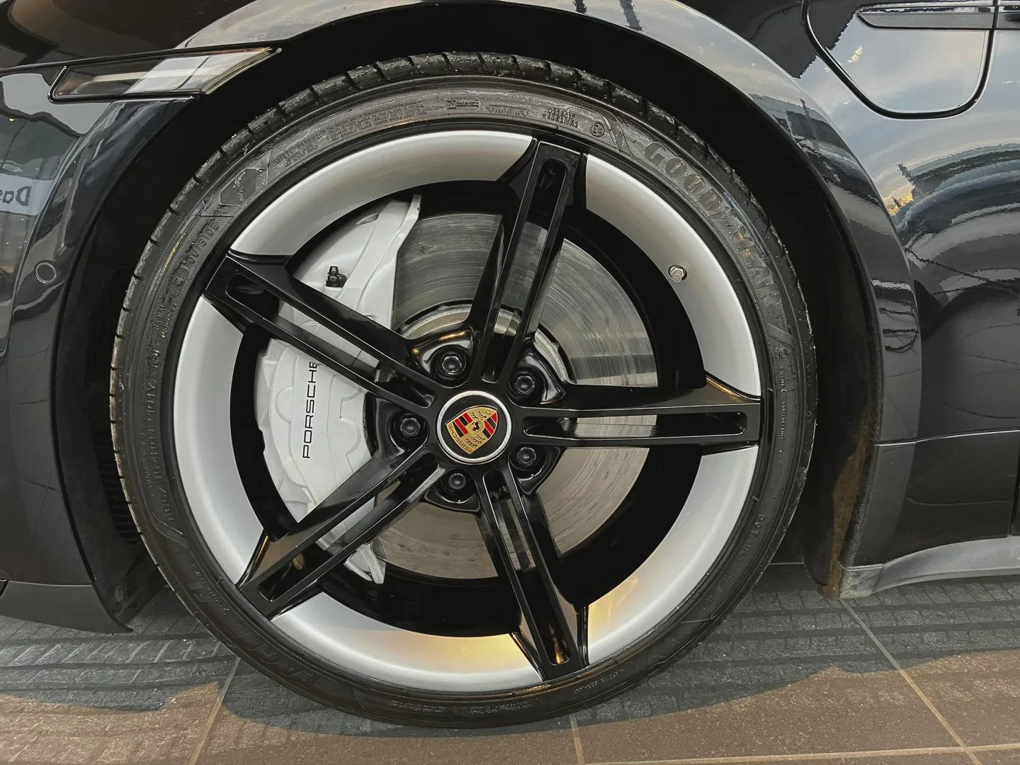

Of course it's different, because what @DerekS posted is not 10 pot at all.
Here is a pic of 10 pot PSCB caliper
Porsche Taycan PSCB: Slight scraping sound from front left wheel when in motion 1767812441276-j1
ct14garage
Cris T.
Apr 17, 2025
501
907
Thailand
ct14garage.com
I see the confusion thanks for clearing this up. Yeah those do look the same just different color. This is probably turbo or turbo s as those came with bigger brakes.

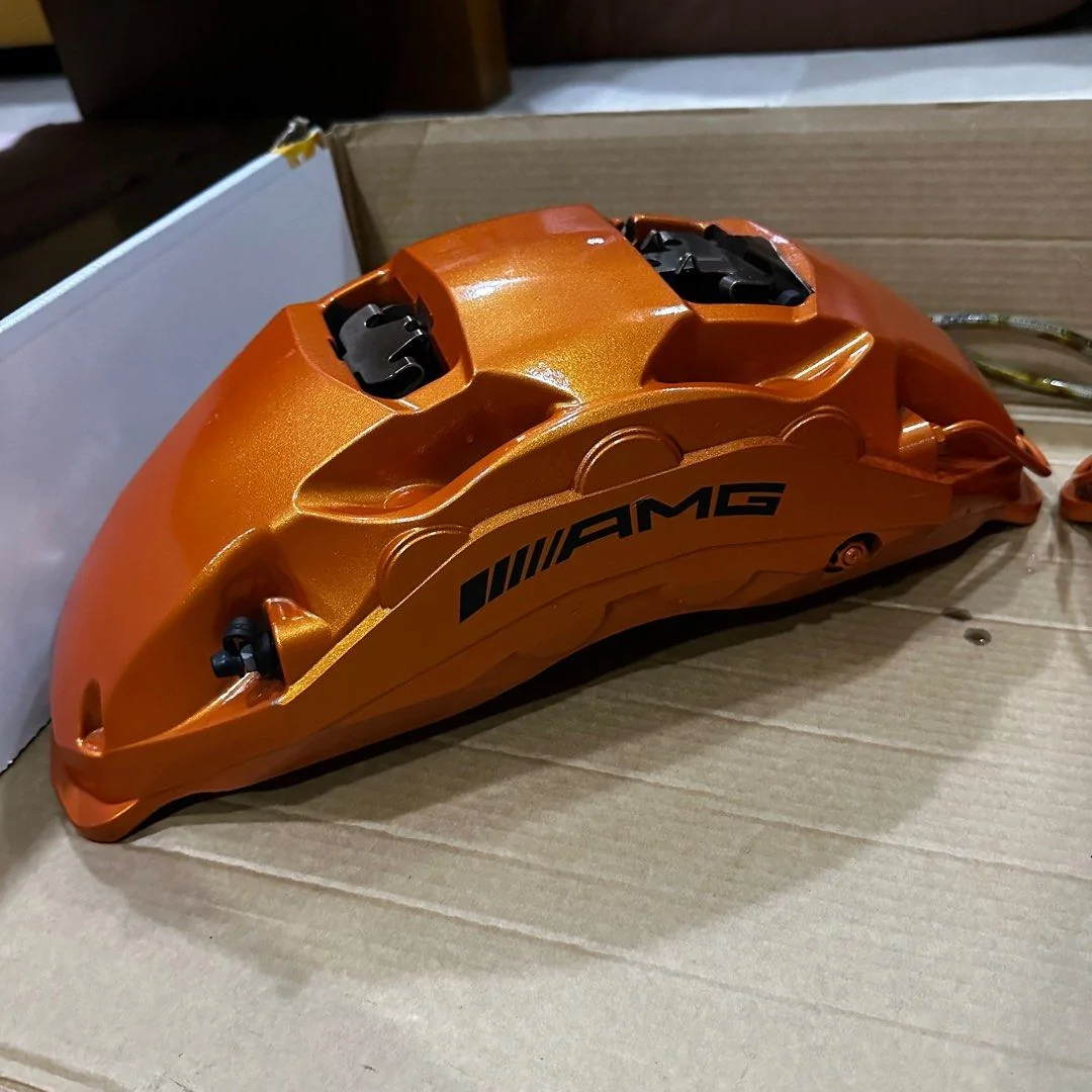

And this one from Mercedes-Benz AMG is still the exact same caliper, but AMG uses completely different size disks both in diameter and in width. Many different brands use the Akebono 10n caliper
Porsche Taycan PSCB: Slight scraping sound from front left wheel when in motion 1767812720189-3t
