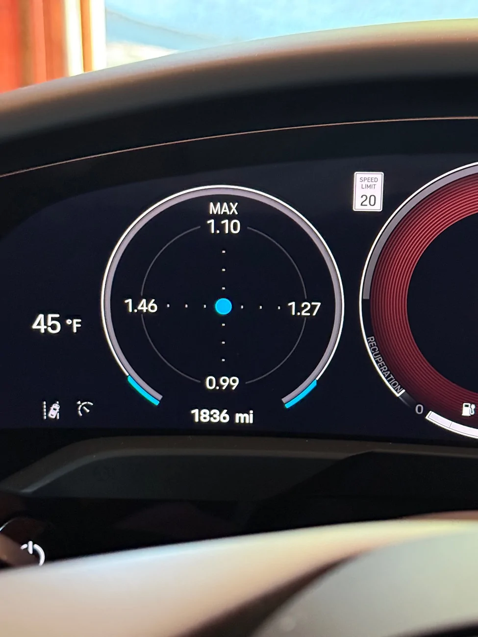

As a coda to this PEC saga...
I remembered that the G-Meter will keep "high scores" until reset.
All I've done is gentle in-town driving since I got it, but look at the lateral G-Forces!
Clearly, the previous owner was a grandma that dove it only to the market, gently, ever so often.
87
8,255
7,269
But do lateral forces indicate heavy brake usage?

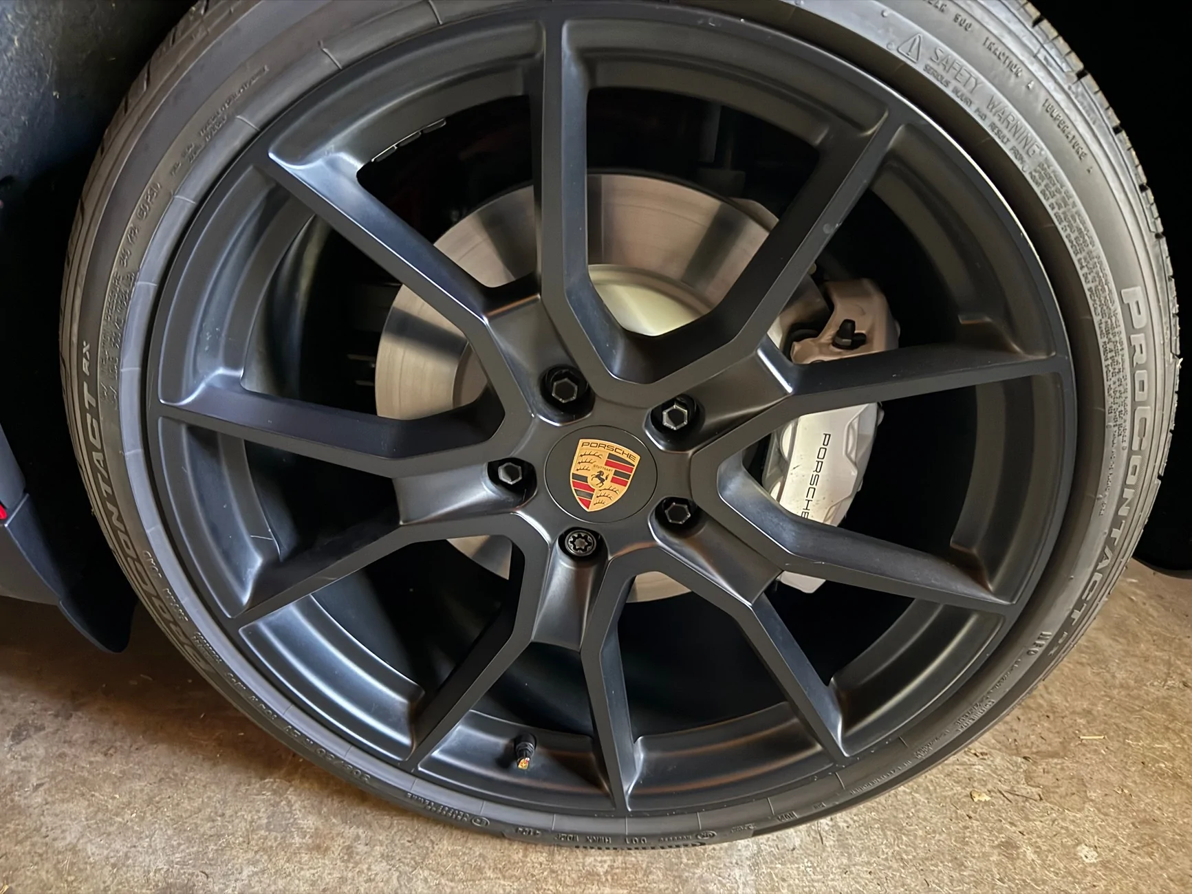

Porsche Taycan PSCB: Slight scraping sound from front left wheel when in motion IMG_6024
Front are wearing in normally I think?

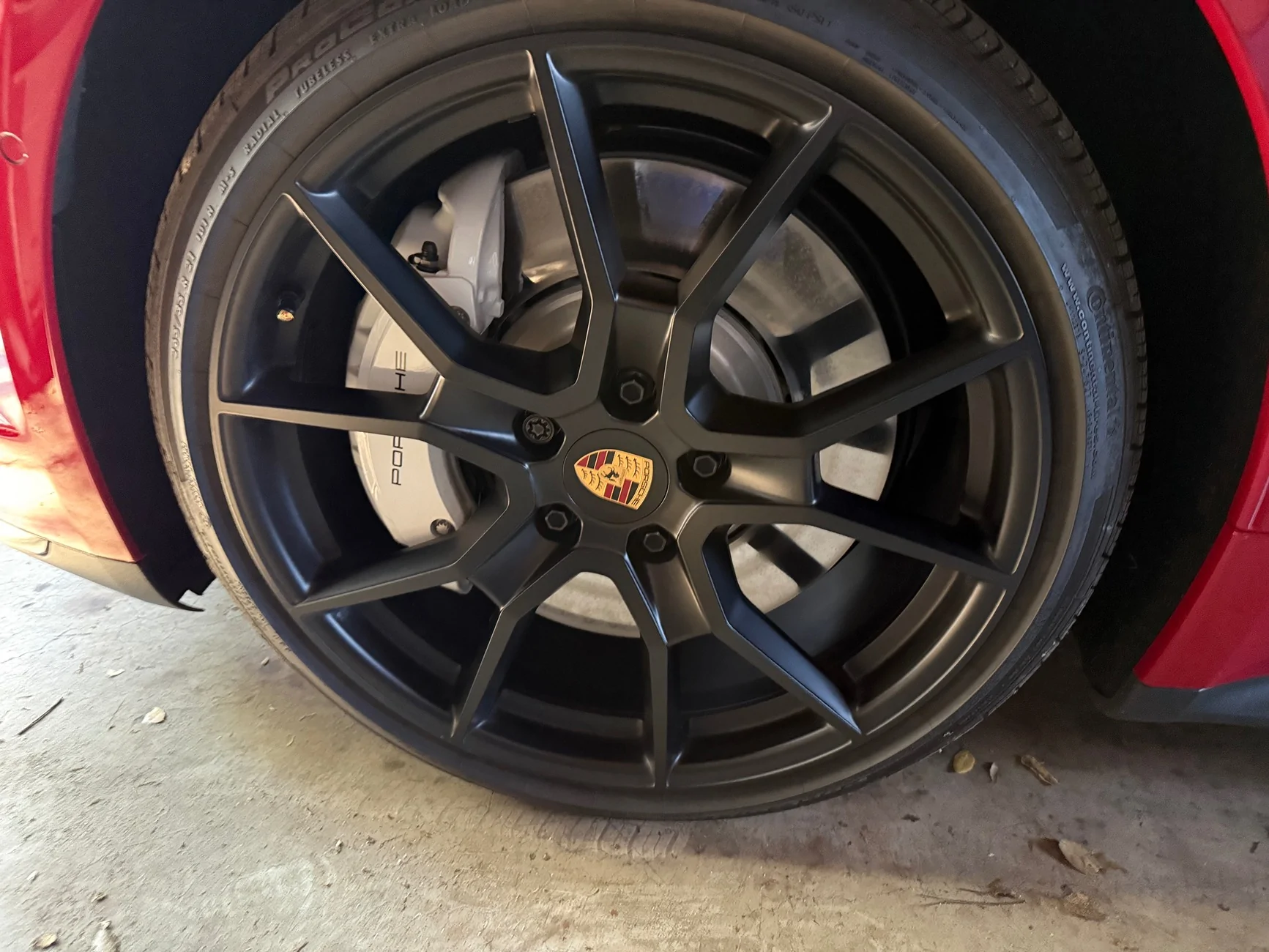

Porsche Taycan PSCB: Slight scraping sound from front left wheel when in motion IMG_6025
