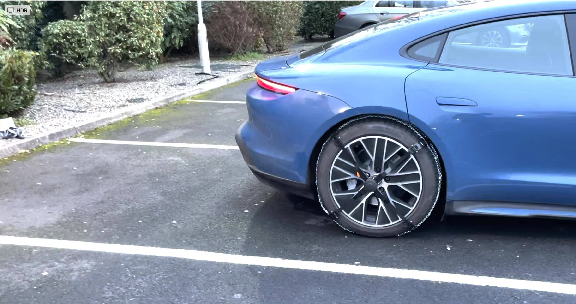

Thank you so much., very helpful though I can't notice any rear wheel turn .. checked through the mirror and had someone drive and nope .. I can't see any movement. I understand that is only a couple of degrees but I can't notice.I made an appointment to have it checked out.
Hope I am just missing something or it's too little change to notice ...
cheers.
I used my phone taking a video right at the window. When I drive on a parking lot in a circle, I see the back wheel coming out.
You also should easily be able to messure the turning circle at low speeds.

I was at the dealership a couple of weeks ago and watched my Taycan been driven slowly into the repair shop. Even though the movement is very suttle, you can clearly see the rear wheels move into the opposite direction very noticeably. You will definetly see it very clearly, when someone moves your car a couple of meters forward and moves the steering strongly to either side while moving.
Interesting, so if noticeable, then when doing a reverse parallel parking manoeuvre (full steering lock) anyone watching from outside will see the rear wheels turn in the opposite direction?
I tried this before (was relying on my disinterested son) and came up blank - time to re-test.

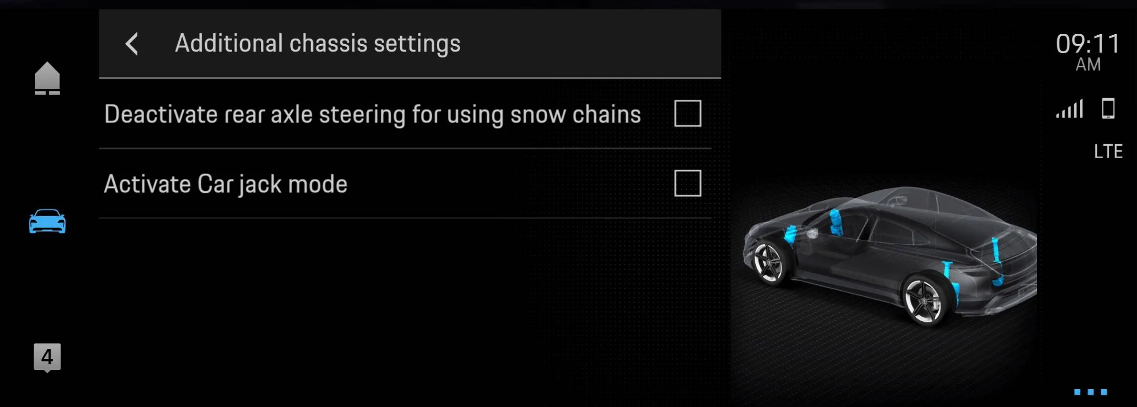

When you had this option on the Panamera – there used to be a setting in the PCM – where you had to disable RAS when you had snow chains on. But that doesn't seem to be a thing with Taycan. It used to be one way of knowing for sure you had the option!

Actually, 11 - 12 months ago this option did appear on my PCM and now is not visible. Oddly it still appears on the simulator - perhaps this provides a clue whether the darn thing has been properly activated or not - if not then the menu option disappears?

That really is interesting. Especially as someone who was practicing fitting snow chains yesterday. I did look in the PCM for the menu and couldn't see it – only the "activate car jack mode". I can't remember if it was in my Taycan previously but for sure was in my Panamera.
Porsche Taycan Rear Axle Steering - how to confirm it's installed / working? Screenshot 2022-01-10 at 12.39.33

There's RAS in my CT and I checked it by sitting in the passenger seat while someone else is driving. While sitting in the passenger seat, look at the tyre at the right side-view mirror. When turning or driving in roundabouts, you should be able to see it clearly.

I've tried a quick, unsophisticated test as I was starting to worry about this myself! :CWL:
I set my phone camera to rear facing (selfie) mode, held it out of the window with my arm resting on the door so the camera didn't move at all, then set off at a moderate pace putting full lock on both ways. You can clearly see the rear wheel changes orientation slightly, particularly on full left lock where the wheel itself becomes obscured by the tyre. Interestingly, when you come to a stop the wheel seems to centre again even if you leave full lock on.
Should be an easily reproducible test and doesn't involve an assistant or elaborate gear to mount the camera onto the car's bodywork!
