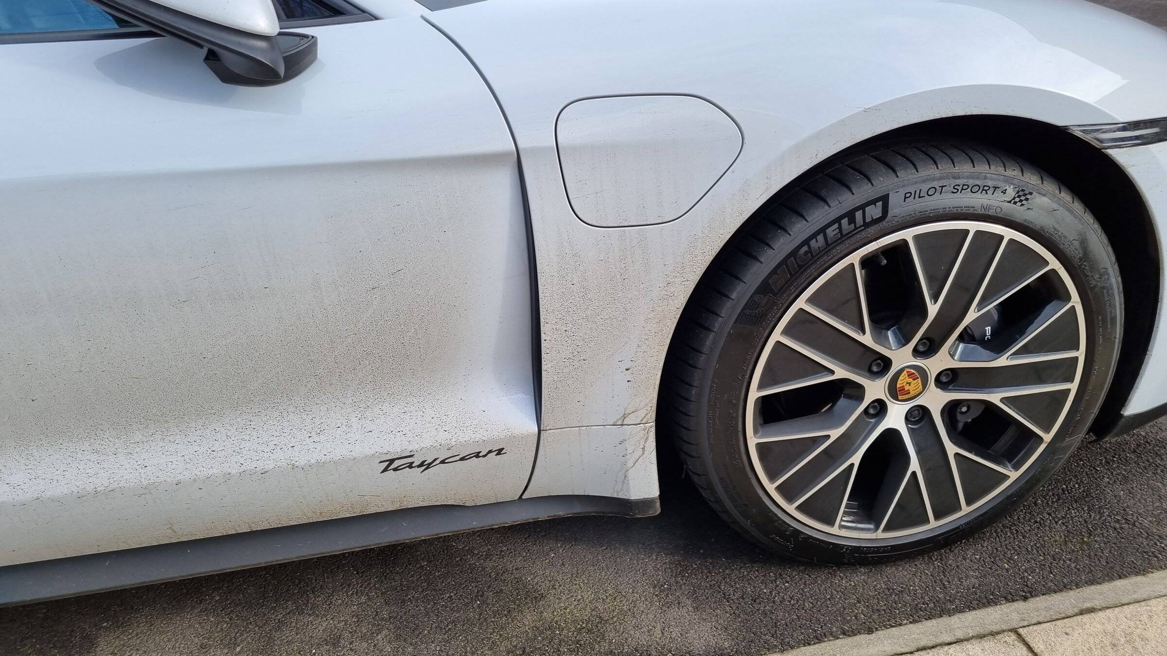

I would say the more dirt in winter is wrong too.
This is my car after a typical UK winter drive. Behind the vents is the cleanest part.
And 7k+ miles in, there isn't a single stone chip behind the (open) vents.
Porsche Taycan Rear Wheel Steering 20220202_132036
