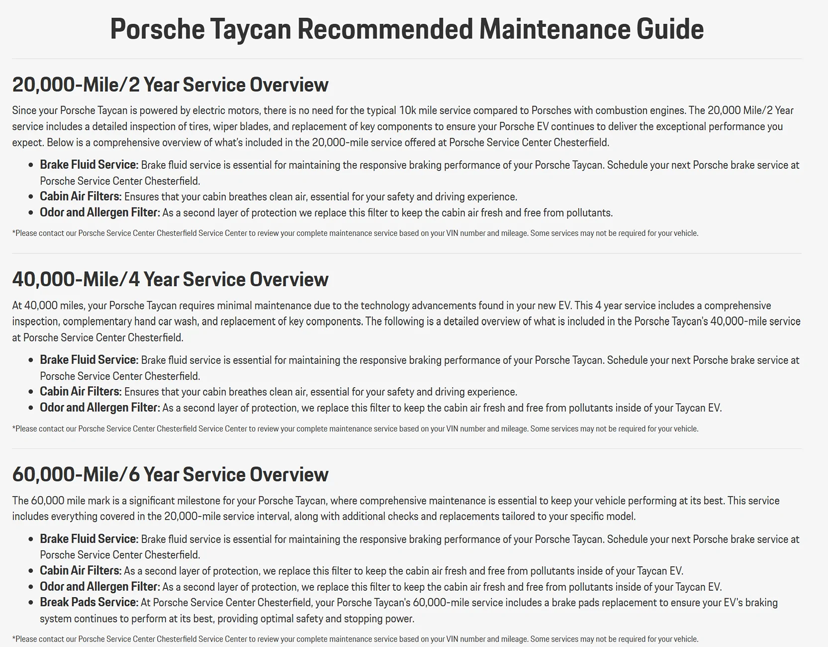

My car is currently at the dealership for an electric system error (link to that thread). I have ~37K miles on the odometer so I asked about 40K maintenance while it was there. I was quoted $3600 which included brake replacement (they didn't inspect the brakes) that they claimed was what Porsche recommended and offered to print something for me stating that. I declined and called Porsche support as soon as I got home. I had Porsche email me the official schedule and details. Here's the content of the email.
"Thank you for contacting Porsche Cars North America today for assistance. As requested, please find below the recommended maintenance schedule for the Porsche Taycan, along with the typical service items performed at each interval:
Porsche Taycan Maintenance Schedule
Every 10,000 Miles / 1 Year
  • Tire rotation and tread inspection
  • General inspection of vehicle systems
Every 20,000 Miles / 2 Years
  • Inspect wiper blades
  • Inspect tires & spare wheel
  • Inspect headlight adjustment
  • Inspect radiators & air intakes (visual inspection for contamination & blockage)
  • Inspect brake system (check pads & discs without removing wheels)
  • Inspect water drain for charging socket (check for contamination & blockage)
  • Inspect brake lines
  • Inspect brake hoses
  • Inspect drive shafts
Every 40,000 Miles / 4 Years
  • Inspect brake system (remove wheels to check pads & discs)
  • Inspect underbody panels
  • Visual inspection for leaks
  • Inspect steering gear
  • Inspect tie rod joints
  • Inspect axle joints
Every 2 Years (Regardless of Mileage)
  • Replace brake fluid with OEM Porsche brake fluid
  • Create condition report for long-life guarantee
  • Inspect tire sealing compound
If you have any further questions or need assistance scheduling service, please feel free to reach out. We're here to support you."
This is what the Maintenance Booklet that came with my (2021) car says:
This is great, thank you! I don't have access to my user manual since it's sitting in the glove box at the dealership.
