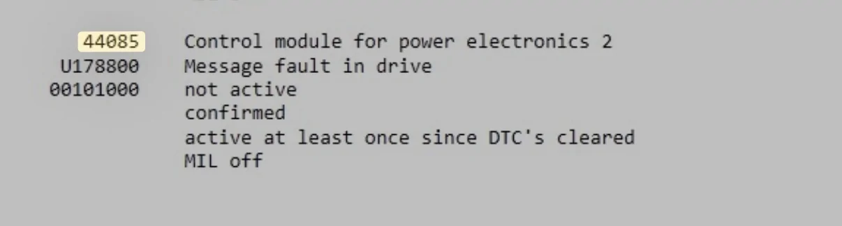

The iOS Car Scanner app gave me this:
Not sure what's actually relevant in there.
Gonna try with the MapEV software tomorrow.

It is likely the front inverter. There is a current sensor in there that is failing. I would not clear the codes so the dealer has something to work with. I had this issue once. The dealer wouldn't do anything about until it happened again. So far it is behaving itself. I did have to have the rear motor replaced after showing the dealer all the codes I was seeing with my Foxwell i70BT scanner. Thankfully I had a warranty. Good luck.

I've got the VSP warranty, not a CPO, and it went in the shop last wednesday.
The quote from the service advisor was:
We are going to be recommending the power electronics to the extended warranty. I'm going to reach out to them next and update you again after I speak with them. Very likely will be something they will want to send one of their inspectors for prior to approval. Pretty normal process for extended warranty companies
Fingers crossed it comes back good as new.
