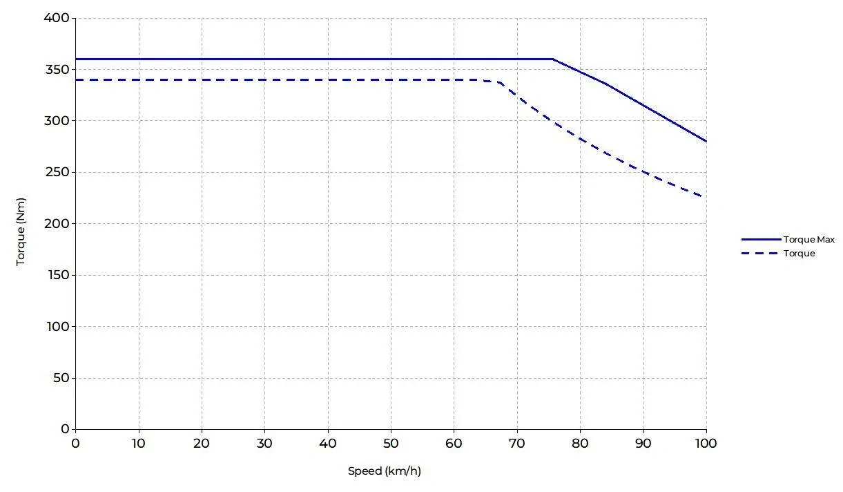

My apology, but I must of misinterpret the graph that you posted. I was under the assumption that porche pretty maxed out the rwd motor from the factory. Do you have any real world acceleration time between stock and tune rwd PB+ cars? Thanks

The gearshift is at ~130km/h. Majority of the difference is above 60km/h. It accelerates 25% faster after that. So if your 100-200 time is e.g. 14 seconds, you would expect around 11.5 seconds with the tune.
I don't think I have actual Dragy measurements from a RWD, but we've done quite a few and people have been satisfied with the result.
Maybe this graph is more interesting:
Porsche Taycan Redshift vs MapEV 1764682369302-kj
I'd say the difference is fairly significant at higher RPM. It shifts at 125-130km/h with the tune, which is around 15500 rpm on the chart, and after the shift is complete you're right at 8000 rpm again, where you have the extra power.
Depends really how you drive it, if you just drive it around town, then there's not much to it, but out of town there is significantly more performance for overtaking and merging onto the highway.
Just depends on your usage I guess :)
