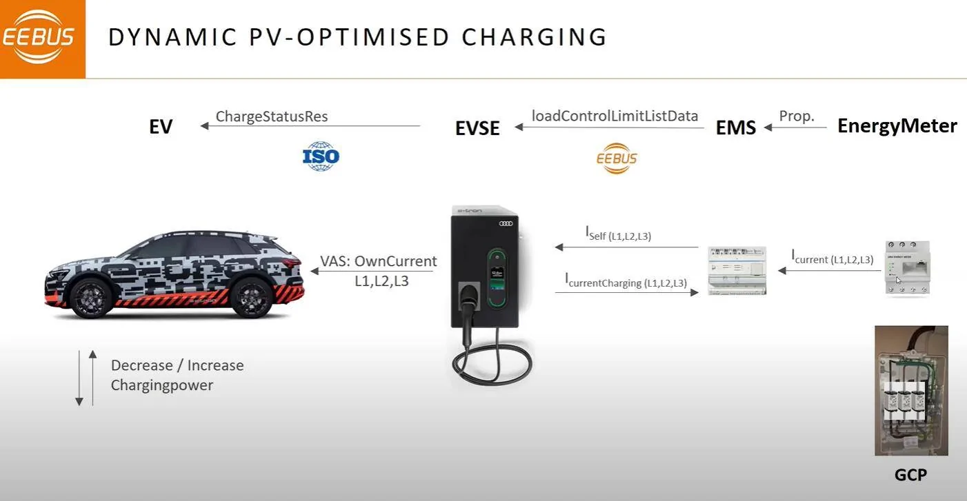

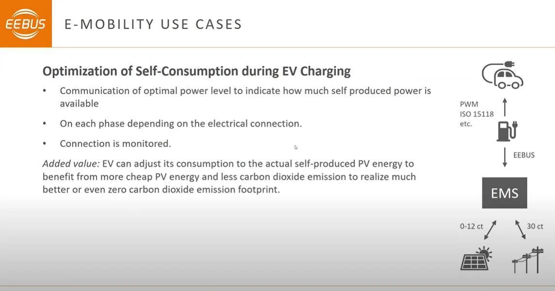

isn't that already advertised with the HEM to prioritize the solar input by charging consumption? At least it's one of the use cases of the EEBus standard stuff. A (not fully) work around would be to use the price optimization.
I like to add these slides of an EEBUS EV integration webinar
Porsche Taycan Show your home charging setup for your Taycan 1612739505991
Porsche Taycan Show your home charging setup for your Taycan 1612739533759
They refer to the scenario of an Audi Etron , Audi MCC and HAGER/SMA EMS, which should be 99%-100% compatible with the Porsche stuff.
Meet EEBUS, EV charging and more. Dr Maren Fiege, EEBUS Initiative e.V. & Gerhard Paris, Audi AG - YouTube

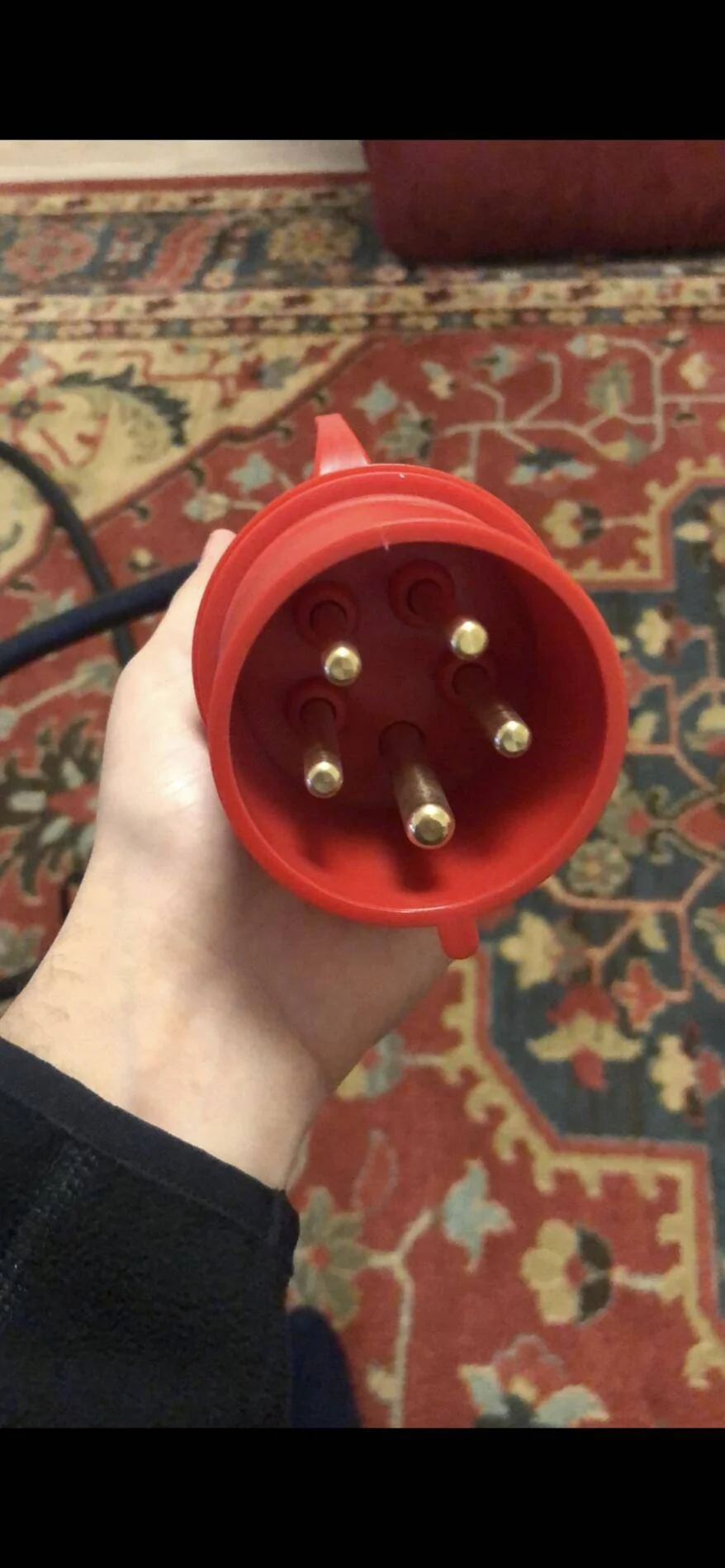

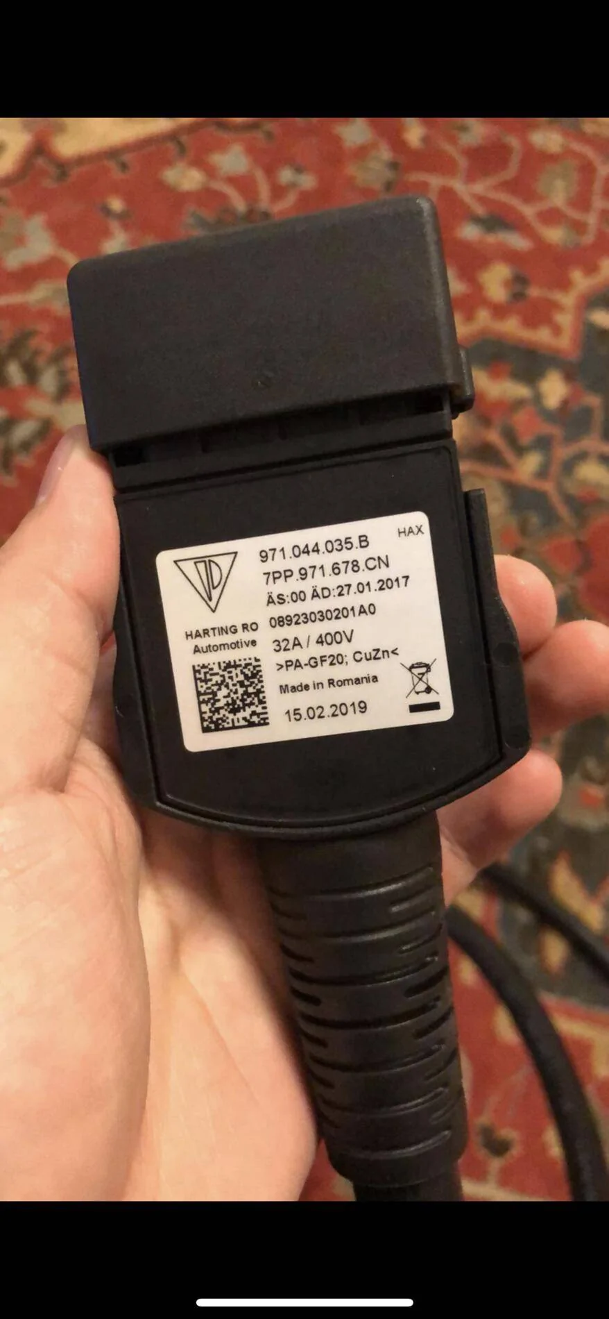

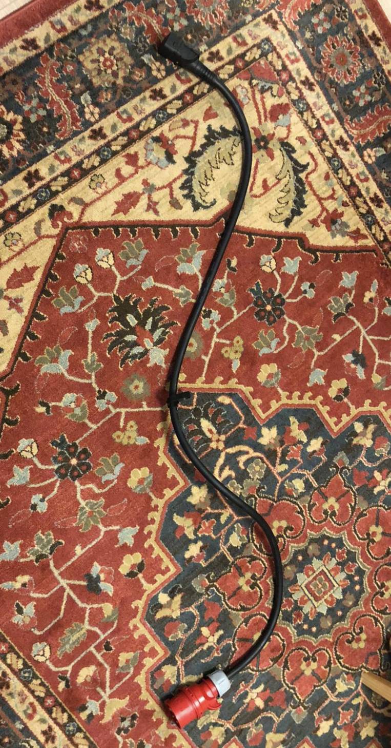

You can request it any time. The cable cost around 107Uk. i have 3 phase 240v supply at my place so purchased the cable before hand . Attaching pics for you to see
One end connects to your charger while the other goes directly to your electrical supply .
So am I right in saying the black end will plug directly into the Porsche Mobile Charger Plus cable?
The red end goes into any standard red commando plug.
And then this way you can get a rate of up to 11KW?
Therefore I would not need to purchase any charger like a Zappi etc?
