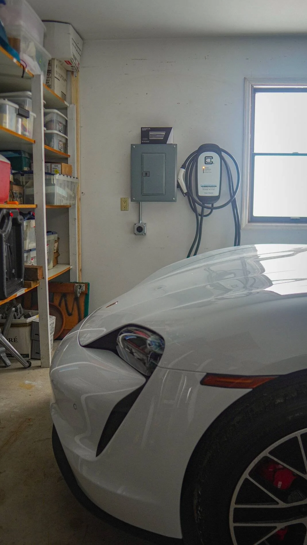

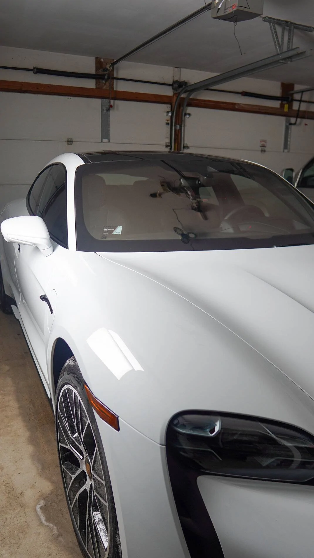

MY21 4s just arrived this morning. The garage was set up with a ClipperCreek HCS-80 hardwired into a 100-amp subpanel, plus a NEMA 14-50 in case the EVSE fails. Of course, only a single circuit can run at any one time. I had a whole home generator installed simultaneously (thanks to the August derecho), and I hope the electricians can install a sensor that will automatically switch power to the EVSE off in case the transfer switch engages.

@dgompper nice install - it should serve you well
are you getting 10.4x kW during charging with the ClipperCreek HCS 80?
192
7,009
10,491
@dgompper yes - porsche under-documents the North American taycan AC Level 2 charging limit as 9.6 kW - this limit is correct if you are charging from a "mobile" EV charger (EVSE) - which is limited by NEMA 14-50/6-50 plugs - 50 amp breaker = 40 amp charge rate = 9.6 kW
the charger actually included "inside" the vehicle is the same 11 kW charger Porsche ships to the rest of the world - therefore if you are using a 60 amp (or greater) EVSE (like your ClipperCreek HCS-80) - you get the Taycan's maximum charge rate of 11 kilowatts (48 amps - which is the appropriate charge rate for a 60 amp breaker).
woot!! double woot - hurray for Porsche not artificially limiting North American Taycan's to 9.6 kW.
