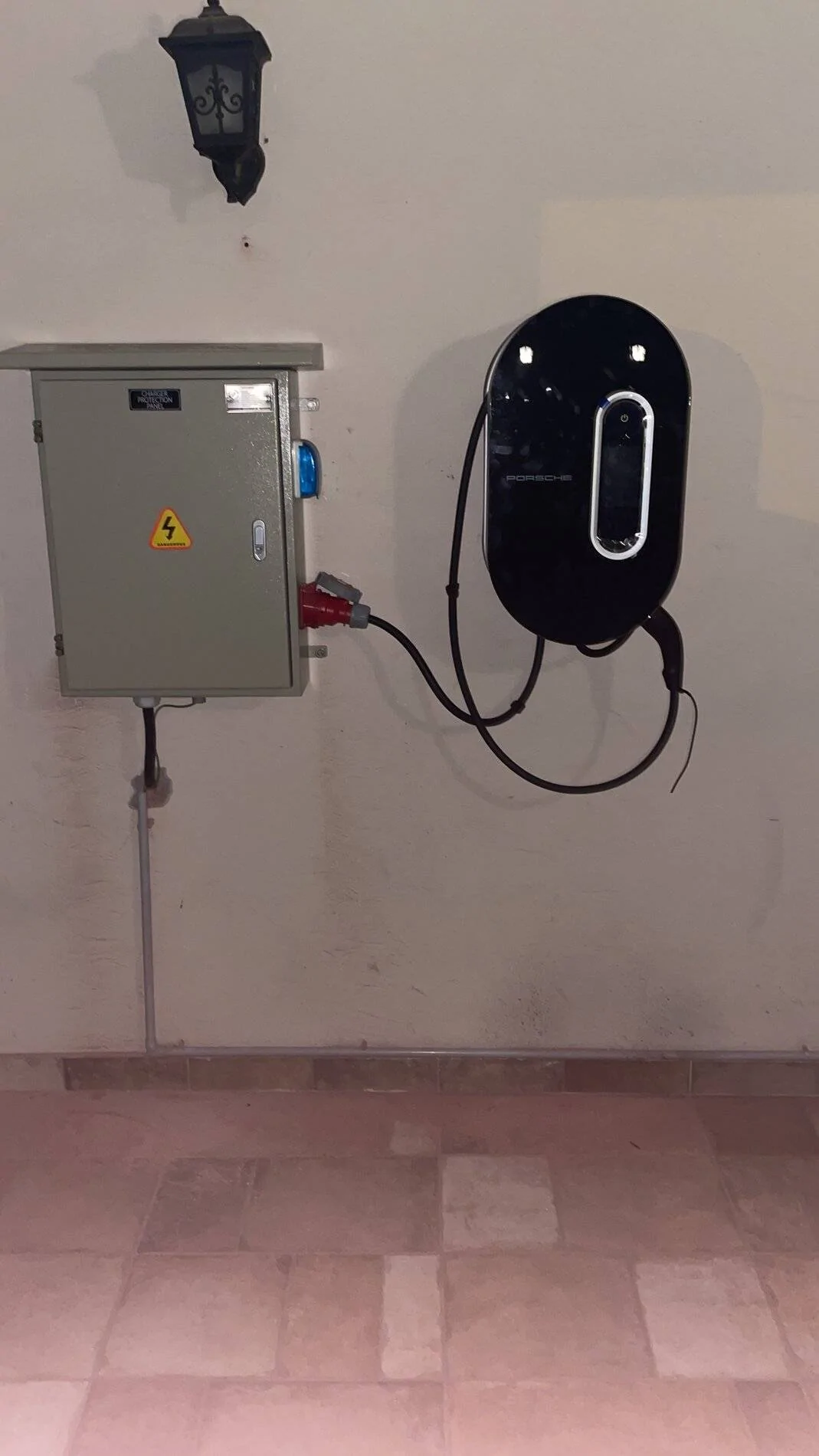

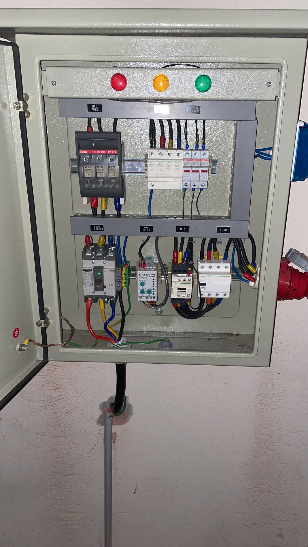

A lil un neat but it’s doing it’s job perfectly. I’m getting 10.5kw per hr on 3 phase 240v
Bought the red commando plug from Porsche which can give me a max of 22kw but unfortunately my car is specced to receive a max of 11kw

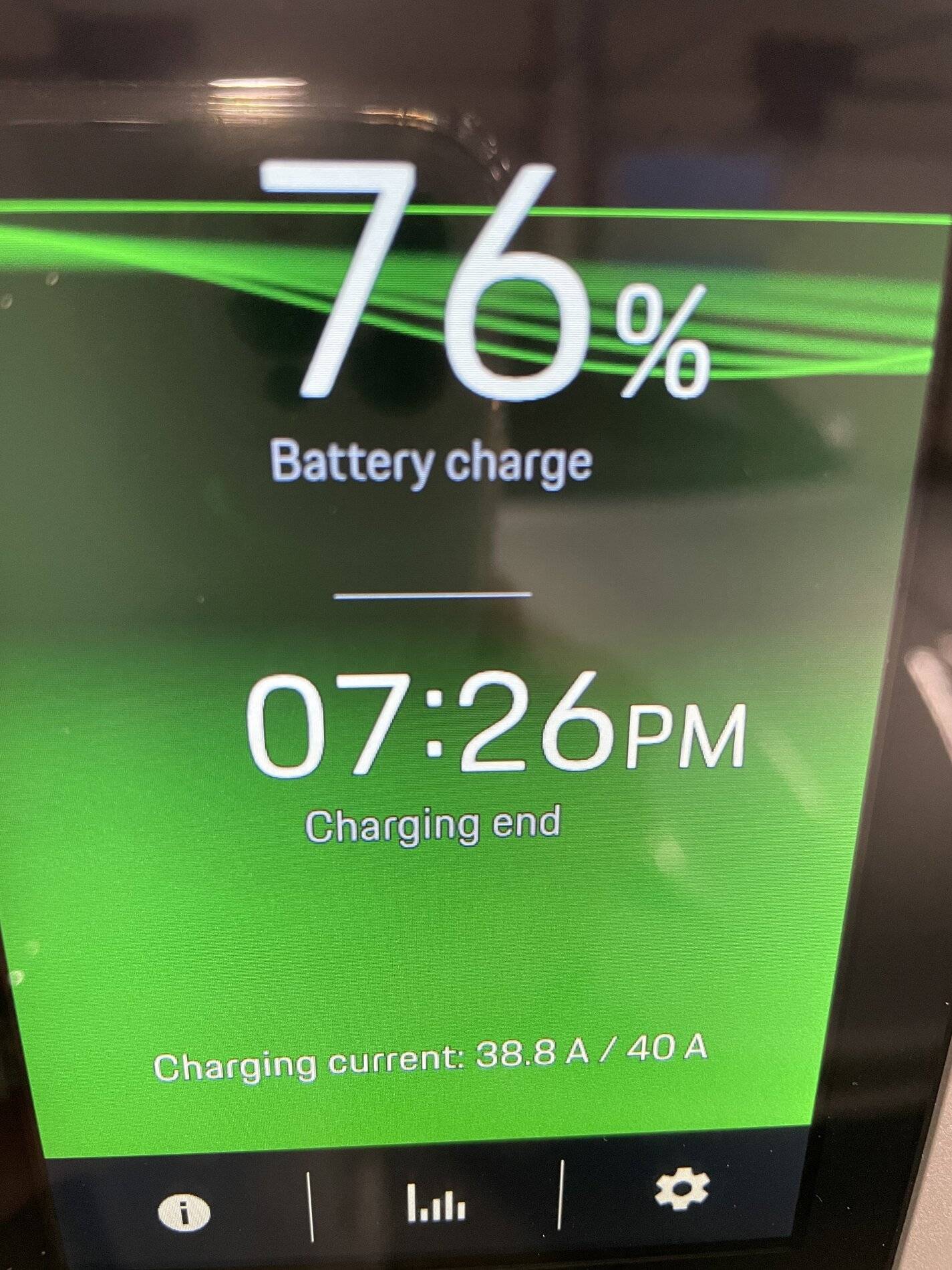

Has anyone seen a 9.6 kW charging rate?
I have my PMCC plugged into a 14-50 and the charger is set to the maximum power of 40A. But the it is charging now and the PMCC display says 38.8 A / 40 A and the car says it is charging at 8.4 kW.

@Jon Steinmetz
8.4 kW is about correct for a 9.6 kW charge rate - there are charging “losses”between the ”wall socket” and the battery - Porsche’s software in car seems to report the amount of power that is “hitting” the battery - which will be less than the “raw” power coming from the PMCC
I have a whole house power monitor and I can “see” the delta on the power draw when the charger kicks on - the delta is the raw & pure 9.6 kW - but then what I see inside the vehicle is the lower value of power hitting the battery due to charging losses.
Also the kW’s reported will vary based on your home’s actual voltage - in North America 240 volts is an “ideal” voltage number - but the actual electrical grid is variable with in a range of voltage - 240 volts is used for calculations of 9.6 kW (240 volts * 40 amps = 9,600 watts or 9.6 kW)
however the real world is not ideal - and actual voltages in your home and from your electrical supplier will vary - I’ve seen as low as 210 volts on a hot summer day when everyone in the neighborhood is running their AC’s - and as high as 250 volts - so the actual kW’s will vary slightly due to variations in actual voltage which depend on several factors:
  • actual voltages from your electrical supplier
  • variation in voltage supply through out the day
  • variation due to “grid” loads through out the day
  • voltage “loss” due to the wiring inside your home from your “meter” to the actual “plug” in your garage
    • if you have a long run of cheap wire there will be “voltage drop” over the distance of the wire - if you measure voltage at the “meter” and voltage at the wall socket - the wall socket may be lower than voltage at the meter due to voltage drop due to wire gauge, temperature, length, materials (copper vs. aluminum)
212 volts * 40 amps = 8,480 watts - or 8.4 kW
220 volts * 40 amps = 8,800 watts - or 8.8 kW
230 volts * 40 amps = 9,200 watts - or 9.2 kW
240 volts * 40 amps = 9,600 watts - or 9.6 kW
250 volts * 40 amps = 10,000 watts - or 10.0 kW
all of the voltages listed above may be “normal” for various conditions in residential power supplies from the grid - and therefor you will see that actual charge rates will/can/do vary from the “ideal” 240v * 40 amp calculations…
my Taycan in my home in the evening reports 8.96 kW when charging from the PMCC - and I can see the 9.6 kW draw on my power meter…
my Taycan in my home in the evening reports 10.46 kW when charging from my Tesla Gen2 wall charger @ 48 amps - I see a 11.5 kW ”draw” from my electrical meter, and the vehicle reports 10.46 kW is actually charging the battery - that’s a 48 amp charge rate on a 60 amp breaker…
I‘ve seen similar variation with all my EV’s and in particluar my Tesla’s
Porsche in car software is reporting the amount of power being added to the battery - that will be necessarily less than “actual” consumption from the wall socket from losses due to overhead in the charging process (AC/DC conversation & heat loss - power is also lost if the Taycan is using the PMCC powersupply for battery/vehicle conditioning during the charging process).
the PMCC has a kWh “odometer/meter” and it will show you the actual consumption of power - and I’ve found it matches the actual utility meter pretty closely - if you keep track you will see more power consumed by the PMCC than was provided to the battery - this is normal and expected.
9.6 kW may be “entering” the vehicle at the “charging port” - but less is hitting the battery due to overhead/losses between the charging port & the battery (AC/DC conversation overhead being the major contributor - most inverters have a 3-11% loss in AC/DC conversion).

@Jon Steinmetz
38.8 amps * 240 volts = 9,312 watts or 9.312 kW
if your power supply from your electrical provider is the “ideal” 240 volts - the maximum amount of power for your setup appears to be 9.312 kW - and losses in actual power being delivered to the vehicle battery will be off that ideal maximum…
