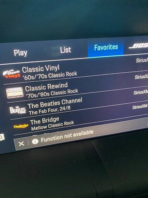

My apologies in advance, if this has already been covered. Any others having issues with Siriuis showing up sometimes, and others not? All of my favorites show still show up, but when I press on a channel, or the SIrius button, it says "not available." This happens randomly, and seems like every other time i use the car. I just had the car in for service, 2 weeks ago, for all updates. So it should be up to date. Key word being..should.

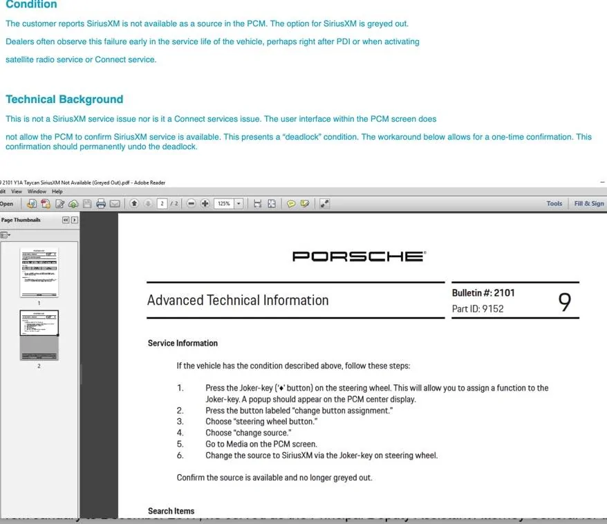

May need a software patch. 2 days after delivery of my '21 - sat radio stopped working altogether. There was no fix until ~September. No issues since update.
Mine at times just goes grey and I see Sirius/XM but can't access it. Here is the workaround.
Mine at times greys out and I can't access it, even though I can see it. Here what has worked for me. I also keep getting an XM antenna error, which the dealer is at a loss to figure out why.
Thanks Dslved

Thanks, dslev - I gave this a try and still no luck. All Media sources come up, except for Sirius. all i get is the following.... Function Not Available.
Porsche Taycan Sirius - Sometimes available, sometimes not. Sirius Function

Forgot to mention - joker key NEVER worked for me.
