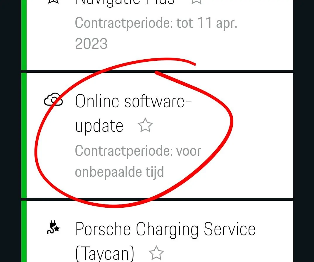

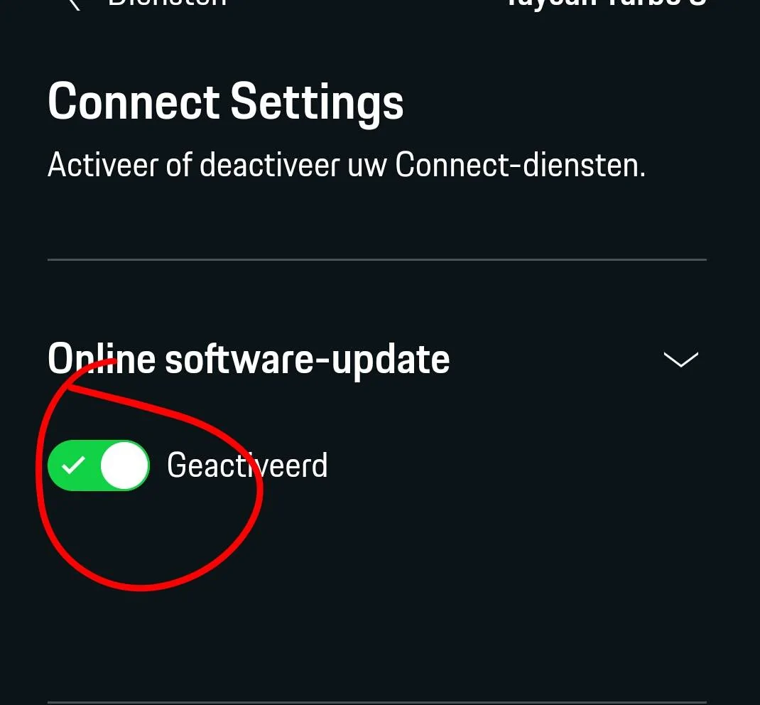

It could be that the car had the OTA updates whilst at the dealers. Typically they relate to mapping updates and other minor things (nothing to get excited about). I don't think there is a way to review OTA download history.
OTA updates appear as a notification (you will see a notification icon) and hear a brief audible tone when it arrives.
If automatic OTA updates has been enabled then you will likely not see many notifications as the updates will arrive and be applied automatically. If you disable this feature then you can control when the updates are retrieved and applied (suggest leaving on auto).
