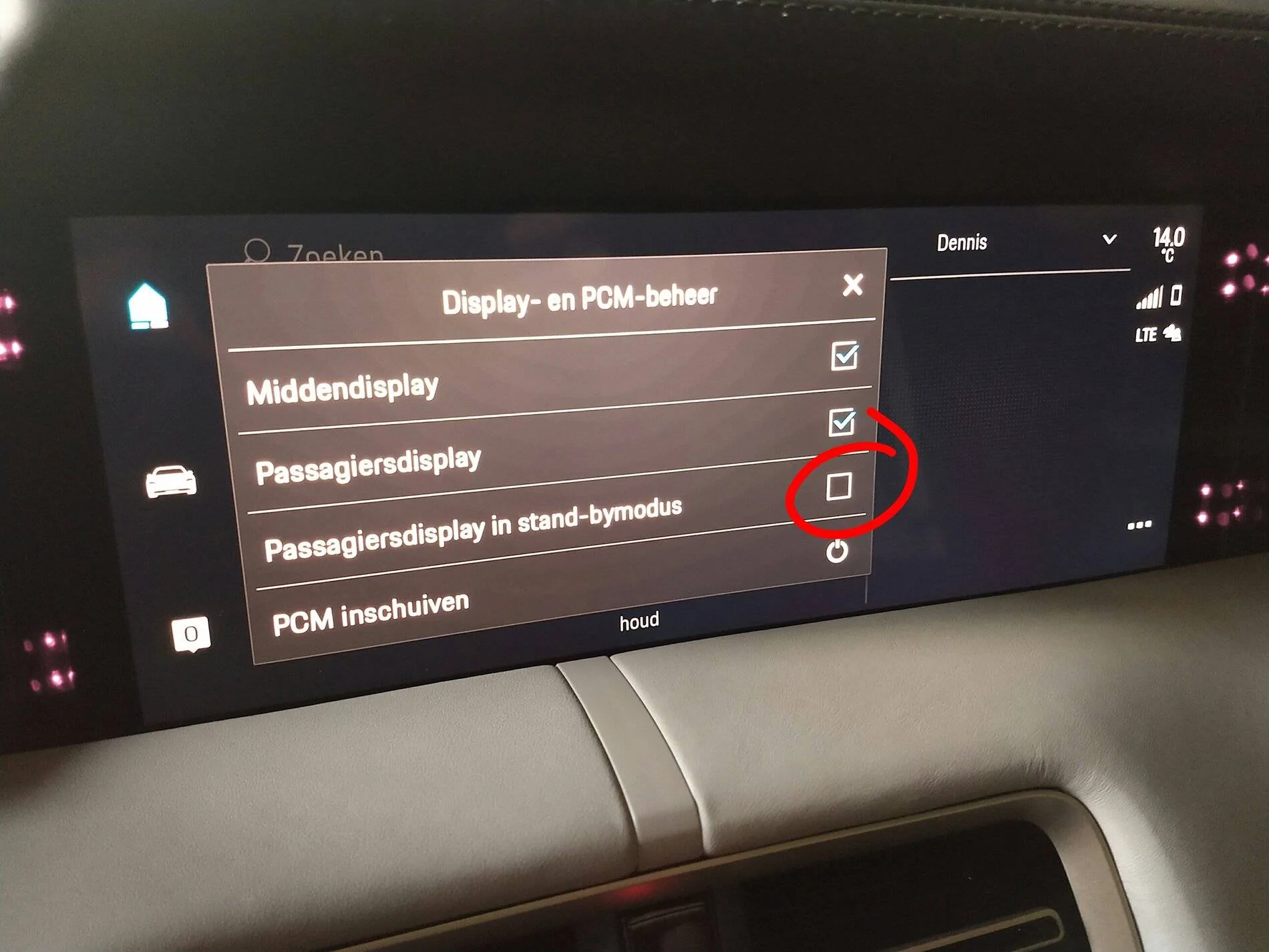

Can someone provide some instructions for how you get it to work?
When I start the car, press the button on the lower console display and turn off standby mode. As soon as I put the car in drive, it immediately turns on standby mode and won’t allow you to disarm it.
Maybe there is an additional setting some where.
after you turn off standby but BEFORE you put the car in drive, tap the passenger screen. if you are on home screen you will see cockpit option and other icons. Should stay on after putting in drive. See if that works. If it doesn't, I'm really not sure.
I finally found out the procedure:
Porsche Taycan Announced: Software update for 2020 Taycan models ? 2021-04-03_17.19.15
First, select the middle button in the lower middle display.
Porsche Taycan Announced: Software update for 2020 Taycan models ? 2021-04-03_17.19.39
Then, deselect the checkbox in the pop-up menu in the upper middle display.
This is only possible in Park.
Close the pop-up menu.
If this doesn't work the first time, try this:
-Call up the pop-up menu again.
-SELECT (activate) standby mode.
-Put into Drive.
-Put into Park.
-DESELECT standby mode.
-Close pop-up menu.
-Put into Drive.
As long as you don't put it into Park it stays on.
Remember, the setting is not stored so you have to do this every time you start the car.
I was thinking: if you don't put it in Park but only the "foot brake", will it stay on?
I'll try next time...
-Put into Drive.
-Put into Park.
-Close pop-up menu.
-Put into Drive.
Ah! Totally works now. Key appears to exit the screen back to home before going into drive.

I'm not sure what you mean by that but I'm referring to post #198 where I didn't know how to switch it on again cuz I tried so many different things.
Now I know.
My guess is it is a bug in the programming that is allowing this to occur. May be part of why it takes a few tries sometimes to get it to work. But, either way, the display actually has some value now!
