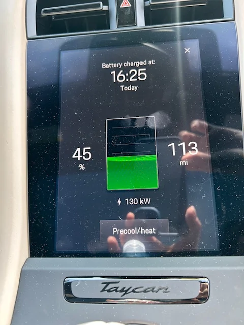

First time charging at a Tesla Supercharger. I was impressed how easy it was. No app, just picked up the Tesla cable, inserted my Porsche NACS to CCS adapter and plugged it to the car.
After about 20 seconds the charge started. I do have the optional On-board 150kW / 400V DC charger and I saw 130 kW at 45% SOC. Price was ok at 43 cts / kWh. I didn't really need to charge at a Tesla Supercharger but I wanted to see if it worked in case I need it in the future.

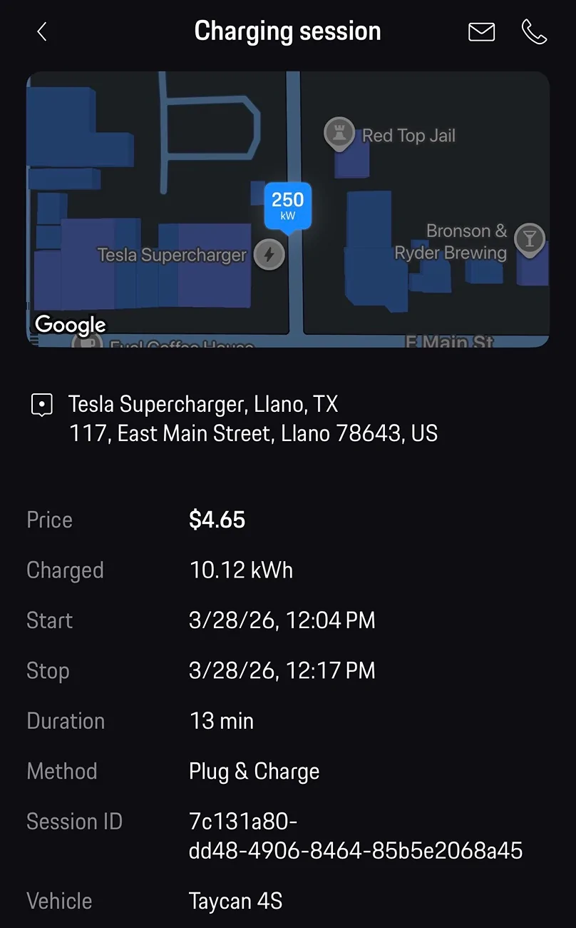

Tried this last month and it worked for me too. 2024 is my MY.

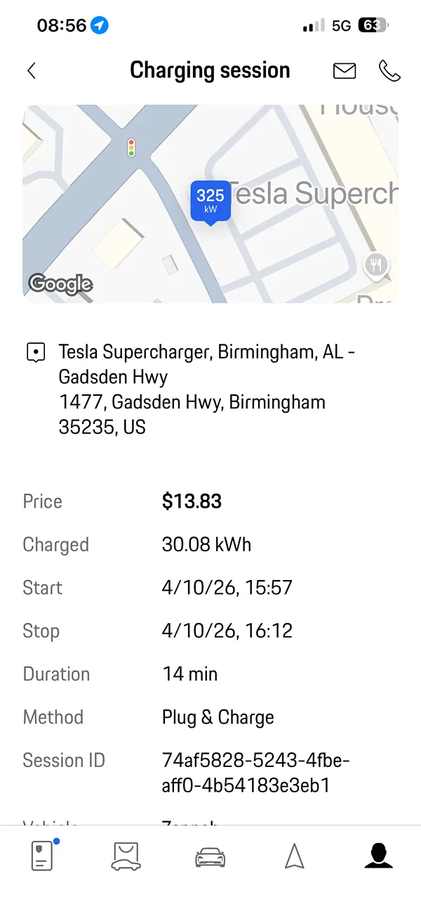

I don’t know if all Tesla supercharger stations are open to plug and charge for Taycan but the one I’ve tried worked. Here’s the invoice.

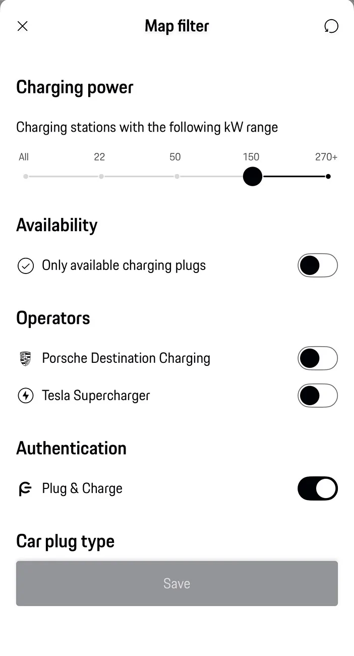

you can see them on your MyPorsche App. Go to the map and filter using Tesla Supercharger and Plug and Charge.
Make sure you turn off Tesla Supercharger and turn on Plug and Charge. If you don’t turn off Tesla Supercharger it will give you all the stations regardless whether they accept it or not.
