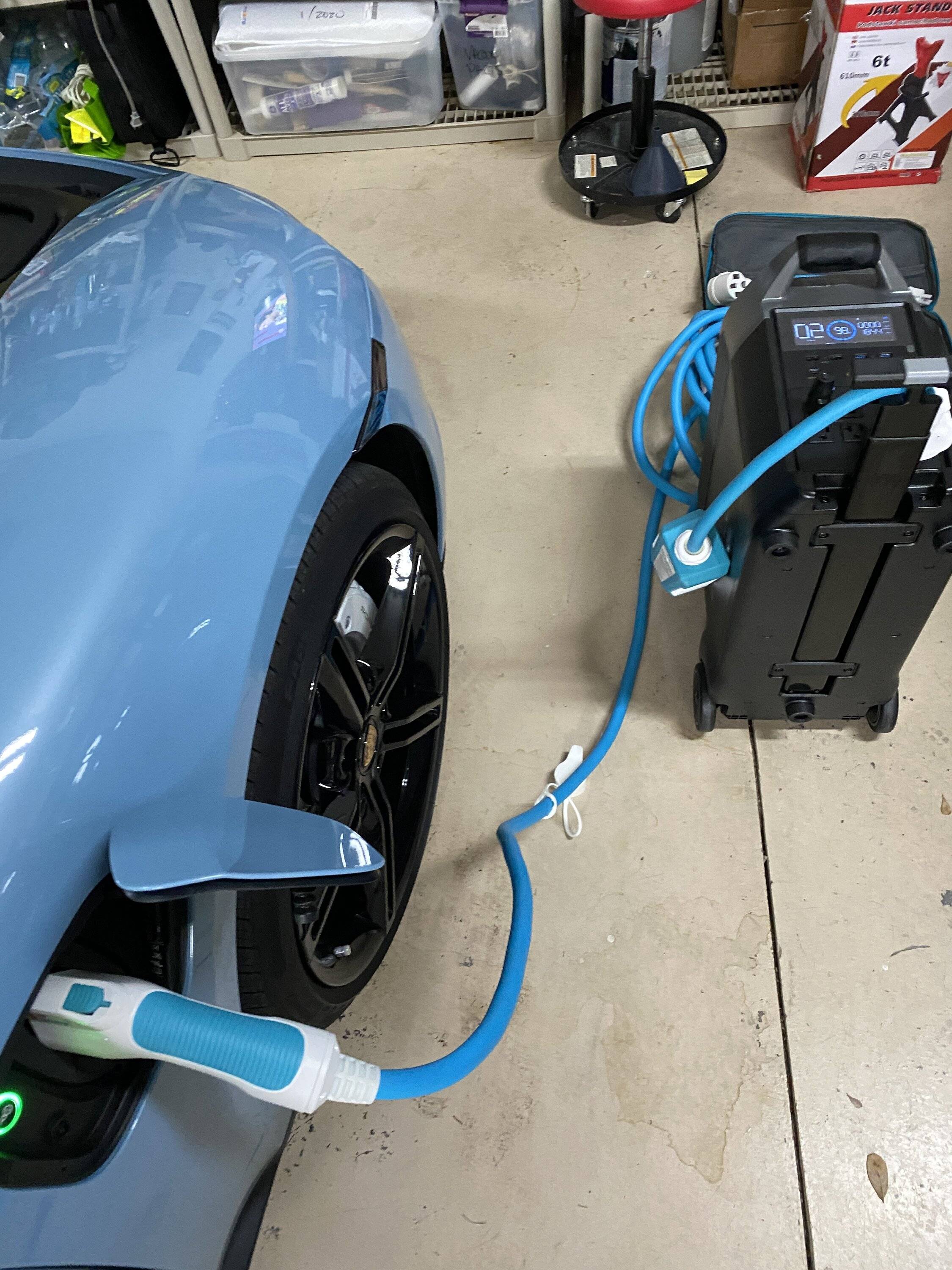

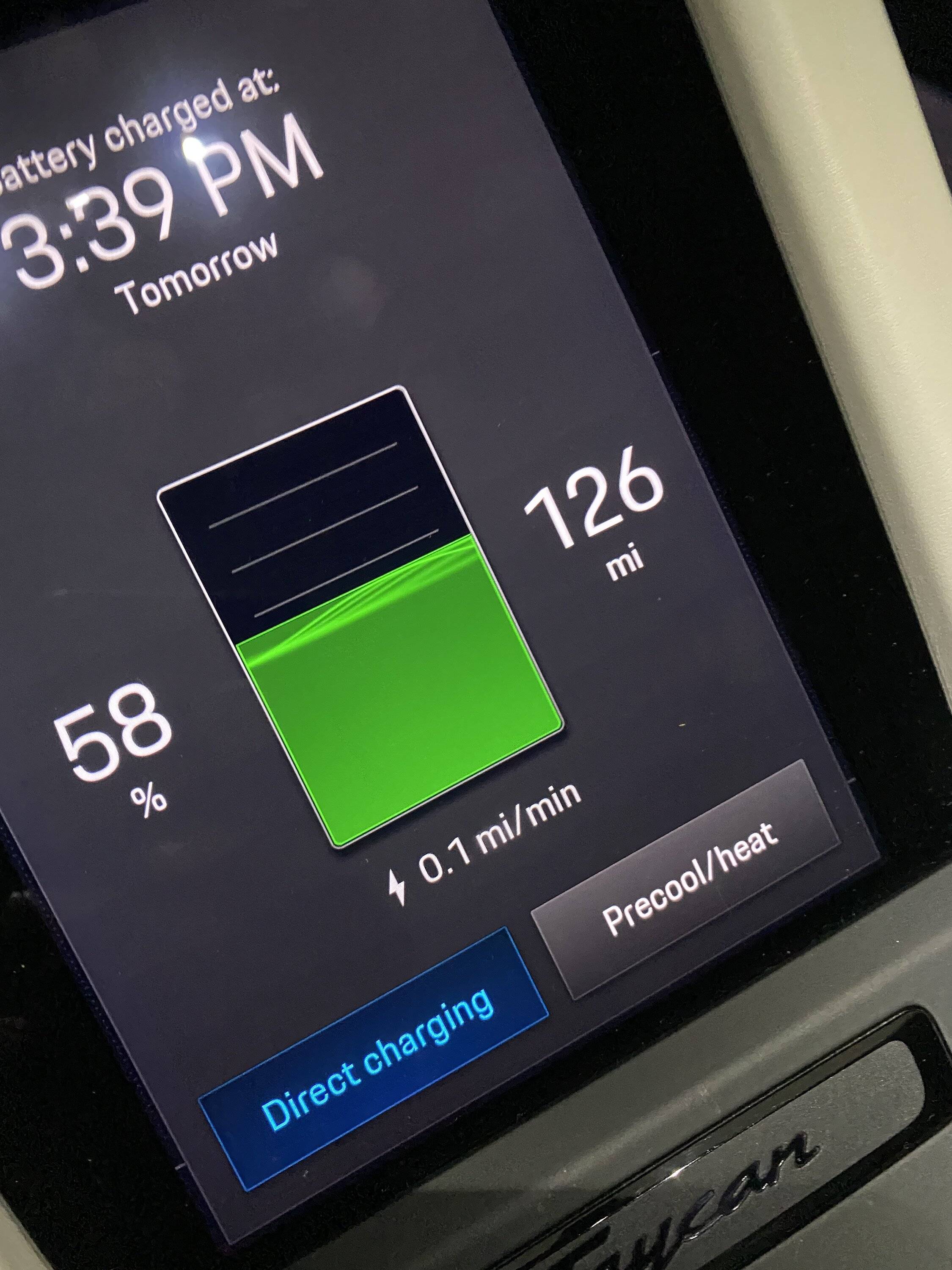

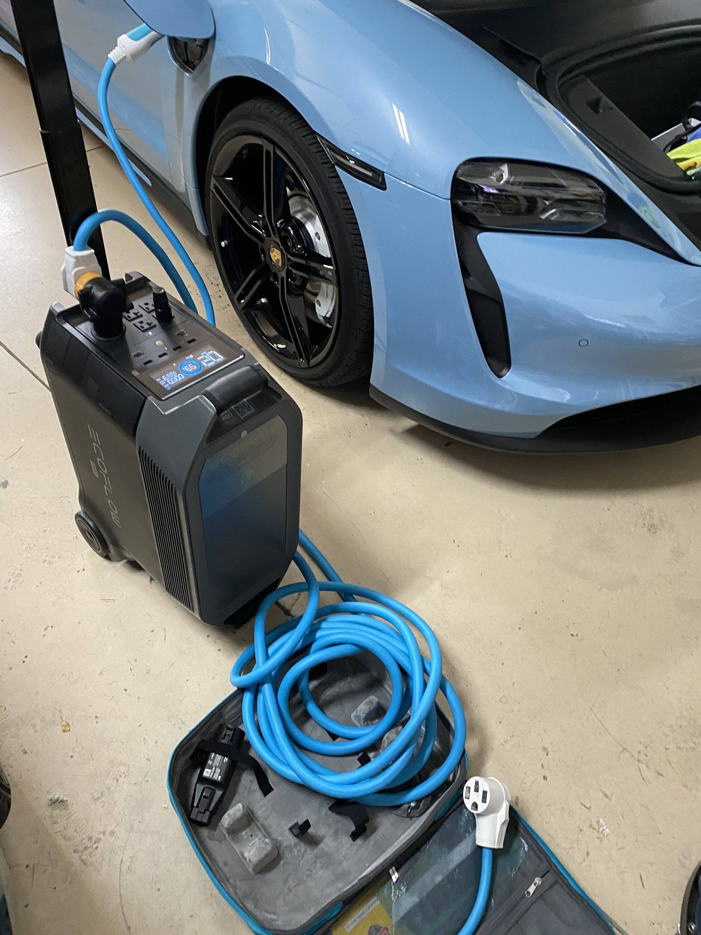

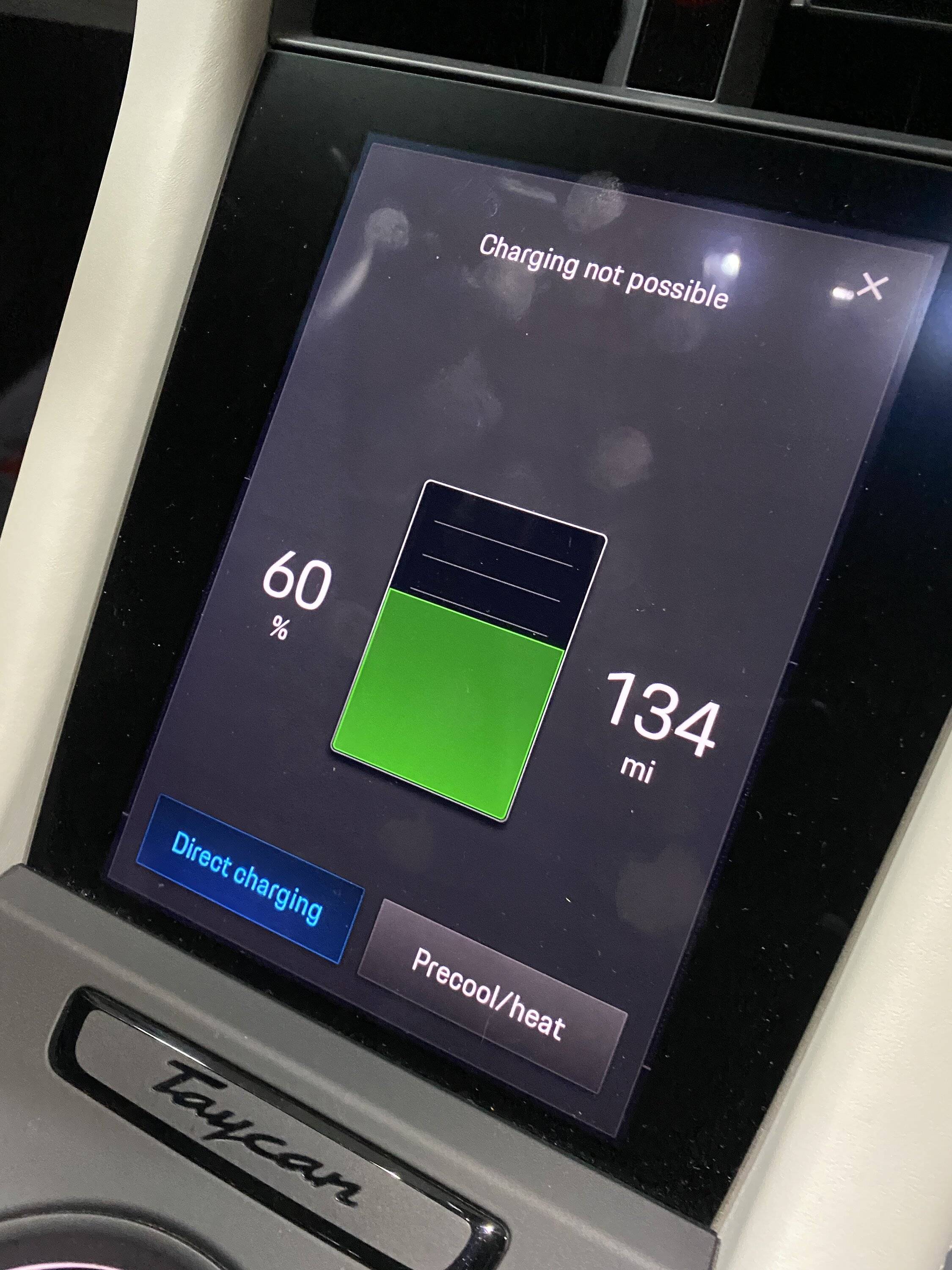

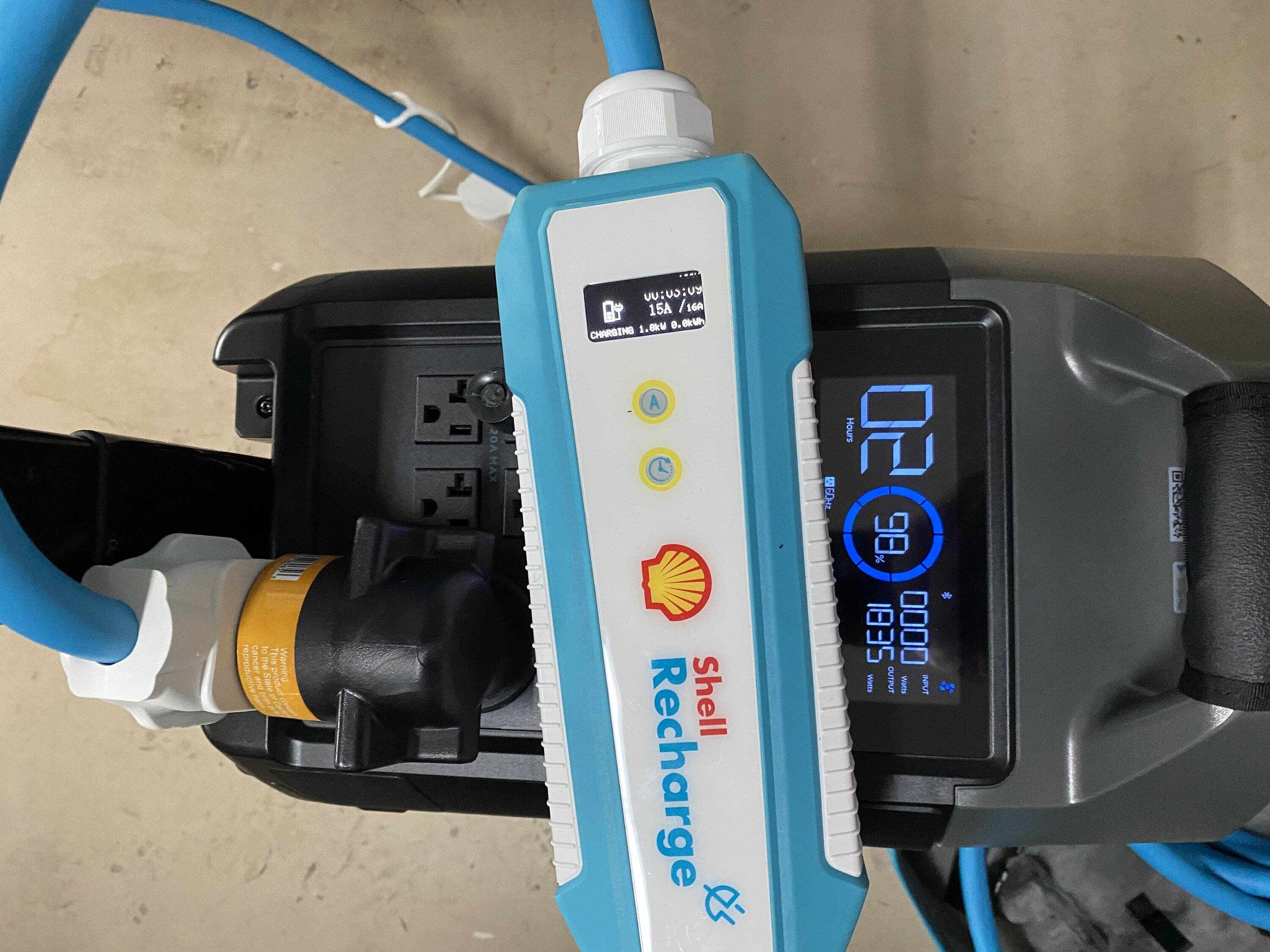

This is not necessarily the best use for this expensive battery, but it’s nice to know that it works as an emergency Jerry can for +8 miles range.

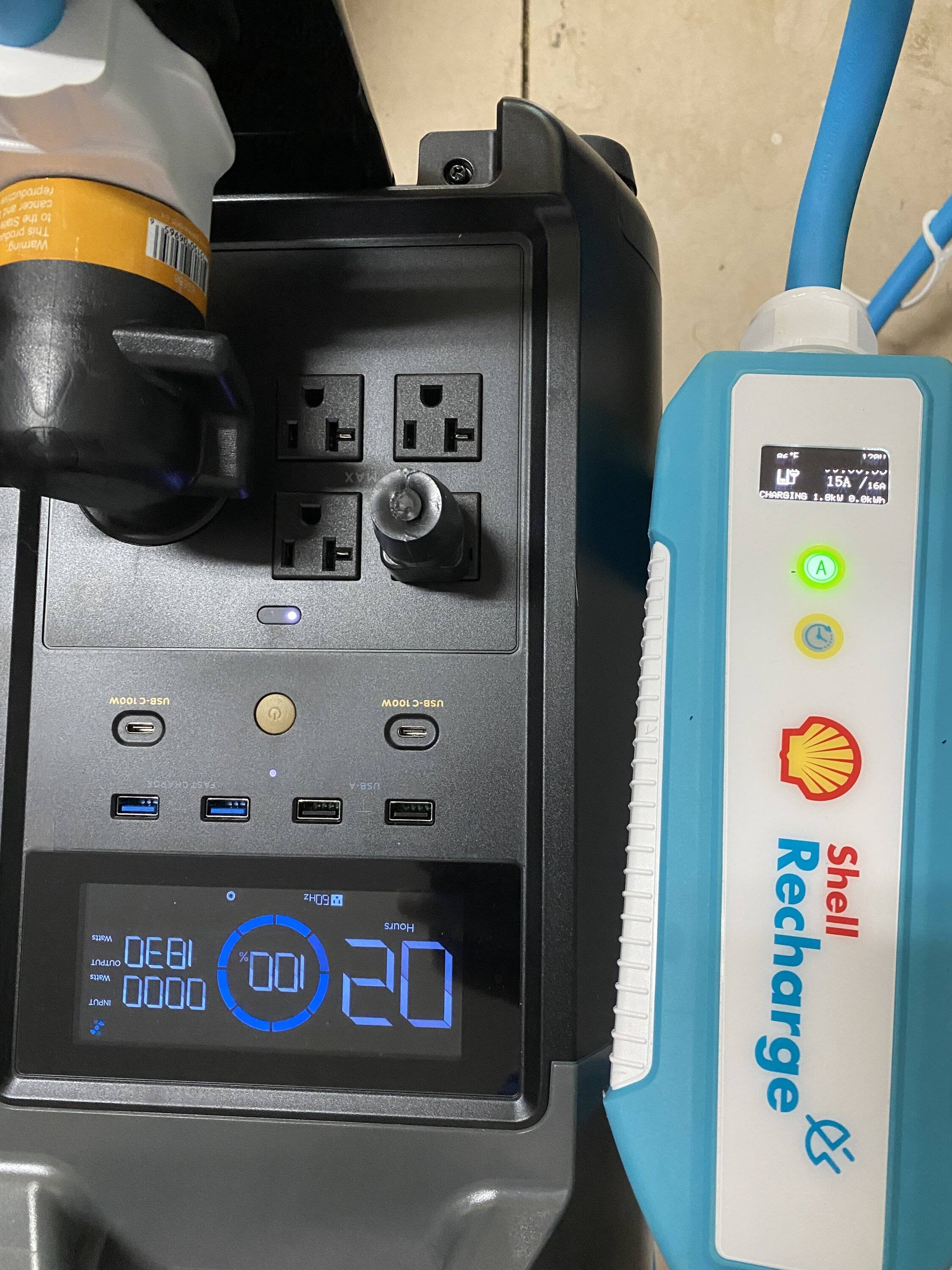

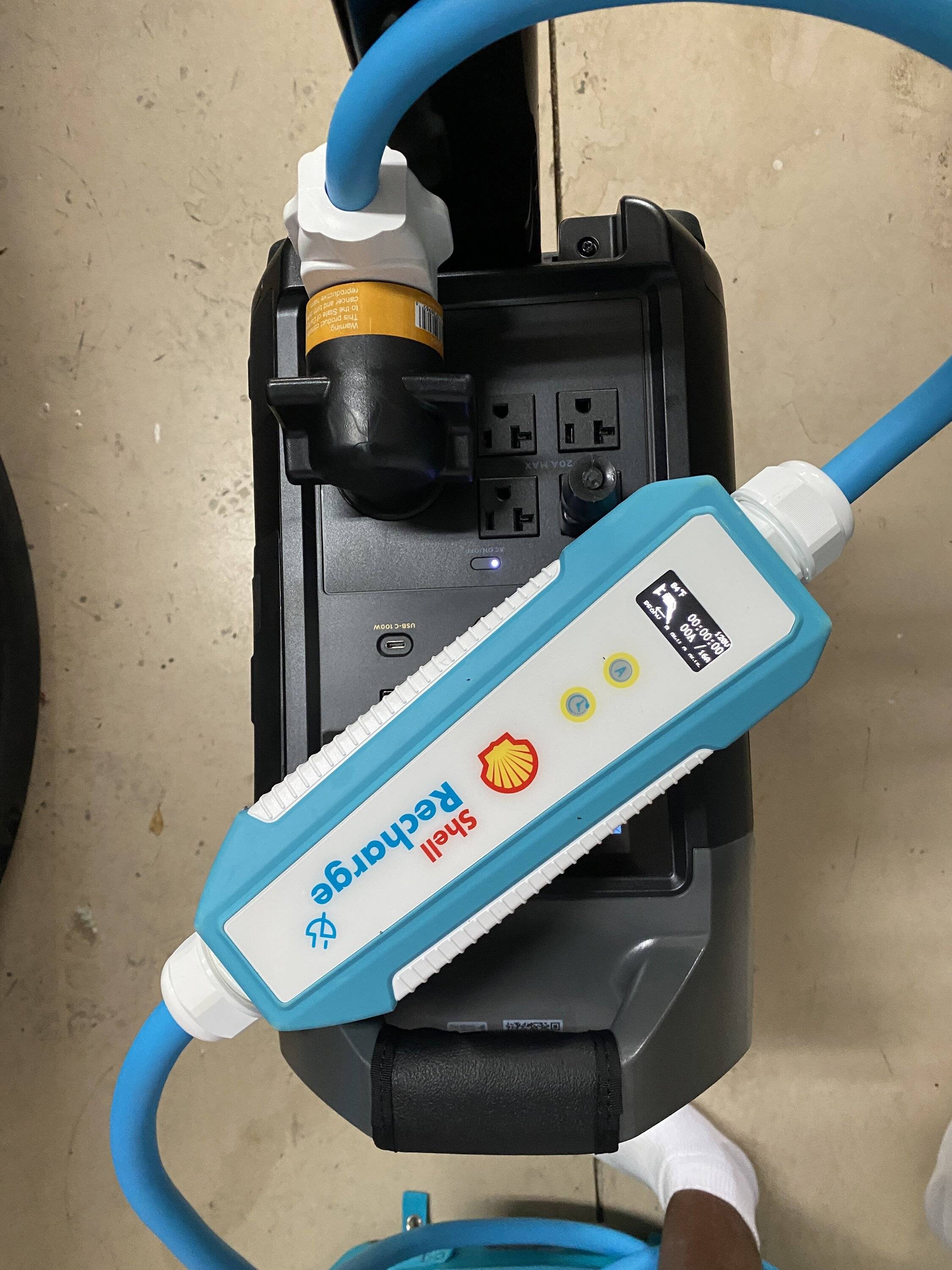

Battery - EcoFlow Delta Max Pro w/30 amp RV plug & adapter to NEMA 14-50. (This is optional. Its helpful but not absolutely necessary. You can use the standard 120v plug for charging)
Charger - Shell Recharge 40 amp version using NEMA plug. This is IMOP a pretty nice multi-volt charger. Charges both 240 and 120 volts simply by plugging in the included NEMA 5-15 adapter.
Grounding Plug in the battery - Southwire 44400 Neutral Ground Bonding Plug
Again, let’s not go bonkers on how this is not practical… However, a scenario could happen where you run out of power just short of the charger and need to phone a friend for EV road assistance. Otherwise, file it under fun facts :).

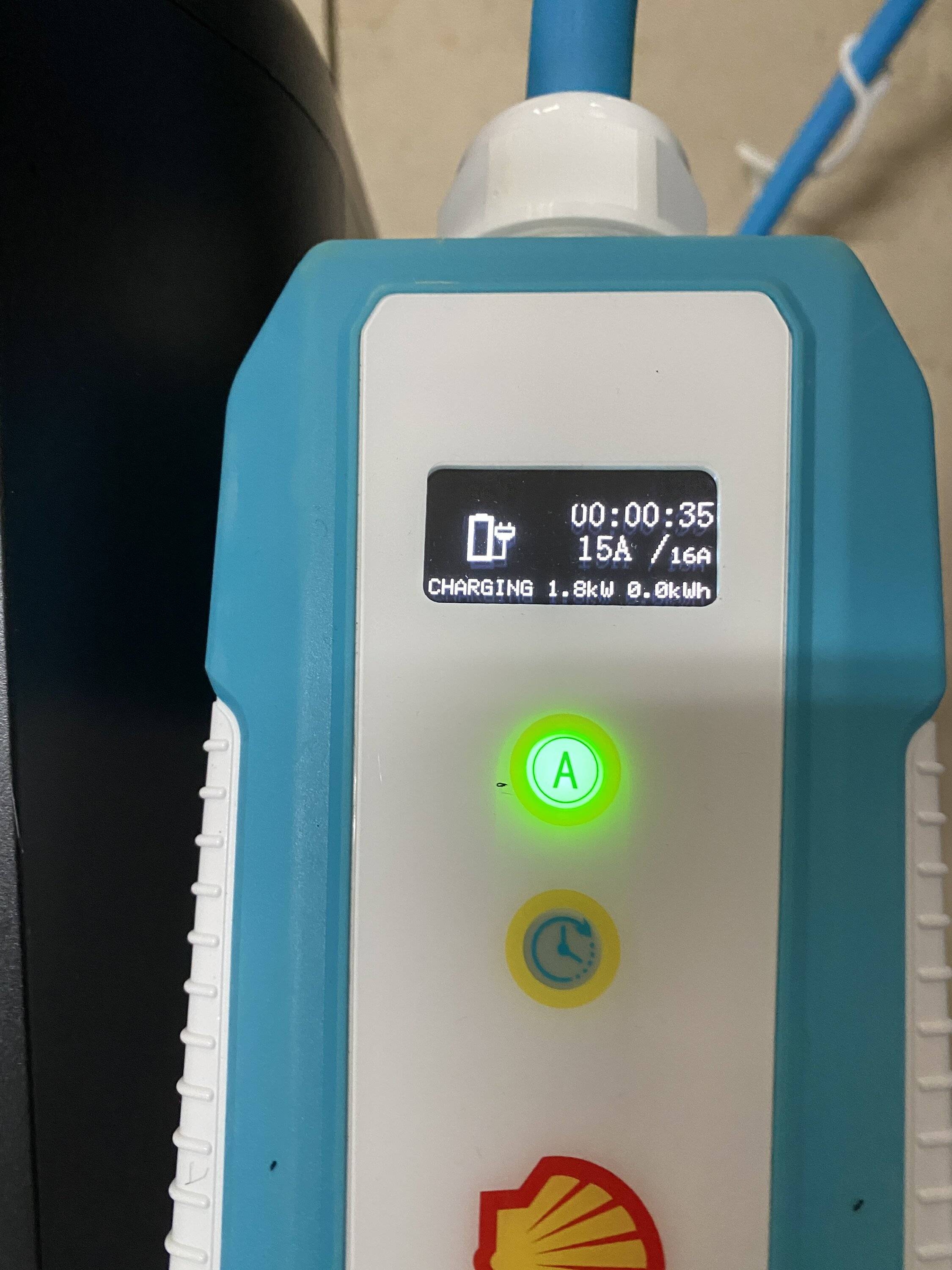

Can the EcoFlow only do 16A? I thought it's speced for 30A
Techwizard100
Techwizard100
Dec 14, 2020
160
163
Naples, Fl
www.ev1consulting.com
2024 Taycan GTS ST / 2025 Macan 4 EV
Yep, specd for 30 amp 125v when using the RV plug. I didn’t experiment further with the charger settings - defaults to 16A.
You need 2x EcoFlow to get full 240V/30 amps.
