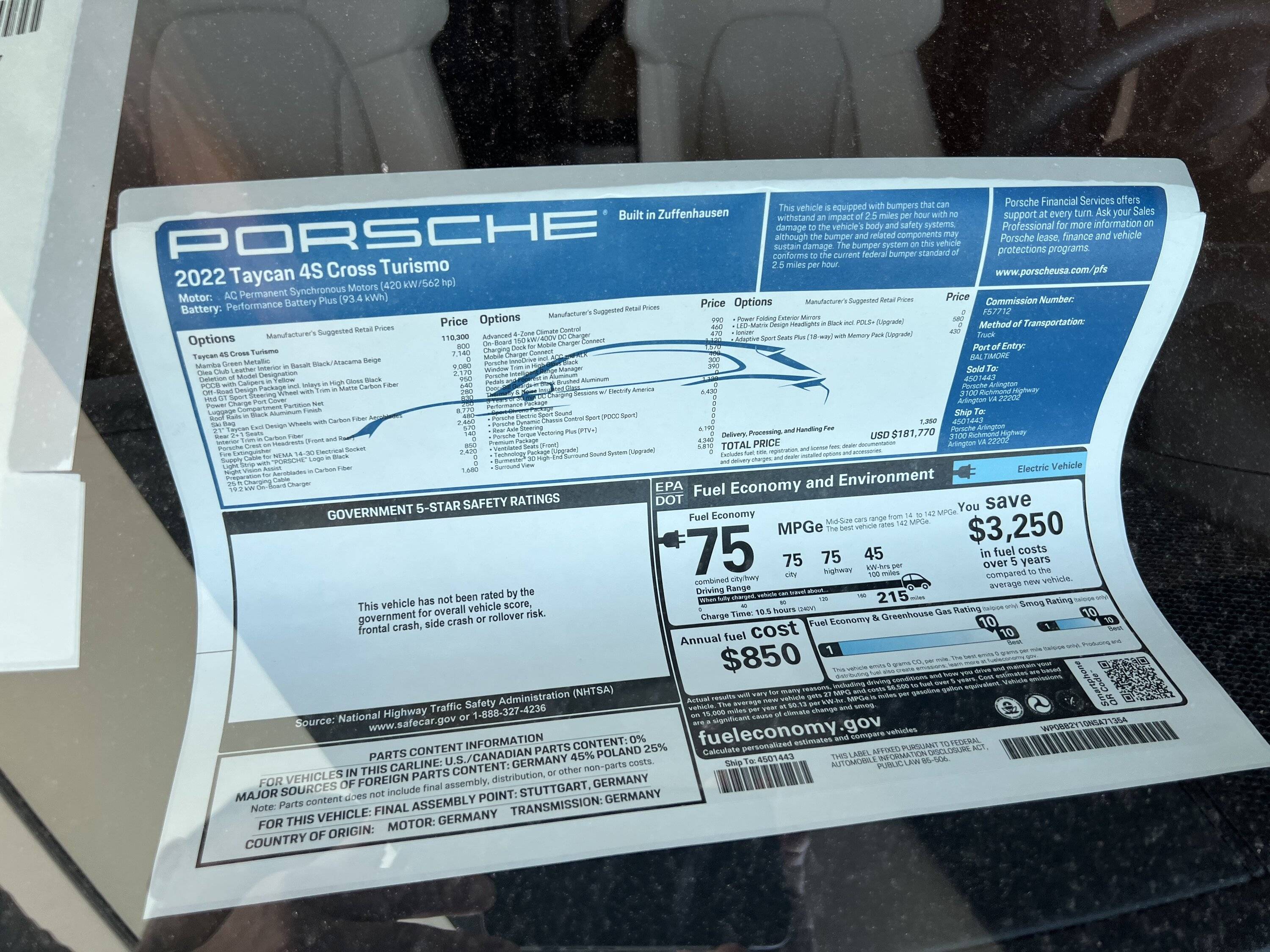

I agree with others that moving up to 4S is a wise choice.
Nothing is mandatory. If your budget constrains you with respect to options, know that this is a great car without any additional options. My personal priorities in relevant order would be (1) all suspension options, (2) all technology options, and (3) all comfort/luxury options.
RAS is fantastic. and I regret none of my options. Many people hate the Porsche chargers. I didn't know that before ordering. It works fine for me. Might be only thing I would not do again.
